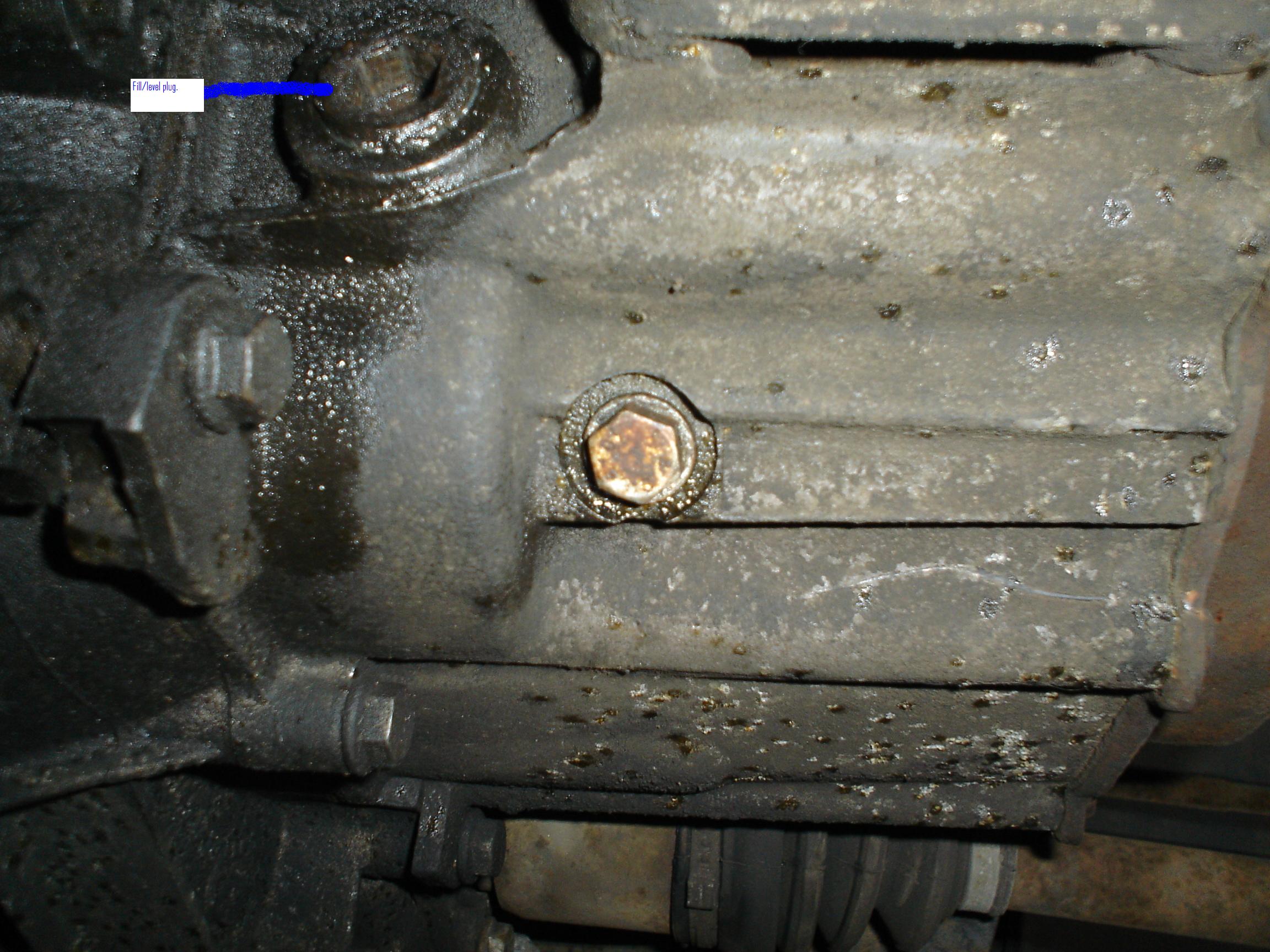

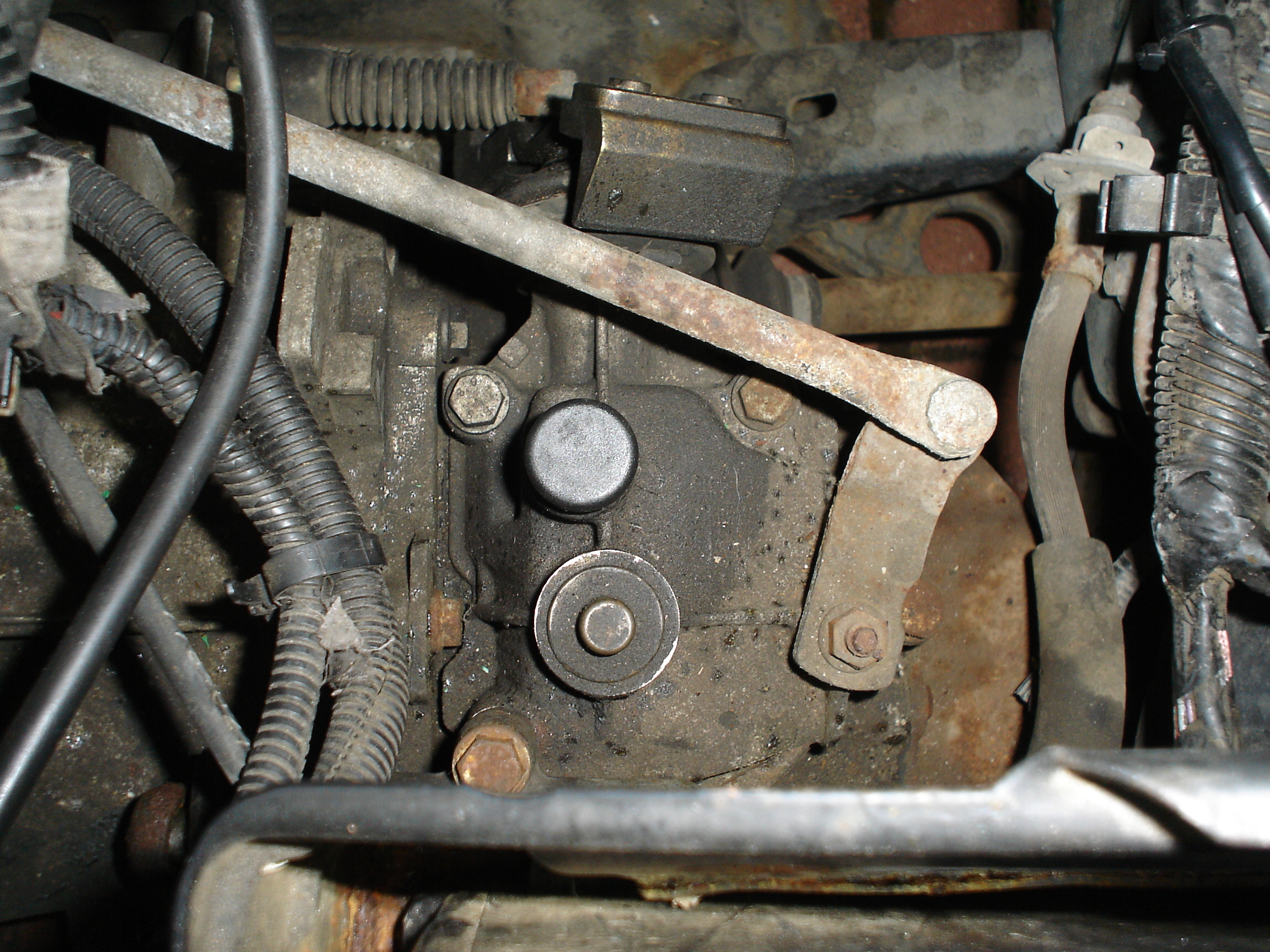

The one with the blue line is the filler hole and is the small rusty bolt the drain plug as that is all i can find on my gear box, 2nd pick what is the black cap for dose anything goin in there??
The Black Plastic Cap is the Gearbox Breather
The Filler Hole is on the Passenger Side - Facing the Fan - its literally right infront of you
The Drain Plug is on the passenger side - its sorta on a triangular corner

so its not that 14mm (i think) bolt its on the side faceing into the wheel artch, i had a llo eariler but couldent find it lol
Dunno what the 14mm Bolt is for - never removed it - dont wanna lol

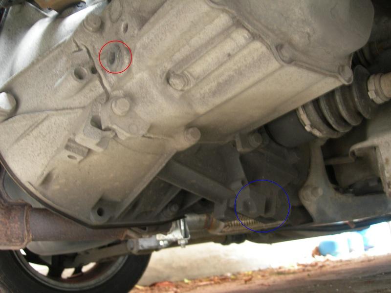

Red = Filler
Blue = Drain - its facing the passenger literally - its the lowest Point
