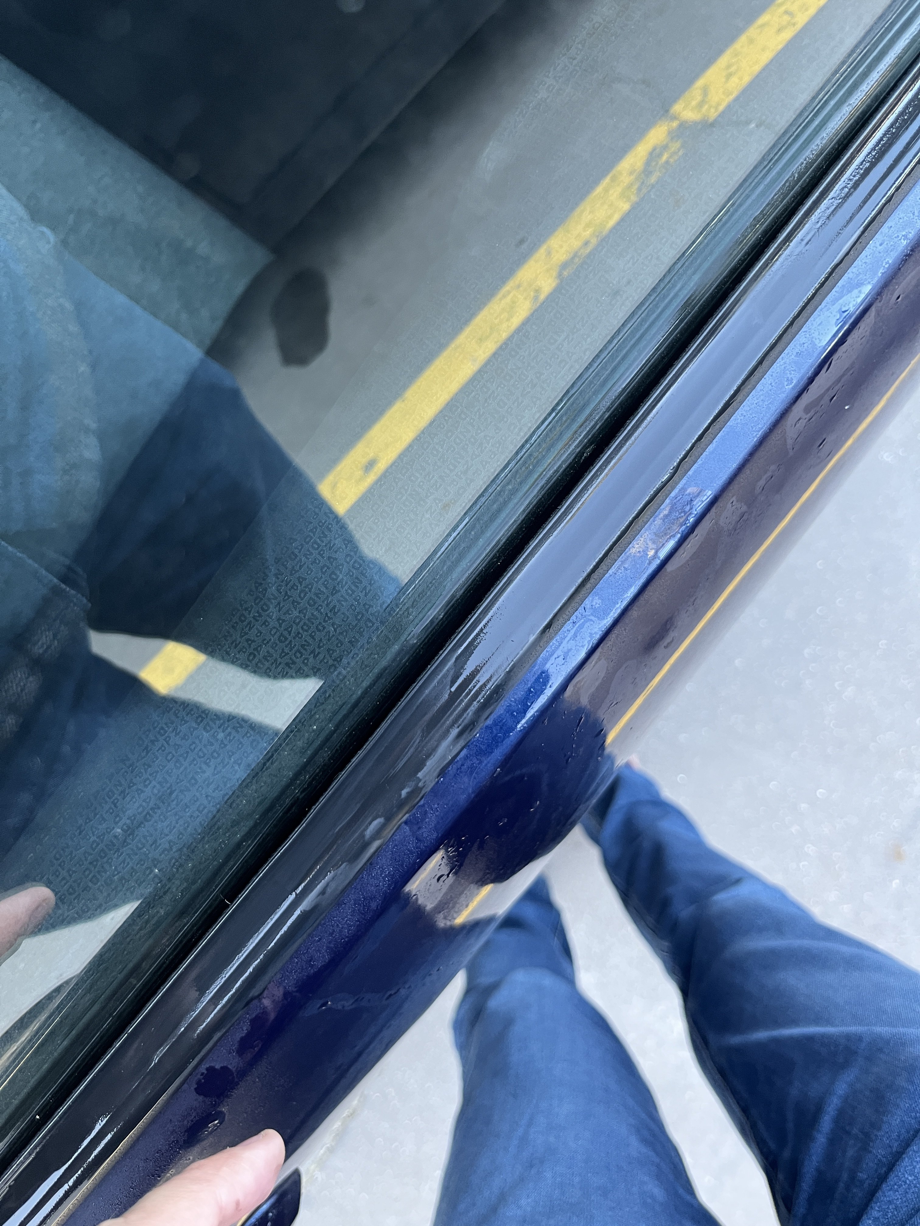

I purchased this 2021 Fiat Panda 1.2 few months ago and recently noticed this gap between the right rear passenger window and the bottom weather seal.
I’m not sure when this happened, however I’m pretty sure I would have noticed that at the time of purchase, but not 100% sure.
It looks like the rubber price is firmly attached to the metal, but the metal itself is bent outwards a little bit.
I don’t see any visible damages however and the door looks fine.
Is there anything than can be done, maybe some clip inside the door snapped or something like that? Tried to google this but looks like this is not a common issue.
Thank you!
I think the door has been bumped and not the best repair so its bowed. Ask a coachworks, It might ne a case of some gentle strightening or getting a second hand door in the same colour. Either way annoying but not too expensive. I would try palms of my hands and pushing firmly over the biggest area possible. This might do the trick Good luck.
Thank you for your reply. I’ve tried pushing with palms of my hands, but without success. Will try coachworks. Thank you.
