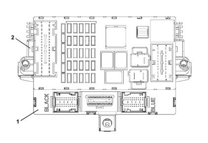

Does this connector exist? Just I don't want to have to remove the fuse box un-nessecarily. Has anyone any pics of the back of a Stilo Fusebox / body computer?
Well they are on top of one another but they are different and can be separated like this
Secondly, is there a 'plug' wiring loom going into the back of it that can only be access when removed does anyone know?
There are a few connectors in the back, one of them is blue
My DTE is showing a red wire at pin 34 but colours are often different just for fun and could easily be different for different engines and specs
