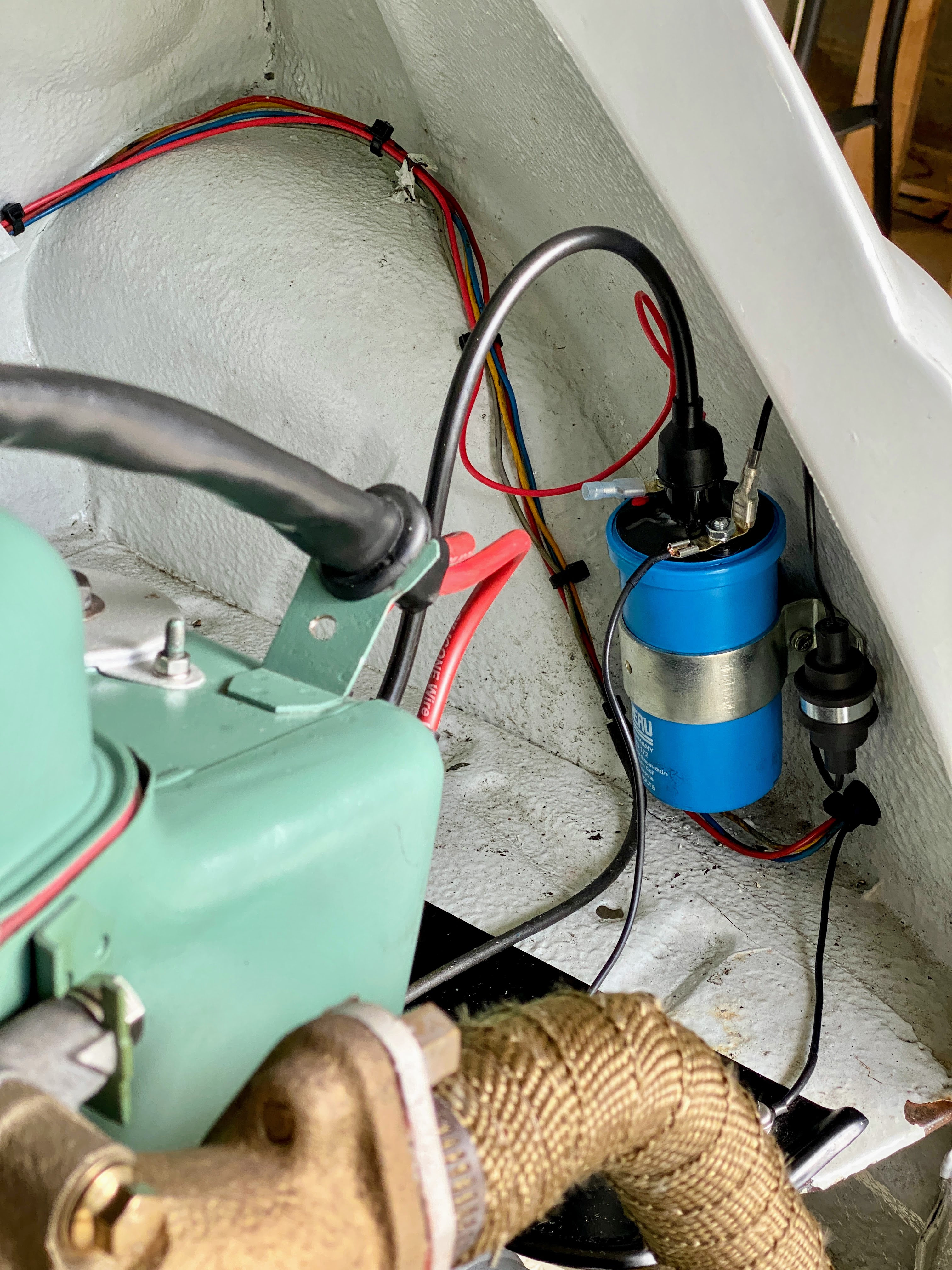

I would reccomend it as an 'up-grade'. As I have mentioned before, the advantage of the 'Swiftune' condenser is that it does not bolt onto the side of the distibutor---it has long 'feed'and 'earth' wires, enabling you to mount it up by the coil and out of the heat from the engine's "cooling" air, which can be very close (or even exceed) 100Deg C---the temperature where condensers start to wilt.
