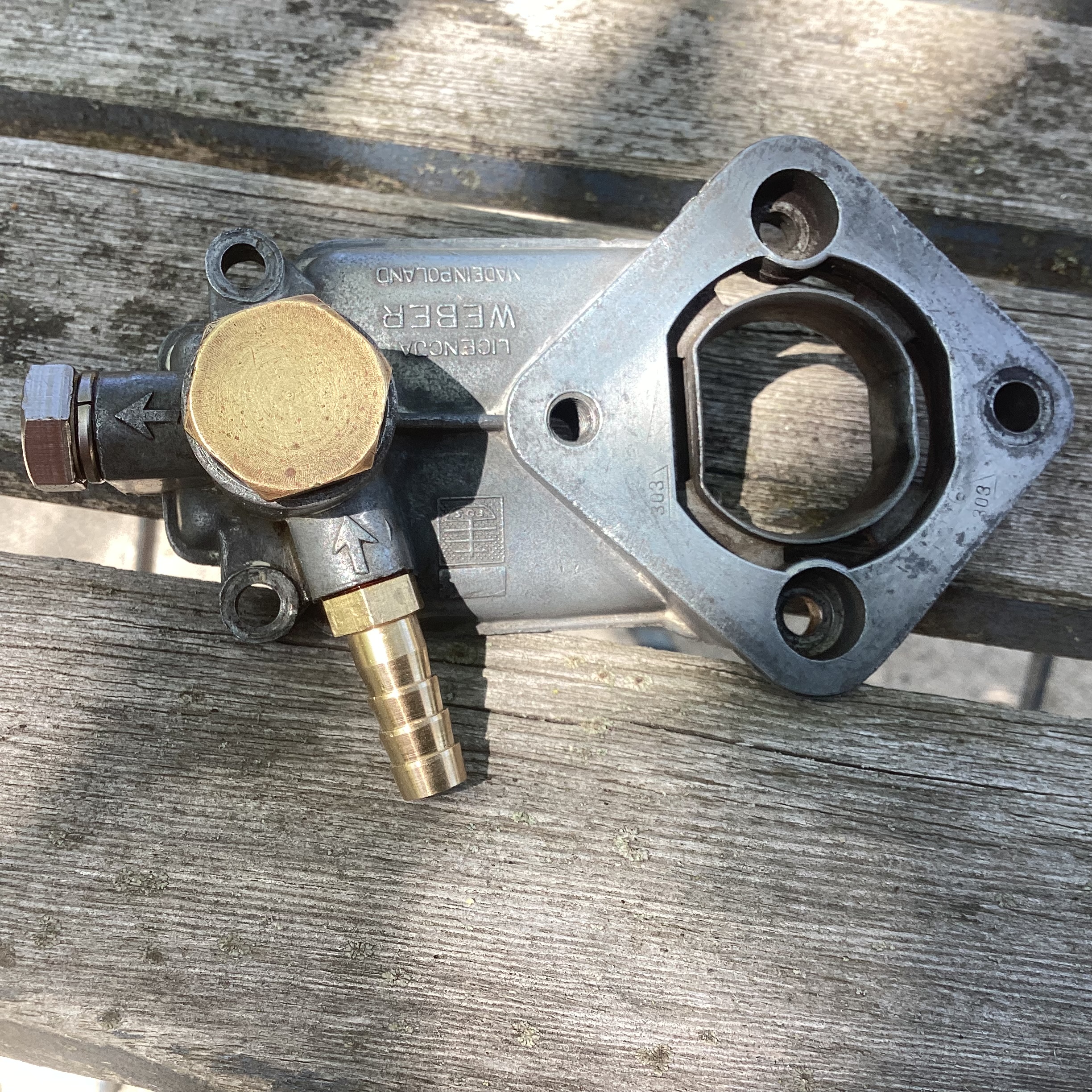

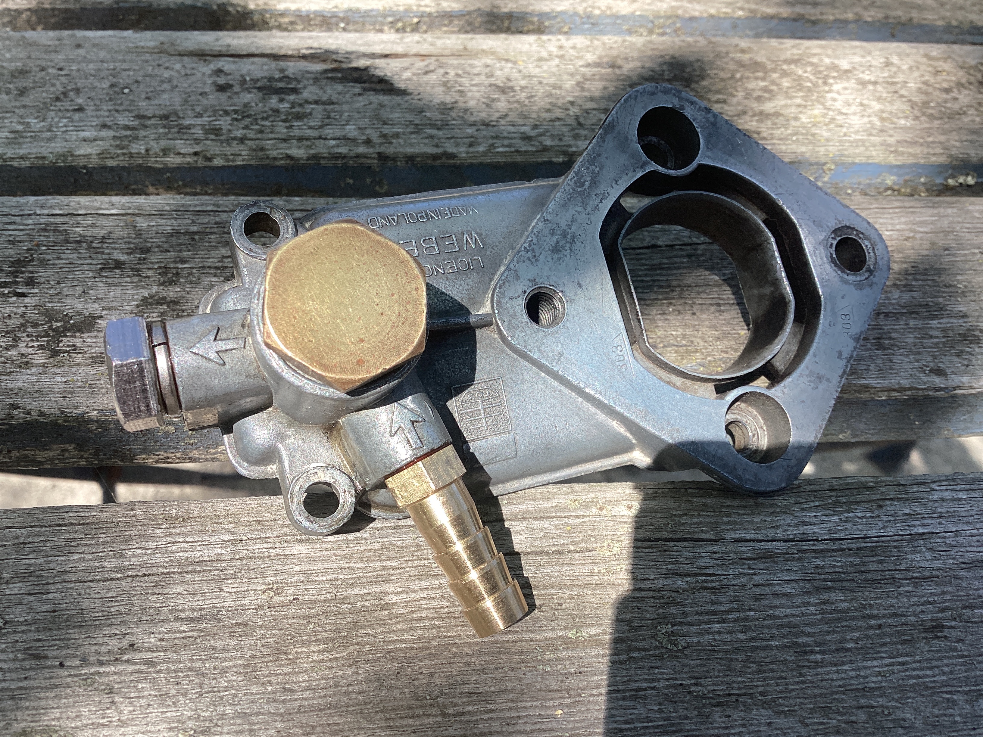

Hi David. I removed the original brass pipes because they can get loose (one was so easy to remove that it would have come out later), then I cut threath M8 and fitted after adding Loctite 542, a new hose barb in the inlet and a bolt in the return to block it.
