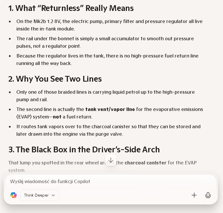

Also, don't use "AI", it is not better than us (actually the answers are based on the existing content, including...forums).
