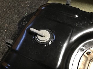

I finally got around to changing the gasket seals of the fuel vent valves in the fuel tank. This entailed removing the tank because access to the extremely tight fit valves in the tank does not allow for enough prising and pushing. I have hopefully attached a few photos.
Basically, use a sharp flexible blade to cut under and around the top of the valve seal. Using thin pincer nose pliers , pull this ct rubber away from the vent valve. Then by lubricating the remaining rubber gasket and manipulating the valve, also using a small flat screw driver push the remaining gasket into the tank. This finally allows the valve to be lifted out of the tank.
Lubricate the new gaskets and set them in the tank hole. Lubricate the rubber gasket again and push the valve into the gasket. I found it necessary to place a rag over the valve for comfort as I applied pressure pushing down and wiggling the valve with my weight . It was very tight.
Shake the tank to remove the old gasket.
Photos unfortunately are too big so will have to wait until I can figuer out how to reduce them in size.

Quick update having now replaced these vent gaskets, which hopefully might help others.... The advice shared by StevePD on getting access to and removal of fuel tank was priceless so thanks again, by the way.
The gaskets were absolute pigs to remove and did indeed need cutting and lubricating. We cut with one hand and held the gasket still with a pair of tiny mole grips so that it did not fall down inside the fuel tank. Then, after each cut, having made the gasket's seal weaker, some very gentle wiggling whilst lifting upwards ensued until the plastic valve came free. Be careful, the 'lips' of the valve are very tempting to grab hold of but they are quite brittle (fortunately for us didn't break any more than a tiny chip.
The instructions to replace the valve and new gasket were 1) put the new gasket into its position in the tank and then 2) push the valve back into position through the now seemingly much smaller hole (because the gasket is in it). Even with the break cleaner lubricant, this required so much twisting and downward pressure that the tank actually bent inwards a little. We stopped and pulled out the 'dent' and went back to the process of trying to push downwards and twist. Eventually the valve was re-seated but we had to use silicone as lubricant and warm up the gasket a little as the versions we bought from Barchettaparts (recommended in this thread) was simply too stiff for the break cleaner to make any difference.
On the plus side, this gasket and valve is seated so tightly that we're hopeful it's going to last a good while and deal with the petrol smell - which by the way is gone for now. Going on a longer drive tomorrow and have our fingers crossed.
