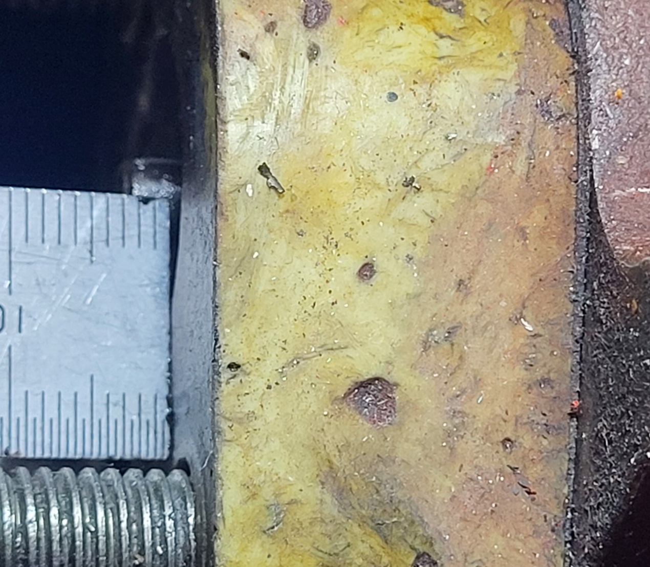

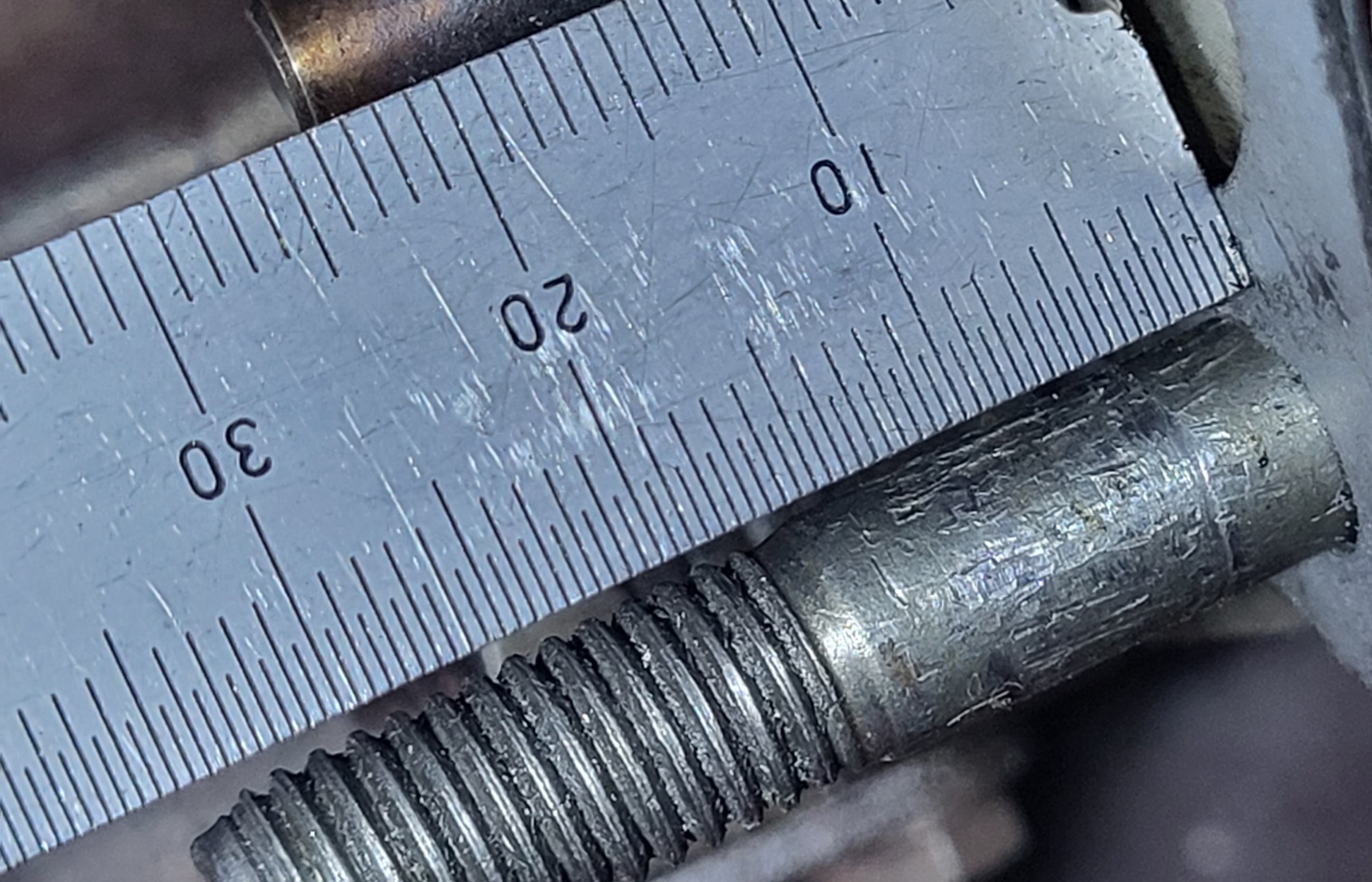

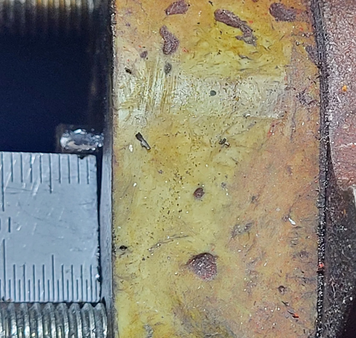

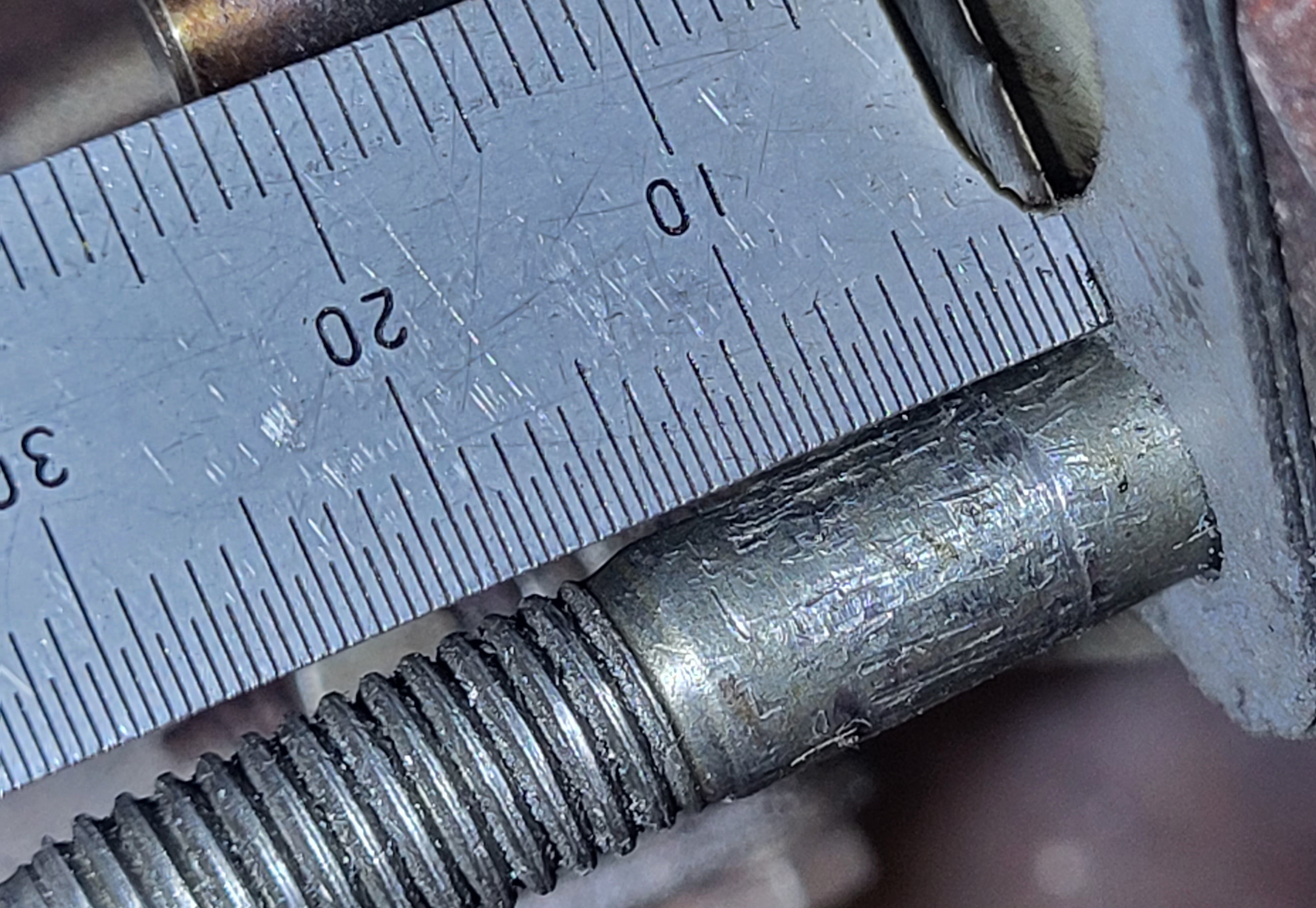

I have taken off my fuel pump in my long running task of sorting out my engine. I've found that the full stroke of the push rod is 1.5mm. I believe it should be 2.4mm. Is that for a 499cc engine not a 594?

Panic over. I took the pump off again, and the spacer, which let me get the ruler in straight. I'm content that the stroke is good.
