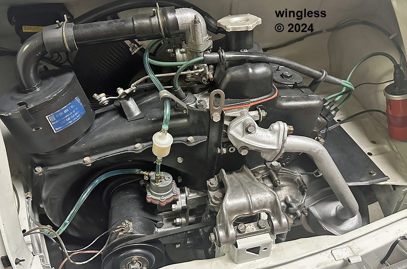

OT, my 1968 500L didn't have a fuel filter.
My initial thought was the location shown in your image until I read the generic preferred location is after the pump, so I placed that identical filter vertical, directly above the pump.
How is that location working for you?
Here is my fuel filter location.
Having a plastic fuel-filter over an electrical 'device' is NOT a good idea! Please remove it. Your car has 3 fuel filters "as built". 1 on the end of the tank-unit, 1 in the top of the fuel pump and finally, a small filter in the top of the carburettor. They do NOT need a 4th filter
Some would argue that that position doesn't protect the fuel pump valves, although there is a usually a fine gauze filter in fuel pumps and also from new the vehicles didn't have a paper element fuel filter in the system any way.
As @hobbler mentions also, not ideal from a fire risk above an electrical device.
fuel-pump-primer-mk2-jpg.439376
The fuel filter was in place next to the tank when I bought the car. I have only done 174 miles so far but it has not been a concern. When the car was new it did not have this extra fuel filter but then it did not have 50 years of rust and other detritus lurking in the tank so I think the filter could help to protect the fuel pump and it is in sight so easier to check and replace than the other standard filters.
In a risk analysis of the fuel filter after the pump the chance of a failure is still quite low even with a plastic filter in a hot environment with serious vibrations, but the effect of the failure could be very catastrophic as situated next to electrical equipment as an ignition source. In conclusion, if a filter is fitted then next to the tank is a far better bet than in the engine bay.
