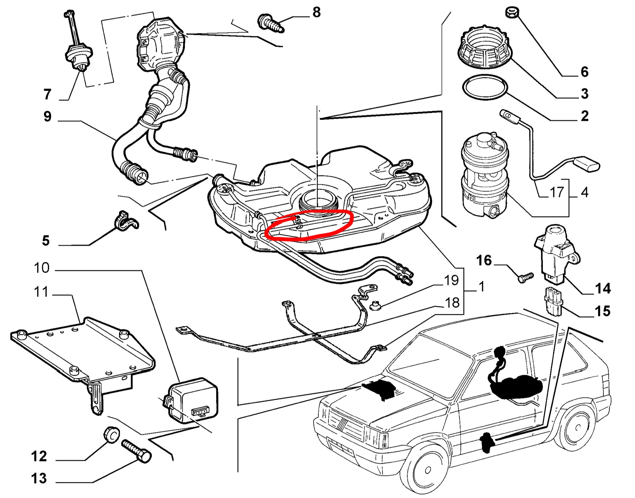

Comparing my earlier photo to this diagram I found, is the circled bit the likely culprit? If so, how do I replace that hose only?

Nope, these seem to be electrical wires. I’ve had the car running, been crawling around underneath it and can’t see any sign of leaks. Must just be when the car is filled. Any suggestions why it might be leaking when filled up, but not while running?

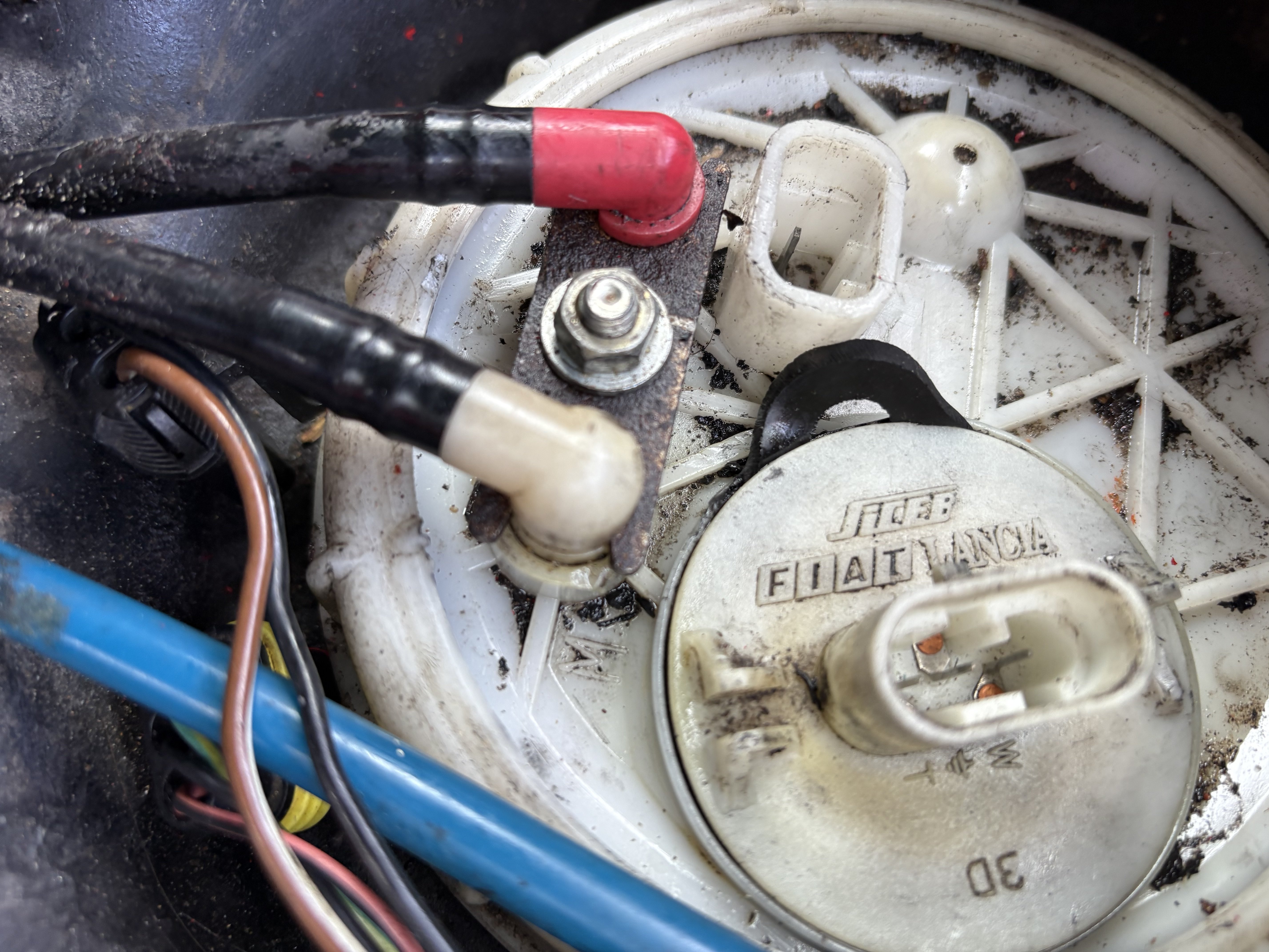

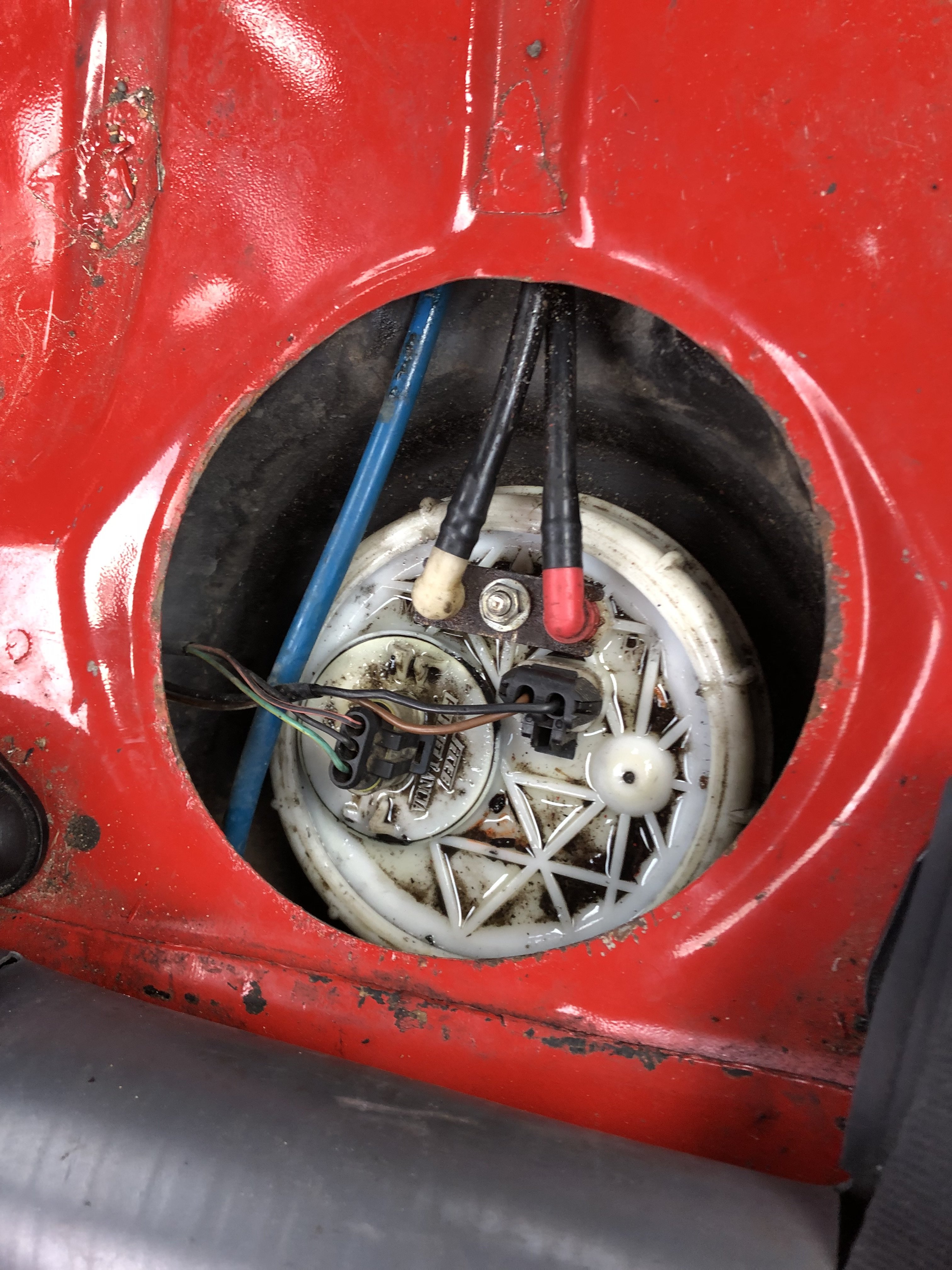

Late update; finally got round to taking the rear seats out, opened the access flap, and filled up while looking in the back window to see it there were any leaks. Sure enough, the seal around the fuel sender is completely gone and a torrent of fuel came out the top before the pump clicked off.
I took the sender out and the seal was basically jelly. New seal ordered, hopefully that cures it.

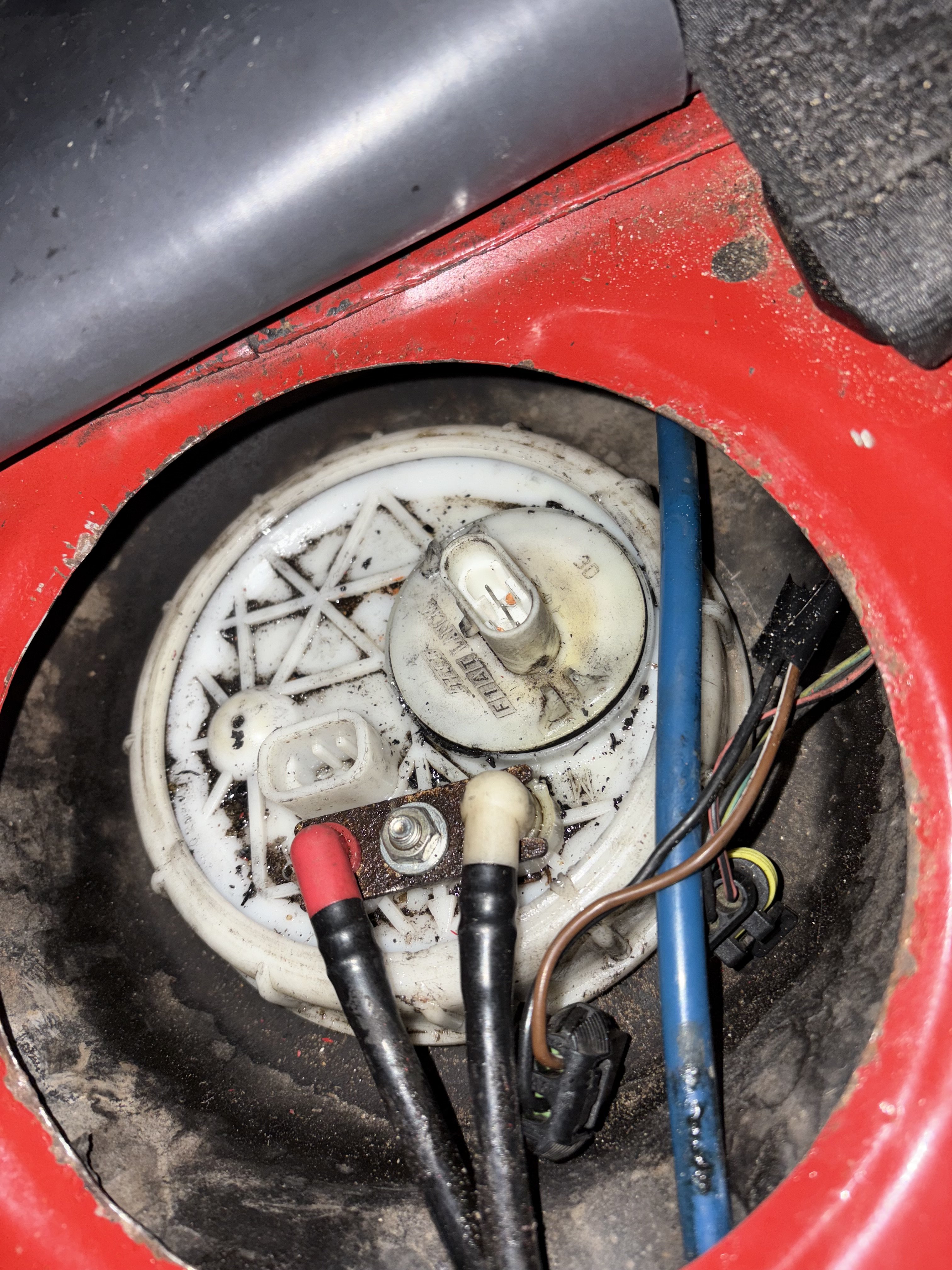

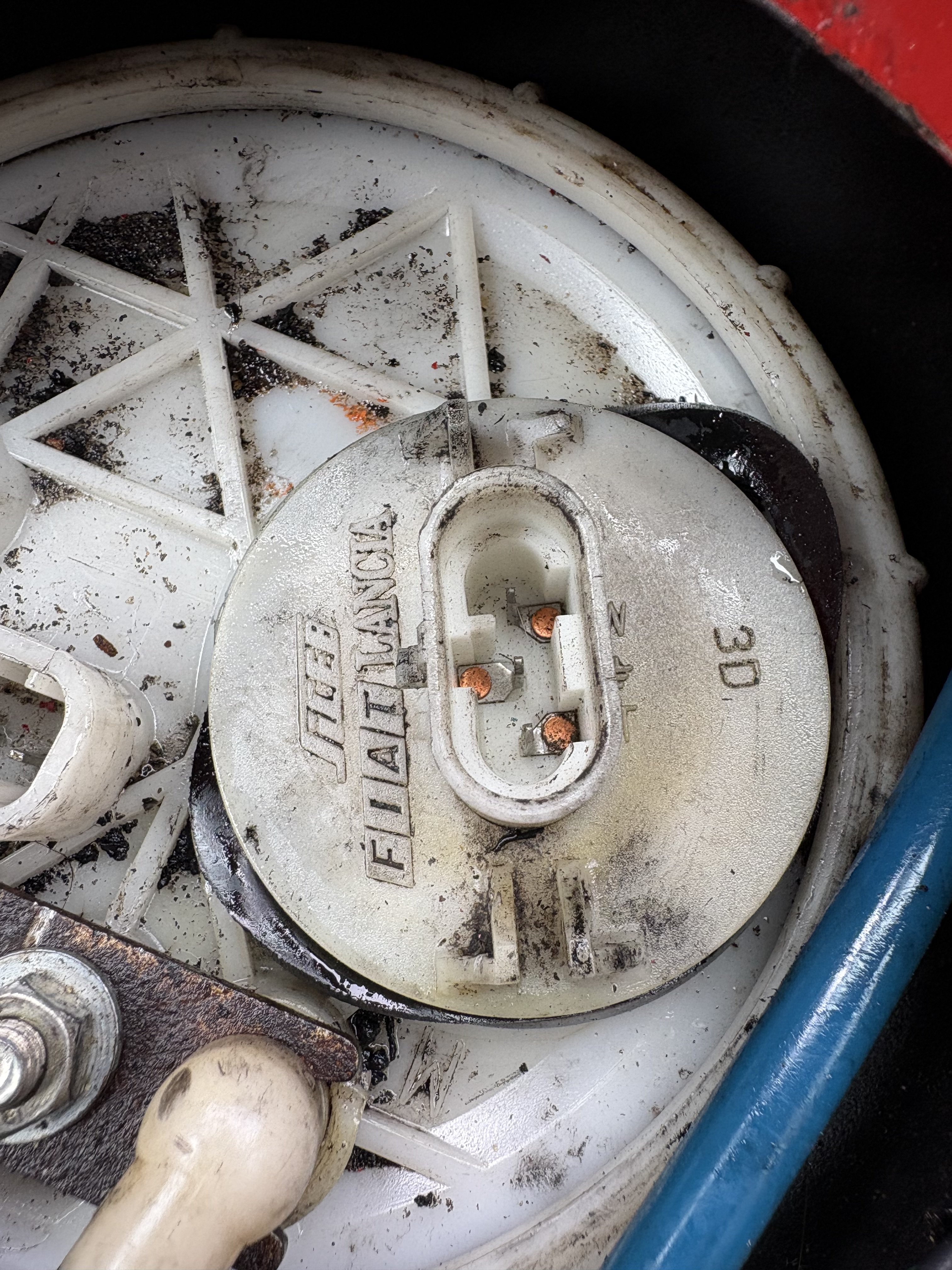

I’ve got a new seal, but now I can’t get the sender to sit properly! Is it as simple as putting the sender in and rotating clockwise a bit?
First photo is before I touched anything. The FIAT logo on the sender is in line with the ‘east-west’ axis. The second photo is with the new seal, taken upside down. I cant get it turn any further clockwise so that the logo lines up again. I think this is just because the new seal makes everything much tighter, but I don’t want to break any of the little plastic bits which I’m putting all my weight against. Any tips on how to get this to rotate a bit more?

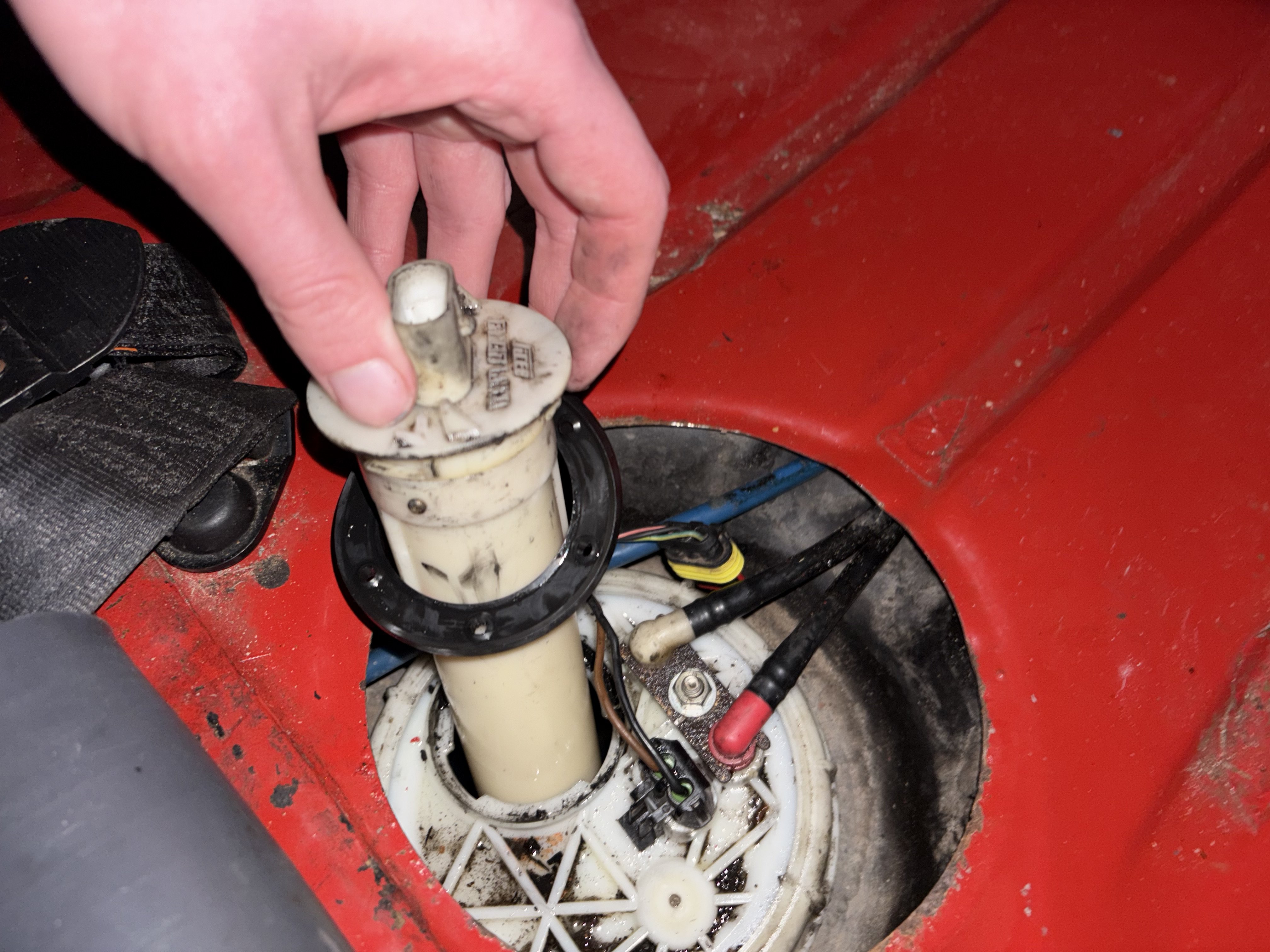

Well, I had a go at oiling the seal just now. Annoyingly it seems to have grown overnight. It’s no longer tightly attached to the fuel sender, and when placed on top of the tank there’s a good amount of excess poking out the side. Are these seals designed to expand when in contact with fuel?
The oil didn’t make a difference to my ability to turn the sender but I have a bigger issue now.

Remove , and check size and shape is still original, check both mating surfaces for smoothness
Yesterday the new seal fit perfectly around the sender, today it’s stretched out. I cleaned up both surfaces yesterday and didn’t have any luck.
