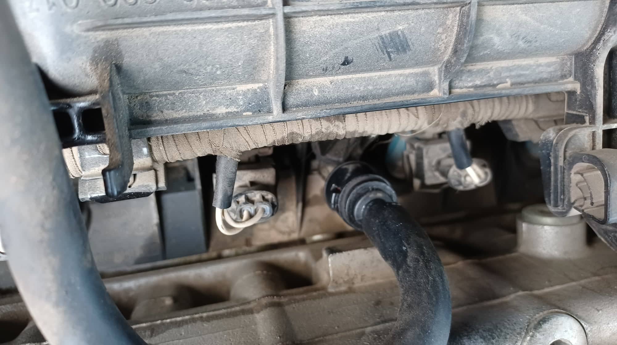

Recently I started to smell fuel but I couldn't locate the leak. Today while driving, the odor became even worse to a point I thought I was loosing a lot of fuel.
I decided since I checked everything in previous days, to remove the air filter box and have a look and voila! Fuel is leaking on the fuel supply pipe quick release connector, at a rate of 1 drop per second which is a catastrophe waiting to happen.
I was trying to find some info on replacing the quick-release connector or the rubber seals inside it but I found nothing.
Is it replaceable-repairable or should I look into finding a fuel rail? And if it is replaceable, any clue on the part number I have to order?

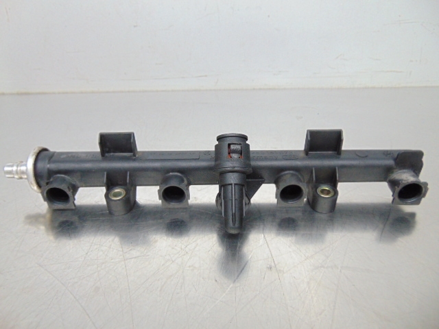

Part number of the fuel rail assembly is Bosch 0280151073.
The only thing that comes as a perfect replacement in my case is this (first photo) since I don't need injectors, but I prefer to get a new part.
Thank you in advance
