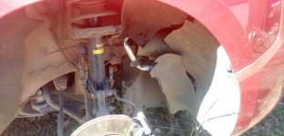

On July 28 my wife had an accident with the car when she arrived home and drove straight into a boom. (see attached photographs). The boom penetrated the bumper and went straight through the cowling, lodging the point in between the right front wheel and the strut.
The car displayed an emergency stop message on the instrument panel (she could unfortunately not remember the message)
The physical damage seems to have been limited to a hole in the bumper a shredded plastic fender inner and the complete destruction of the air conditioning pipe.
