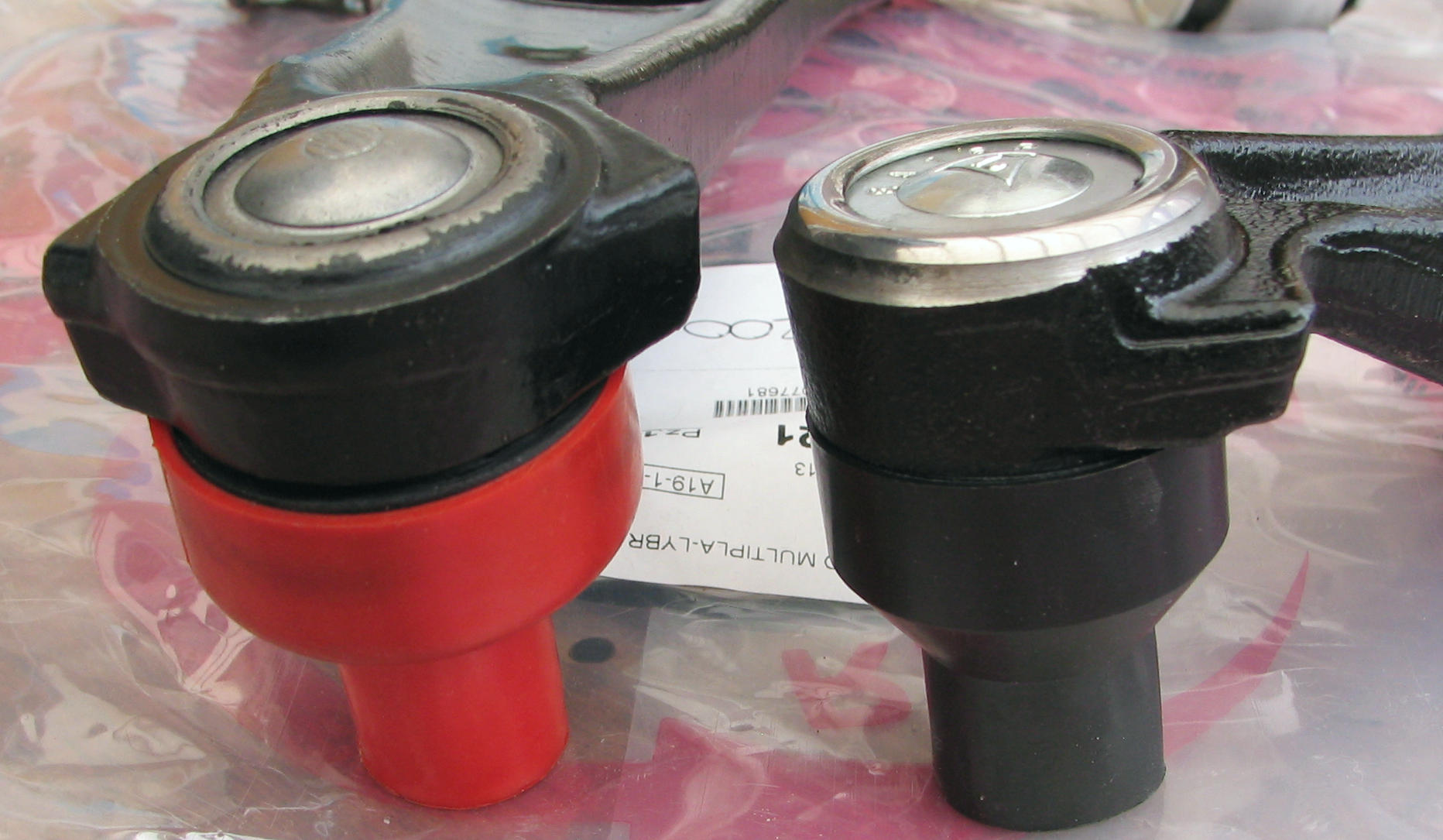

Next - the ever popular offering from Birth, makers of OEM parts for many Italian car companys and a safe 'middle of the road' (to avoid the potholes?) choice. If you buy a wishbone from Shop4Parts, these are what they'll send you. They look like this (top of picture):
Then bottom of picture:
To be honest, I'm not impressed. Whatever tooling they use to make them looks like it should have been thrown in the skip long ago. They are also monstrously heavy - 4,200g. They are thick, not very well finished and just look, well, poo. The bushes and ball joint look ok and feel firm enough, but if you value keeping unsprung weight down, these aren't for you. The ball joint is stamped with the Birth trademark. Country of manufacture: Italy

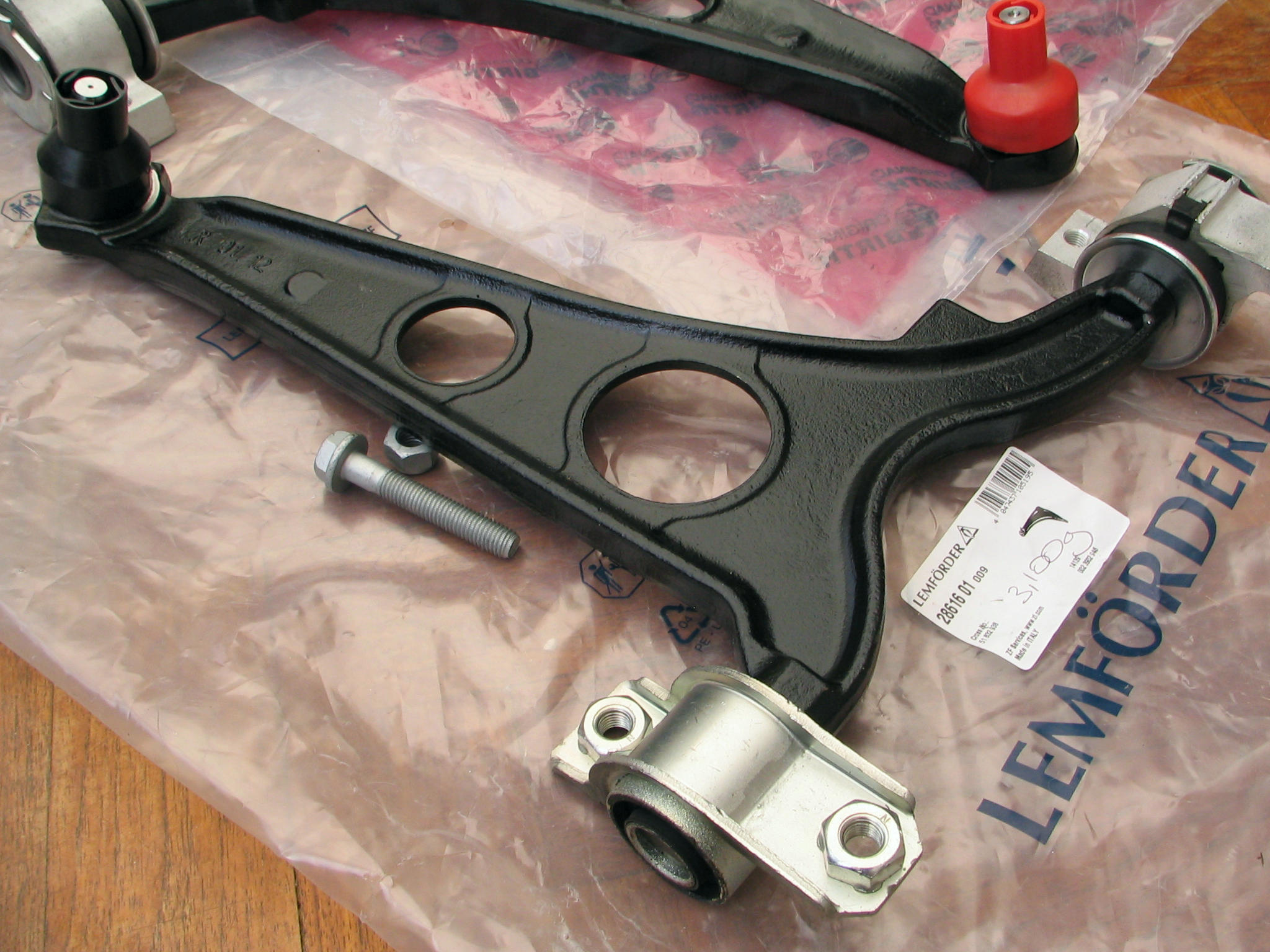

Step forward contender No.2: Lemforder (it's the one in the bottom of the first picture). The minute you pick these up, you can tell that they are a quality item. Reasonable paint finish, nice, crisp (slim) arm and decent fit and finish of the bushes (to be fair, the Birth ones aren't too bad in this respect either). The fitting of the ball joint looks especially trick as it appears to have been machined after it's been fitted to the arm, so you can't tell where one finishes and the other begins. The ball joint is stamped with the Lemforder trademark, but that's the only place it's present. Weight: 3,100g, beating even the Fiat part by nearly 1/2 a pound and making the Birth one look like a lardy thing. They also come with a new pinch bolt and nut for the ball joint, which is a nice touch. Detail pics:
Country of manufacture for this fine piece of German engineering? Italy.

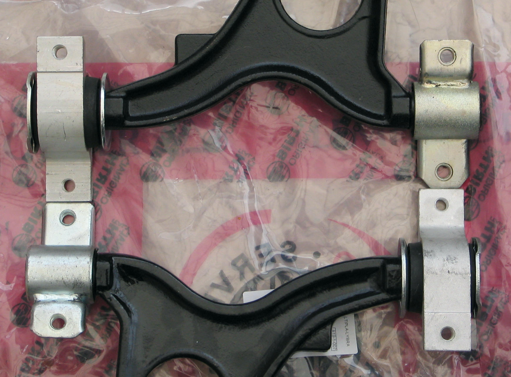

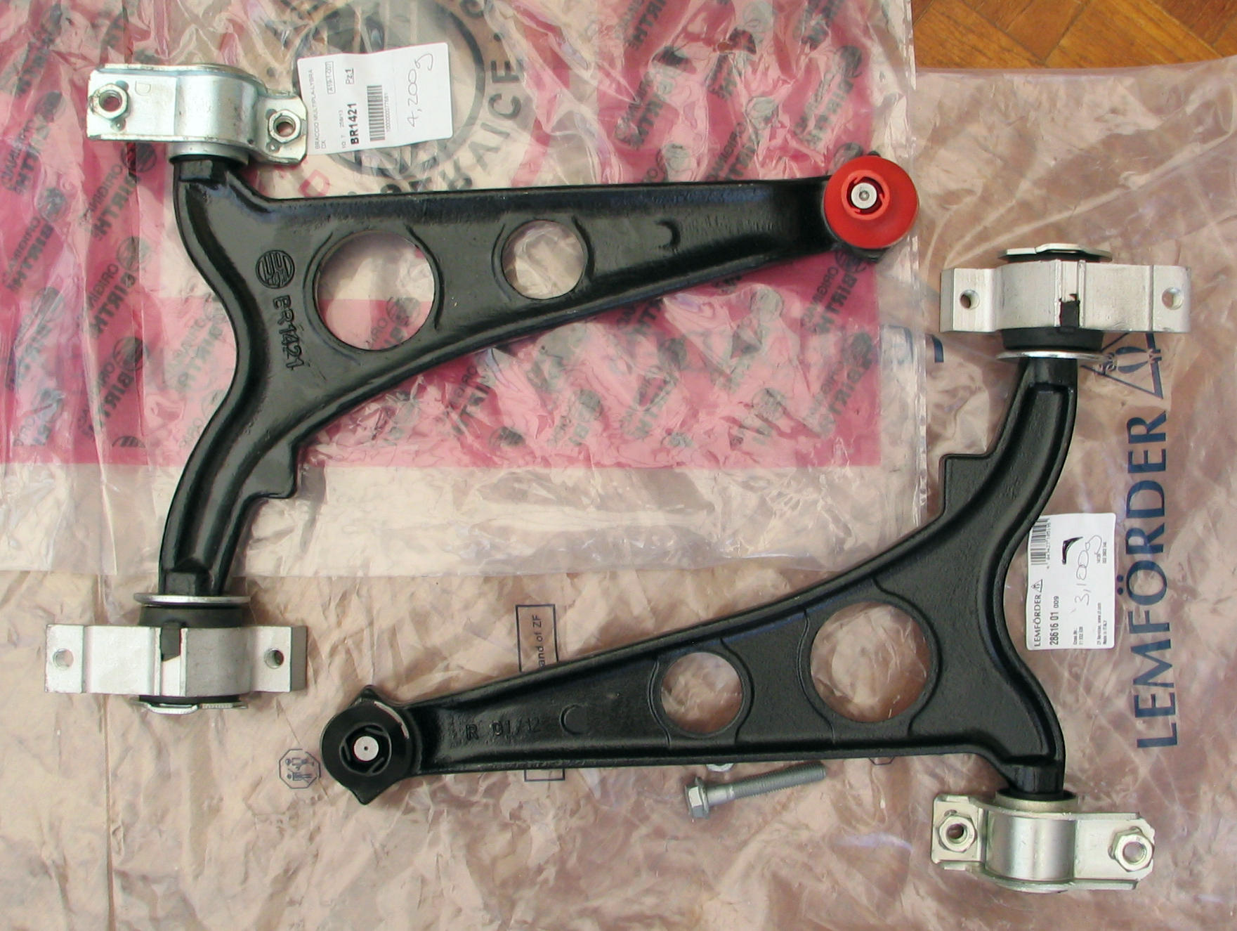

(Wishbone_Lemforder&Birth_01)
(Wishbone_Lemforder&Birth_02)
(Wishbone_Birth_01)

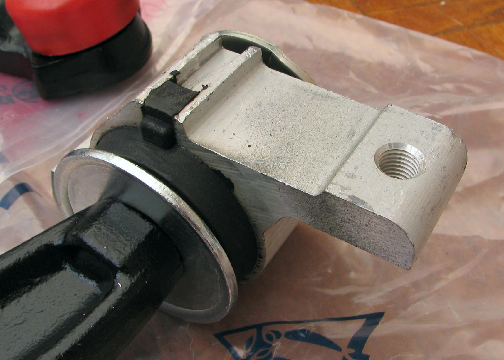

Step forward contender No.2: Lemforder (it's the one in the bottom of the first picture). The minute you pick these up, you can tell that they are a quality item. Reasonable paint finish, nice, crisp (slim) arm and decent fit and finish of the bushes (to be fair, the Birth ones aren't too bad in this respect either). The fitting of the ball joint looks especially trick (on the right of the 3dr photo) as it appears to have been machined after it's been fitted to the arm, so you can't tell where one finishes and the other begins. The ball joint is stamped with the Lemforder trademark, but that's the only place it's present. Weight: 3,100g, beating even the Fiat part by nearly 1/2 a pound and making the Birth one look like a lardy thing. They also come with a new pinch bolt and nut for the ball joint, which is a nice touch. Detail pics:
(Wishbone_Lemforder_01)
(Wishbone_Lemforder_02)
(Wishbone_Lemforder&Birth_04)

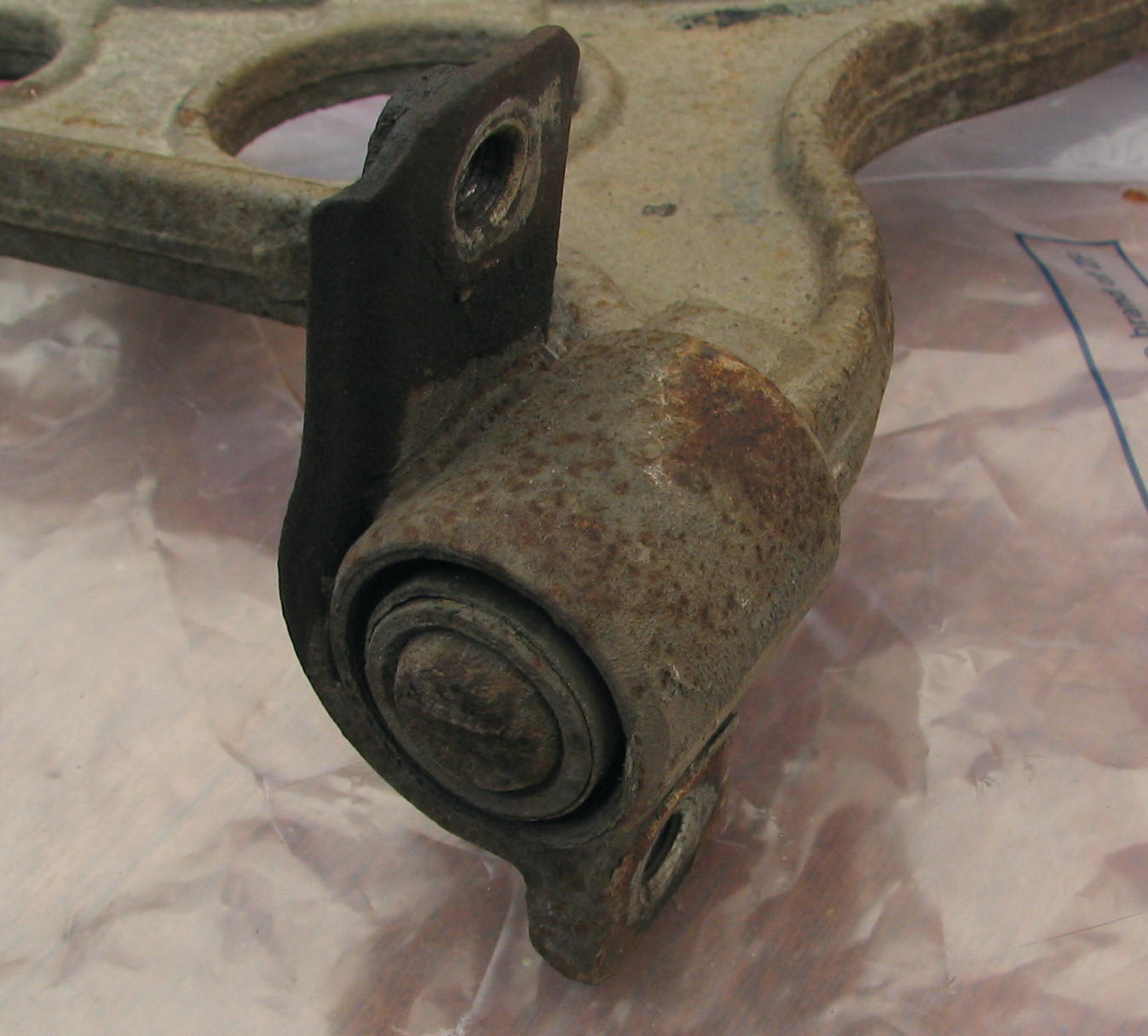

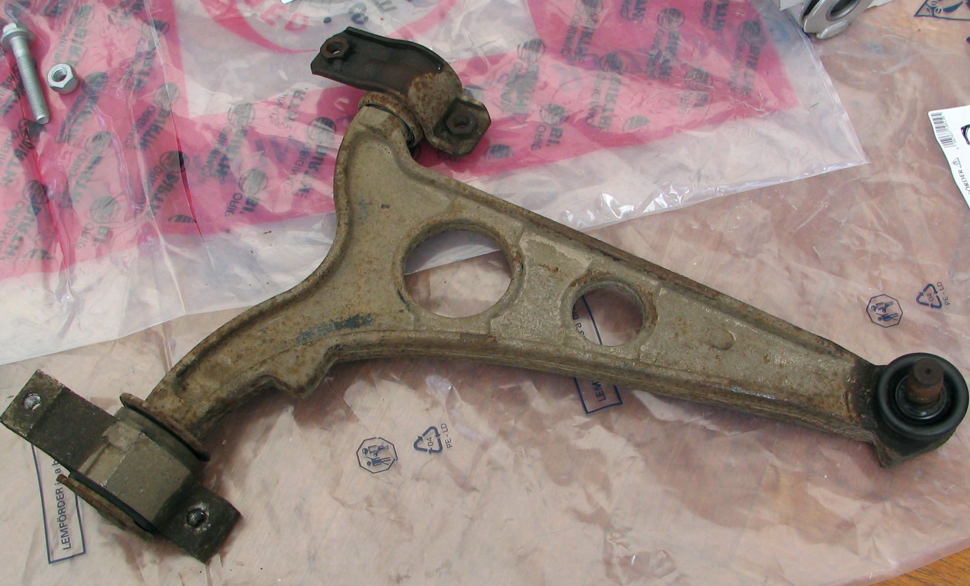

Lastly, we have the outgoing contender as purchased form ziggy A2Z on ebay a couple of years ago and gracious provider of an MOT fail 3 months ago (one ball joint and two bushes with excessive play, after clocking up about 16k miles). I have to confess that I spent quite a long time cleaning flash metal of the edges of these when I got them, especially inside the big round holes in their middles and down one edge. This was followed up with a couple of coats of chassis enamel when they were new, before I fitted them, so what you see here (apart from an MOT fail) isn't entirely representative of what this ebay purveyor of fine replacement parts will send you. You may detect that I'm not entirely convinced by the quality of this places offerings. The fact is, I bought quite a pile of parts from them for my Multi when I did all that work a couple of years ago, and these wishbones are the last of them to remain on the car. Be warned: Buy Cheap, Buy Twice; or Buy Cheap Once, Sell Quick.
There's no makers mark anywhere on these and I recall the packaging they originally came in was anonymous. I'm not sure of country of origin. Weight: 3,770g. Pictures:

Of course, none of this guarantees longevity in service (certainly not for the A2Z ones). Time will tell if the Lemforders fair any better. The Birth ones will go back in their bags, perhaps for good.

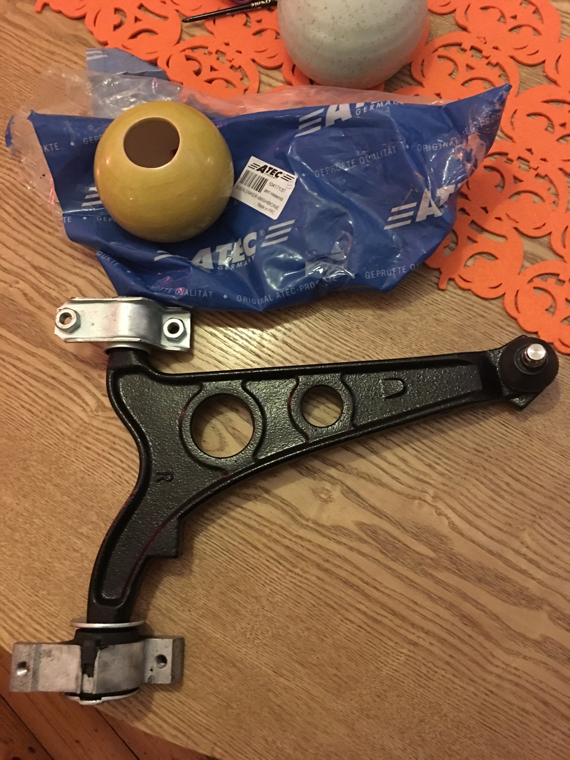

ATEC is the name of my latest bones. 3.8 kg, (apparently from Germany but says made in PRC)
Hole centres are exactly 270mm and they feel overall better quality than previous installs. Time will tell but I've a feeling these will be the last as I can't afford insurance on this car for much longer :(
I'll install tomorrow. (I've 1 In already and it seems fine so far)
Marty
Installed.. went in v easy in fairness.
Holes lined up perfect which is a major help.
A trick I have learned installing these is not to jack the car up too high. In fact lowering it onto an axel stand lower than the car would normally sit puts less pressure on the suspension through the rollbar and allows movement of the hub more easily onto the balljoint once wishbone is in place.
Pic attached of APEC wishbone 3.8kg.
