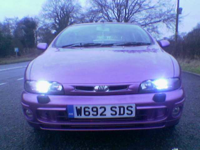

Mine was from Parts Gateway, wasn't paying brand new prices :( Hope you think my bumper is sexy, even with washers (which I didn't want either but wasn't faffing about/ forking out so they're there) :p

Helz your brava is HOT! :worship:

You have next to no chance of getting a gold one, leave the colour out of the description and get it sprayed yourself (you don't think they supplied me with a lambo mauve one :confused:) :)
