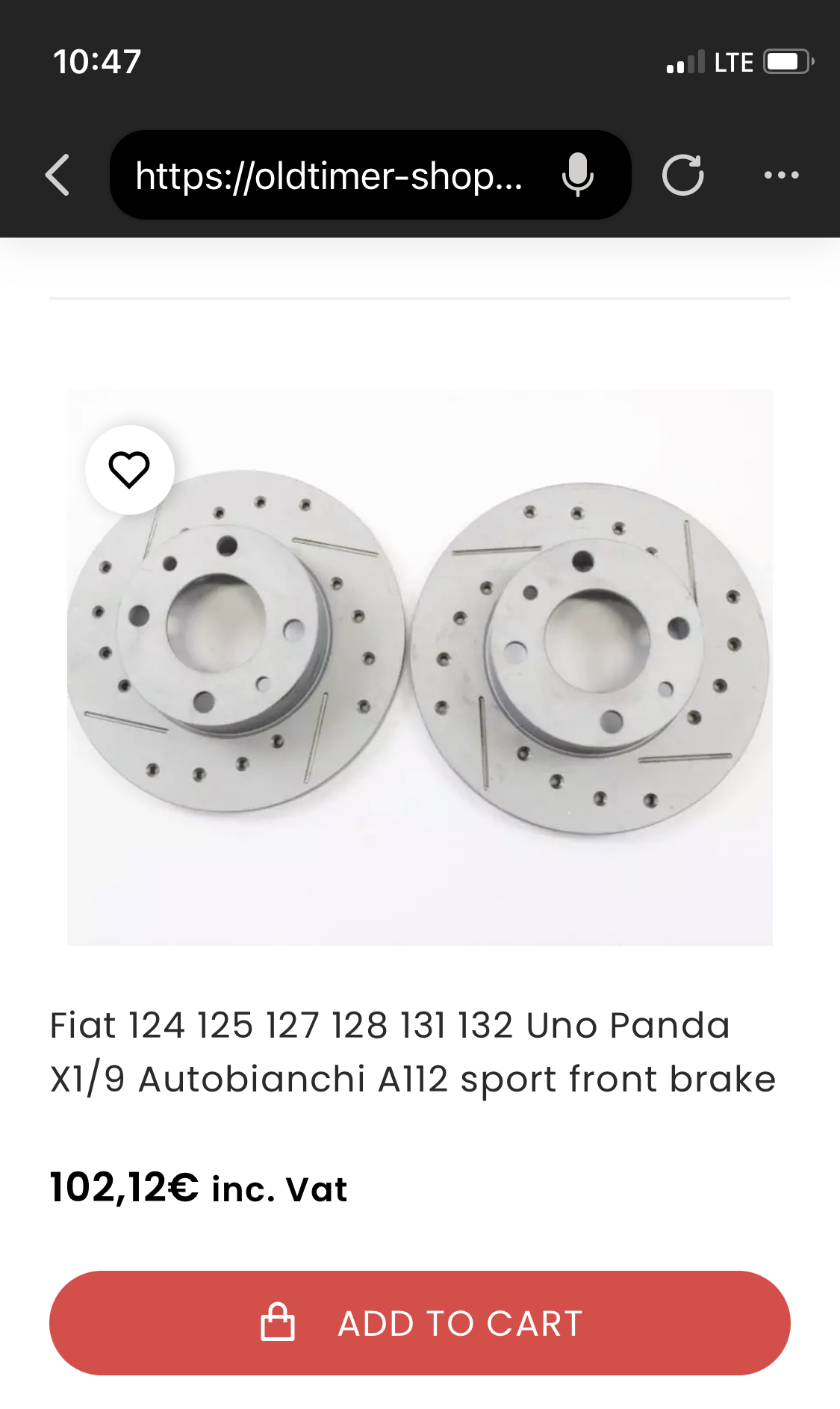

Hey @stocky. I am not sure this helps but the conversion kit I ordered claims the rotors are from a 124. The kit also has shims to correct the backspacing.
I have yet to install mine so I can’t comment on the fit just yet. IMG_2099.jpeg
The kit I ordered is here: Fiat 600 Zastava 750 front discs brakes conversion kit - Oldtimer-shop
Let us know what you figure out!

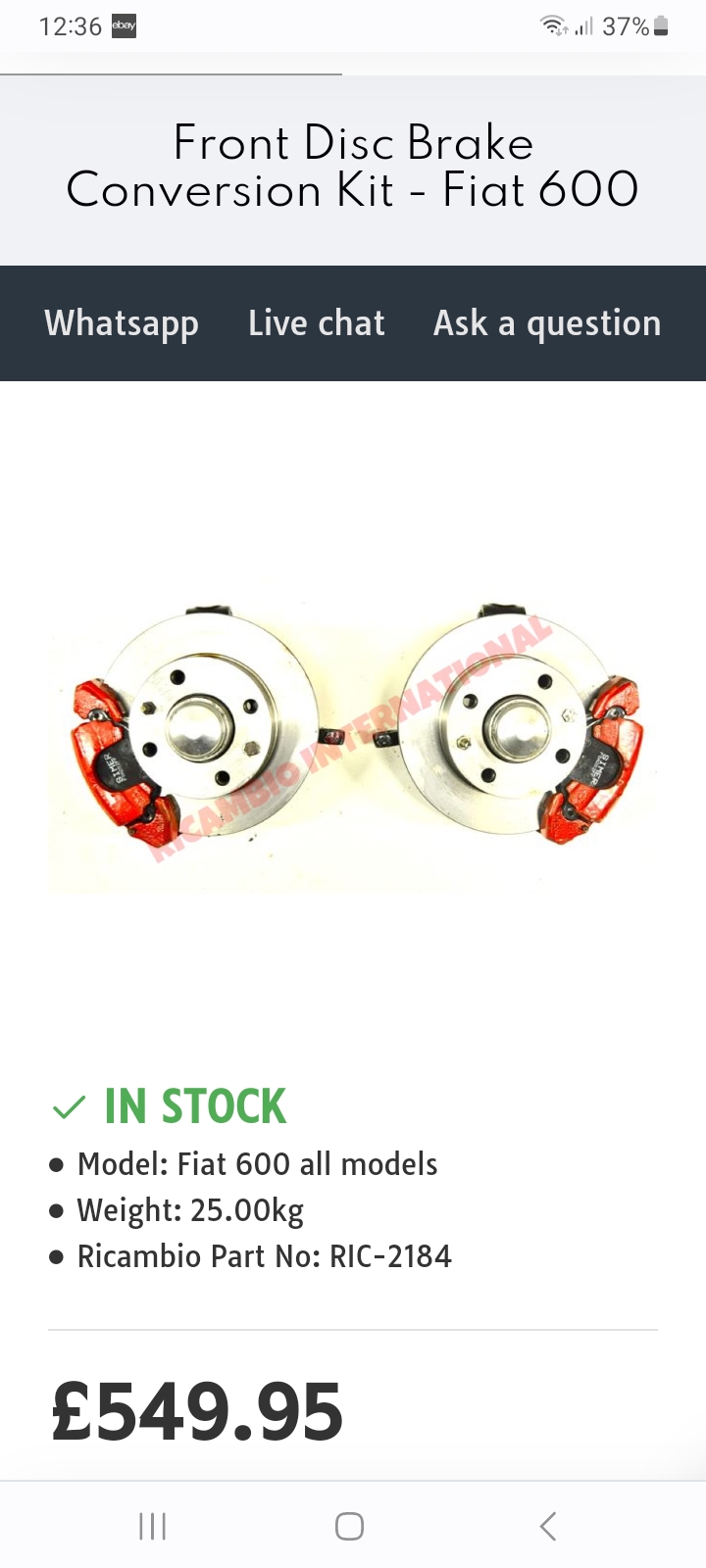

Yes Racambio do a similar conversion. Think even if I sourced some 124 I'd still need the spacer plates so may just buy the kit although it's a lot of money. They also do the rear ones but they're over £800.
Nice. That Racambio kit says it allows use of the 12in wheels. The kit I linked above requires 13in wheels (which I have). Good info for anyone looking to convert their 600.

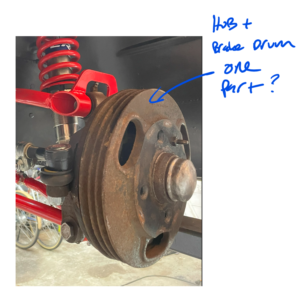

For those who are interested... I am pretty new to the world of 600s, so I am making plenty of mistakes during my restoration project. My front disc brake conversion is a great example. The kit I link above assumes (600D or newer maybe?) that the front hubs and front drums are separate parts. On my 1960 600, the front hub and drum are one part and slide onto the spindle as one. I realized this only after opening up the box for installation.
I toyed with the idea of having the drums turned down into hubs for me to use, but that would have really messed up my wheel offset.
Long story short, Ricambio has come to the rescue and sourced some hubs and rebuilt spindles for me to use. Any savings I may have realized with the kit I ordered has disappeared, and then some. I recommend folks just order the kit from Ricambio. The thought put into it is worth any extra $$. I hope this helps save others from paying the same stupid tax I have been paying.

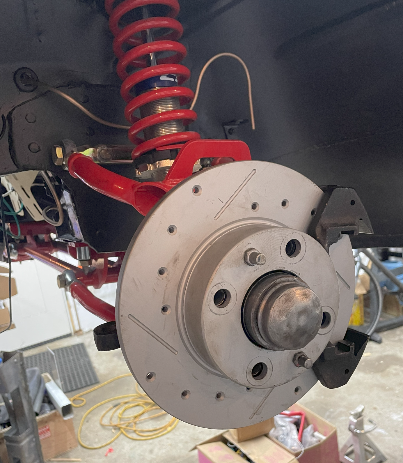

Here is what my kit ended up looking like with the proper spindle and hub. Note that the rotor does not locate on the hub center. Rather, it locates inside the top hat. not ideal:

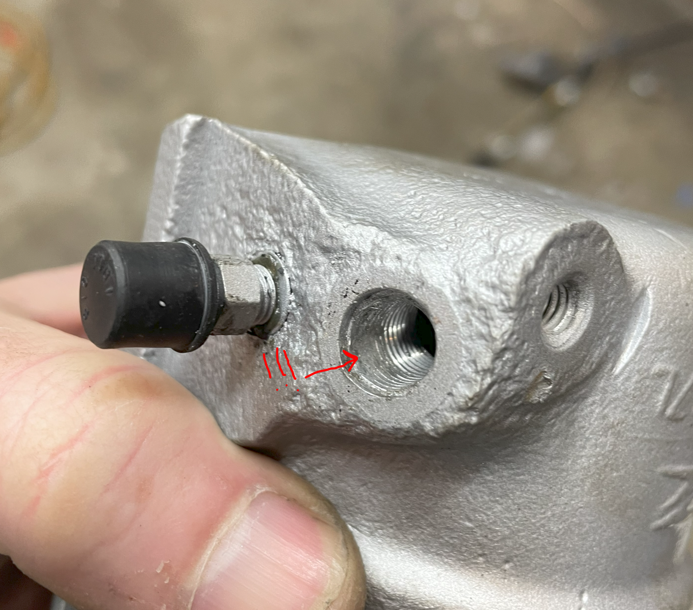

I am waiting on the parts that werent in the box to hold the caliper in place, which appears to be an X1/9 or 127 caliper. Plus, I just noticed that the threads on one of my calipers are damaged, bah!
this has been a battle for me, to say the least, and a bit of a crappy experience. Anyone considering doing this and not buying the Ricambio kit should tread carefully... and keep an eye out of some of the pitfalls I have fallen into. 1. make sure your kit is appropriate for the hub/spindle you have on your car. 2. make sure all the parts are in the box 3. try to make sure the rotor locates properly to the hub so it spins true.

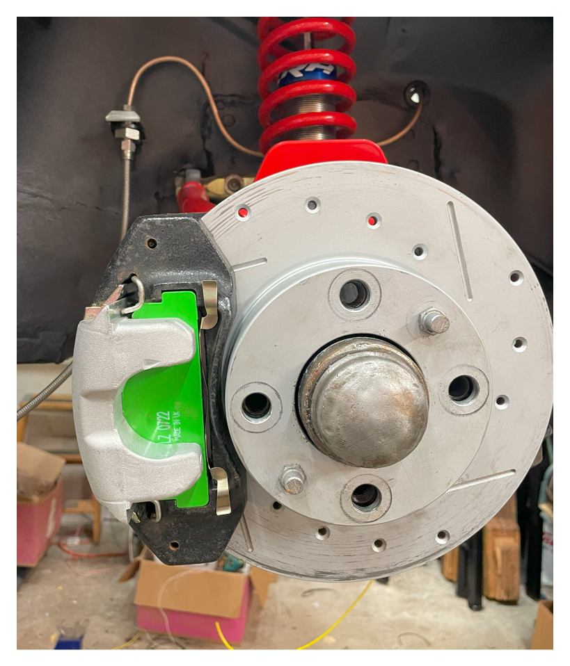

Here is how my setup finally turned out:
I did have to file the wedges and caliper bracket to get my caliper to slide smoothly. Without some filing, it would bind and not release the pad on one side. I sure hope they work well enough to be worth the hassle.
