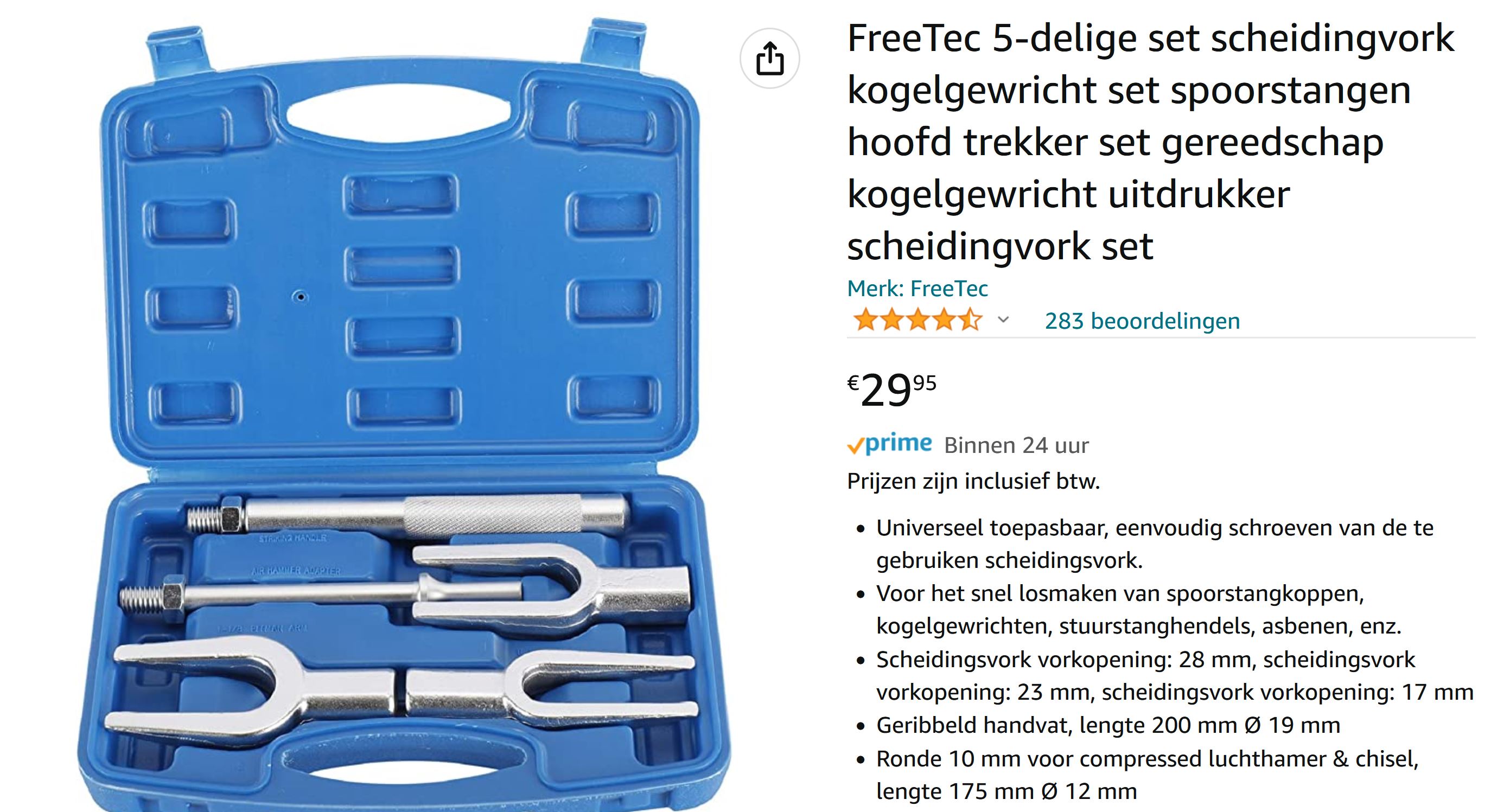

A definitely necessary tool is a simple ball-joint separator. Amazon. See photo 1
