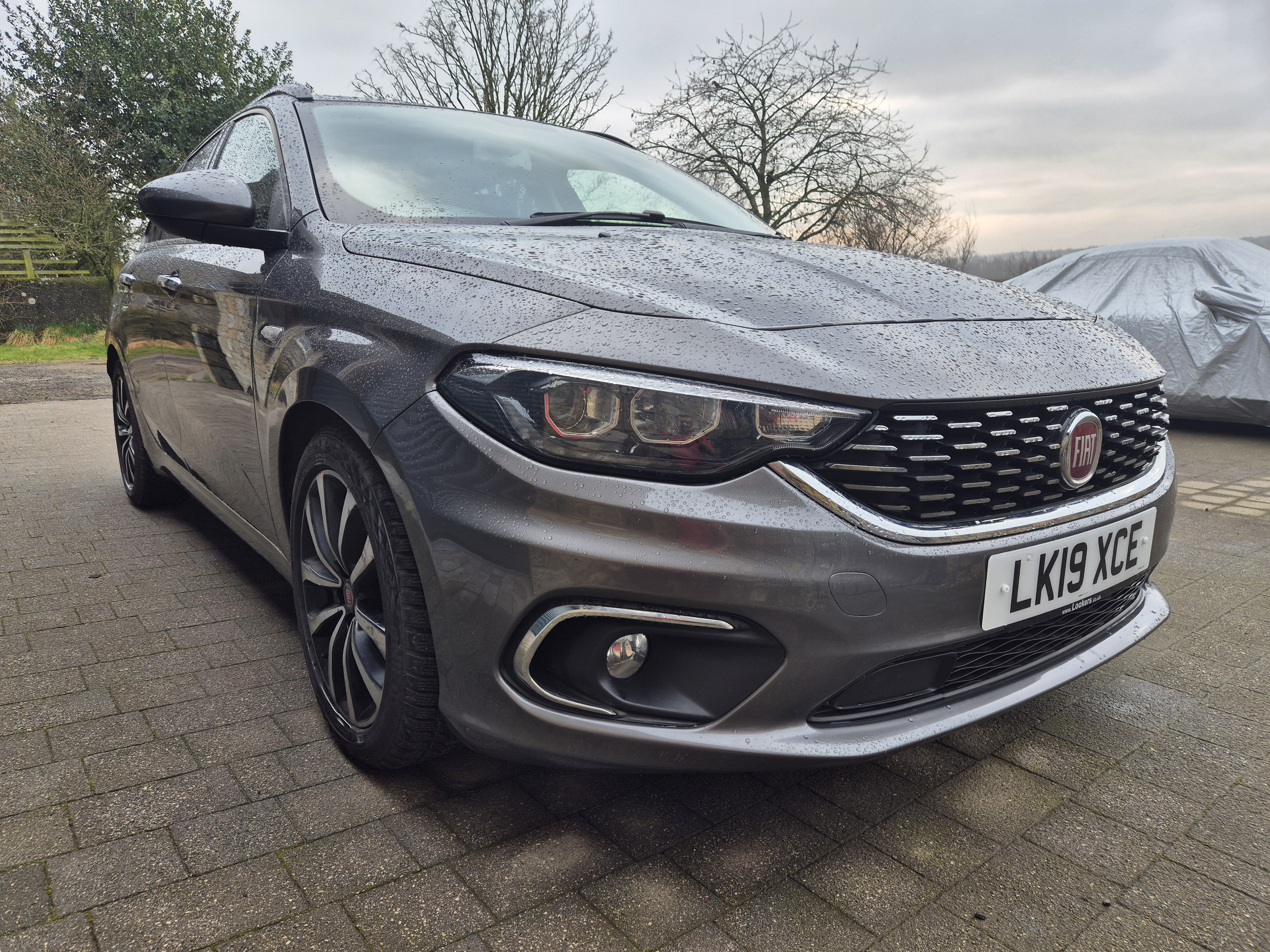

Some Piccys FYI.... You might like the boot badge....

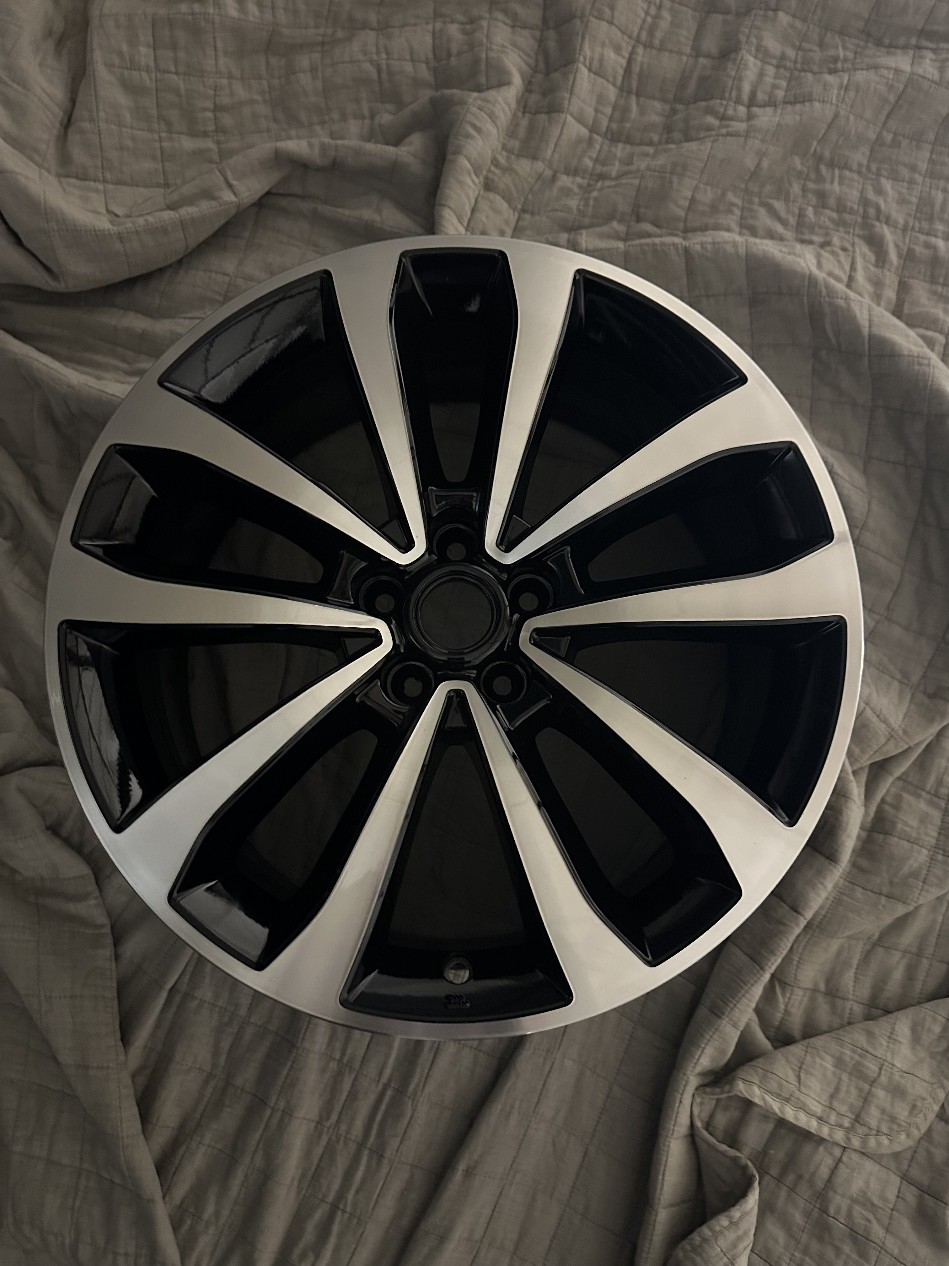

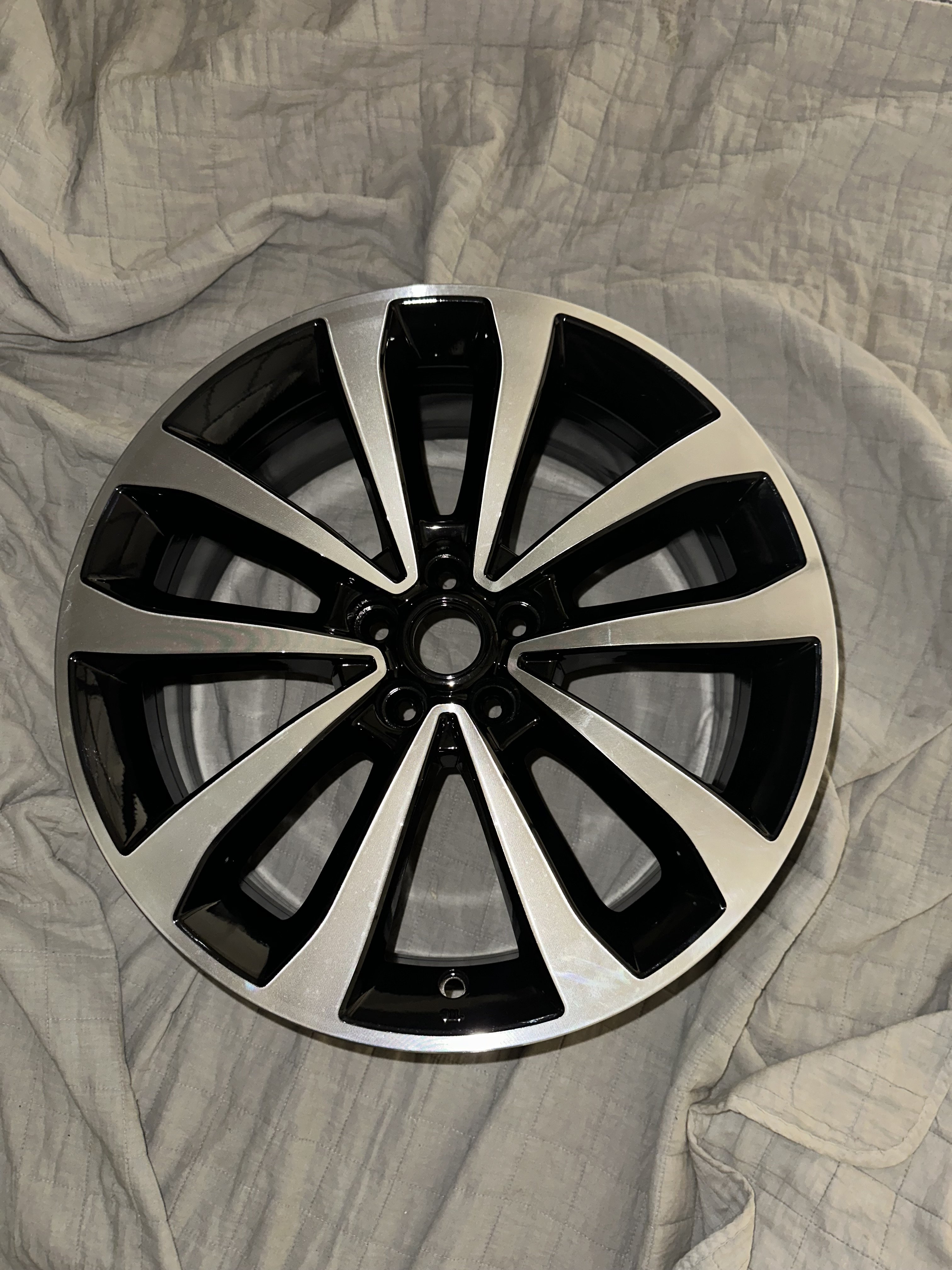

Looks lovely, just had my summer set of alloys refurbed. I’m currently on winters 16s. I think we’ve hijacked a thread a bit. Shall we ask mod to be moved to new topic like Tipo performance modifications maybe?
