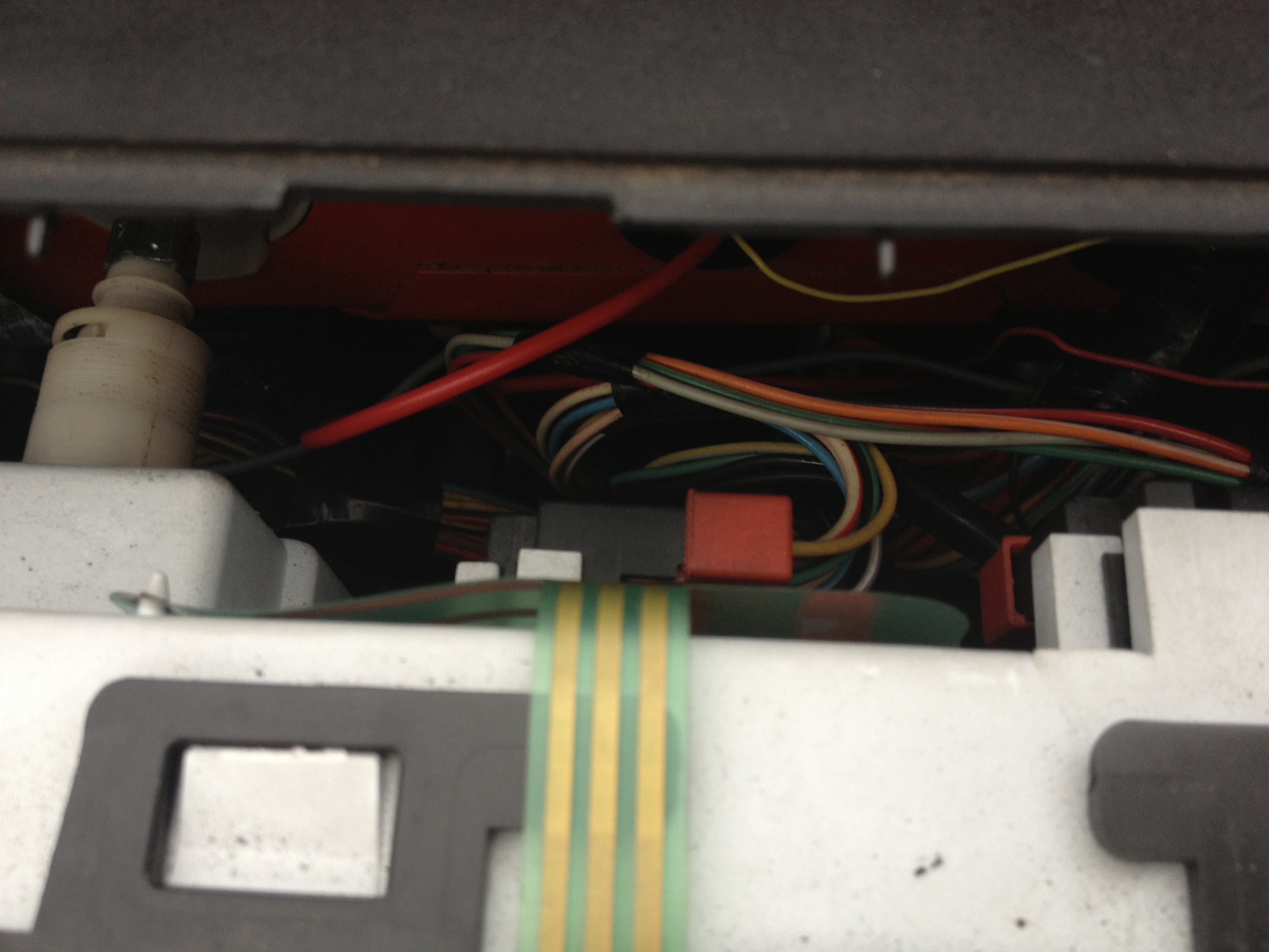

Ok so I went out a took a picture this time, the camera can see more than I can because my phone is significantly smaller than my head,
At this point I've unscrewed the two screws either side of the glass/plastic that covers the gauges, and moved the whole lot out a bit, if I tug a bit harder nothing is going to break then?
So you still have the rear of the dash on like I asked twice...I'm bored now. On on holiday tomorrow and all my helpfulness has been used up...see you all in ten days...Be good boys and gals.
I've done it now :p
After some gentle but firm tugging I disconnected the speedo and got at the bulbs.
