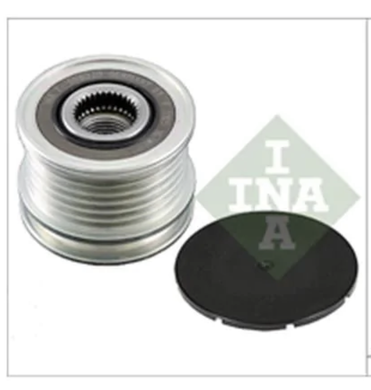

There’s a simple visual way to tell. If the alternator pulley has a black plastic cap over the whole of the end of the pulley (the face away from the alternator and towards the wheelarch) then it is a pulley with a clutch in it. Generally the pulley is a smaller diameter too than might be expected (in my case 54mm I think)
The image shows a typical freewheel pulley with the end cap lying alongside.
