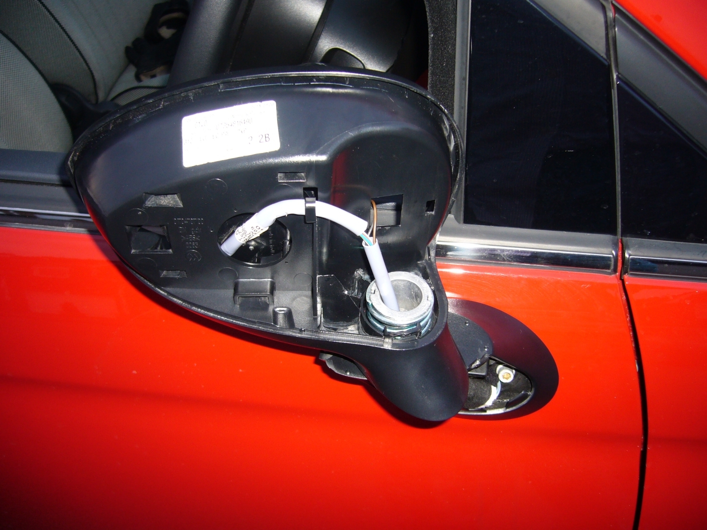

Technical Folding door mirror just fell apart in my hands

I reckon there would be room for a high torque servo in there to make these auto fold.. has anybody heard of this being tried on a 500?
Remember the metal bush is fixed; the spring & upper housing rotate around it. If the bush isn't properly locked, you could end up with mirrors that might self destruct at the push of a button :eek:.
But if you were prepared to do some serious re-engineering, I reckon it could be done. Autofold with ignition off would be a feature I'd actually find useful, if it was durable & worked reliably.
Just thinking aloud at the moment, perhaps I'll keep my eye out for a broken mirror to play with. It probably needs one of your fixes as well.....

...I'm thinking about machining up a new bush, dispensing with the spring & controlling the positioning with a servo (which would also release some space for the motor).
