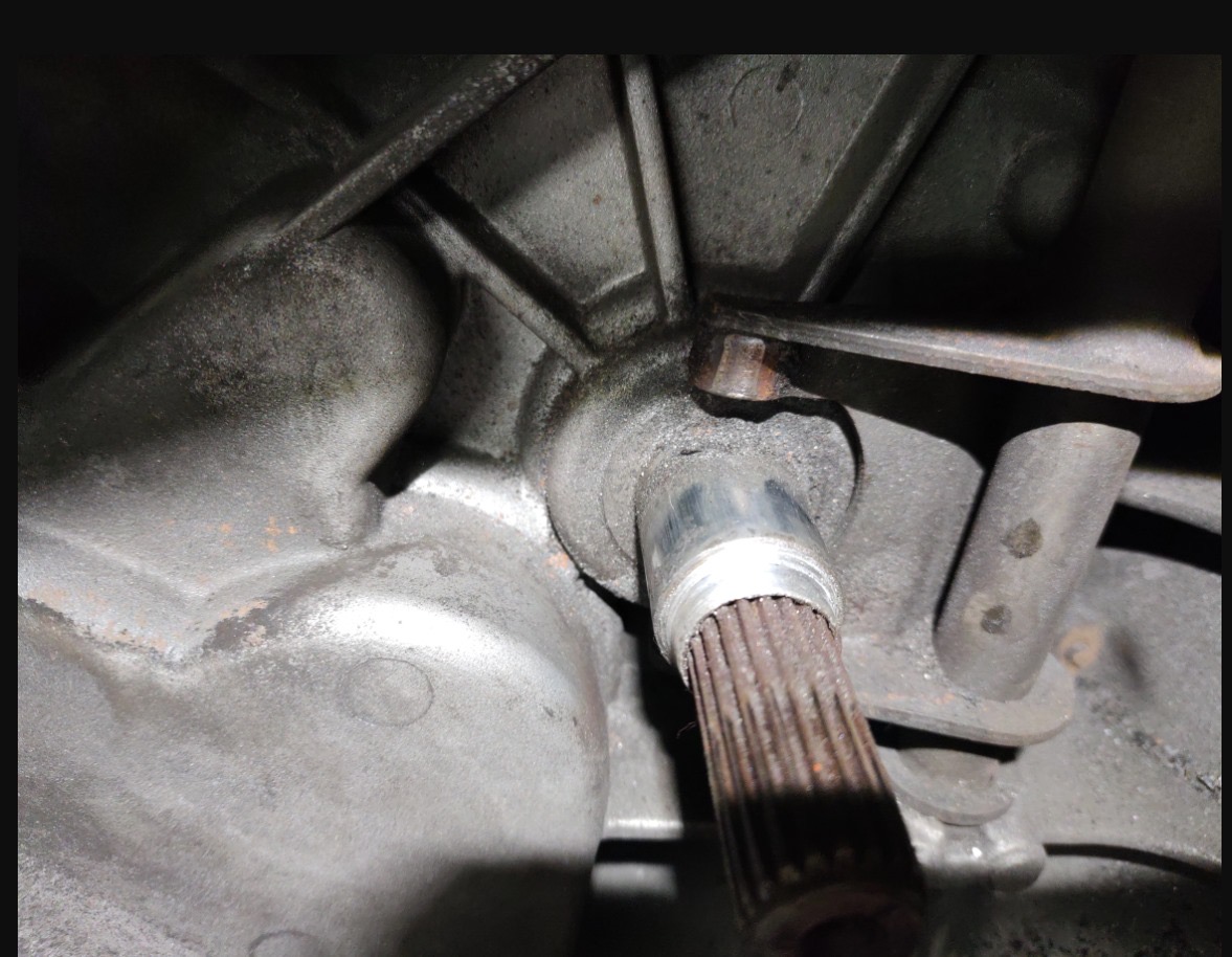

I have exactly the same issue with my 0.9 Mito, the guide is chewed up by the plate, because of DMF's failure,,, as you can see in the pics. The workshop is advising to buy a used gearbox for about 600€, I am thinking of repairing the bellhousing, or maybe just leaving it as it is. Any suggestions? Thank you.
Did you get anywhere with this,as i have same problem as photo 1204 chewed up input shaft, replaced dmf and clutch ,all boxed back up , any advice appreciated

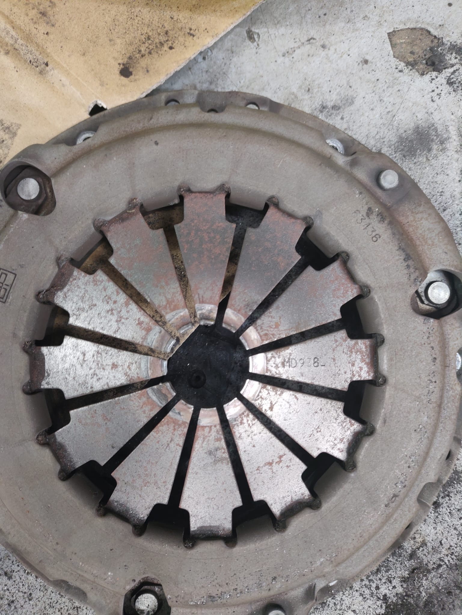

Hi There, I can share my experience only.
My 63 plate TA 4x4 has just had its second DMF/clutch at 84k miles. The previous one at 48k ish and shortly after I purchased it. This second one may or may not reflect the fact that it had taught my daughter to drive and is mainly driven by my wife to and from work often with a lot of stop/start traffic - it is as they say "a wear item".
The latest was replaced by the Alfa/Fiat workshop who reported damage to input shaft to gearbox... See below and note the off-centeredness on the dmf and where the release bearing has been running! This is what does the damage to the input shaft I believe(?).
Having had a longish chat with Ben et al at the garage we made the "engineering decision" to replace the clutch/dmf and carry on as they say. All good thus far; it is possible that I caught the clutch fail before too much more damage occurred but I do wonder if this is the "bell housing" damage that is oft reported (maybe by garage folk with less experience)?
The job was in the order of £1.1k bellhousing not replaced.

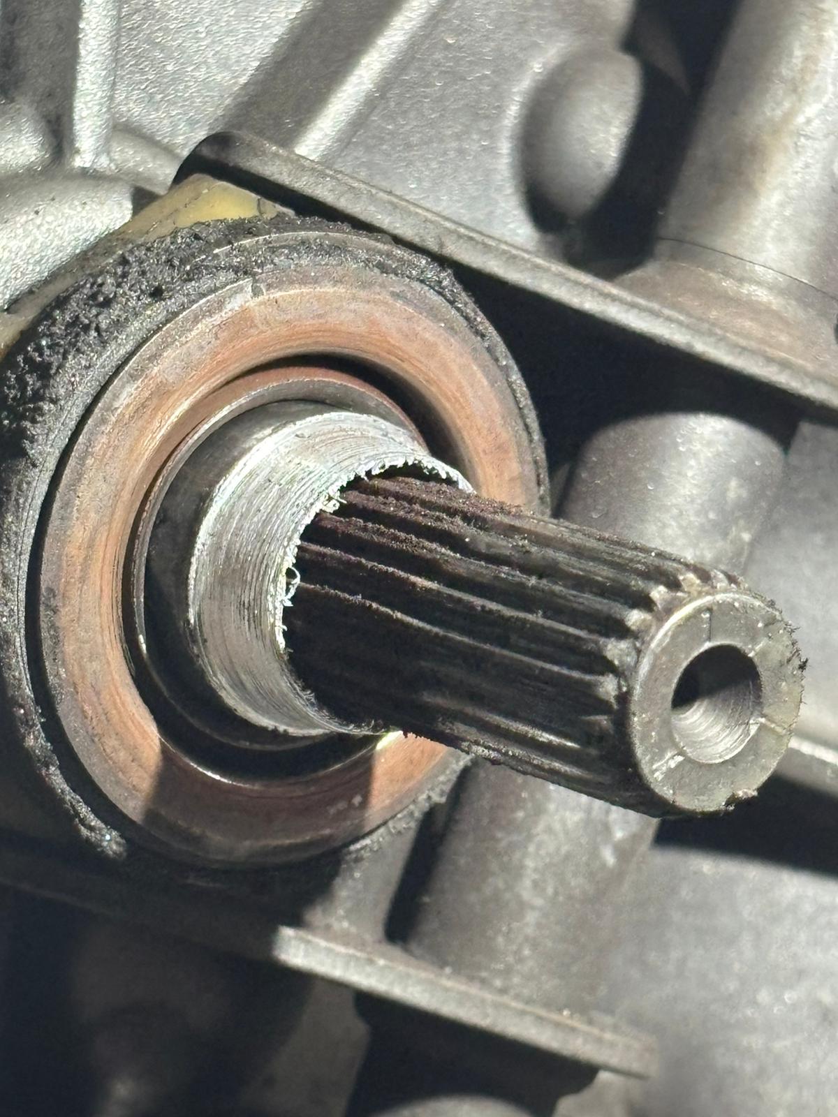

Hi Panda lls, thanks for info, i am of the opinion to "carry on" hoping i have caught it early enough, as said replaced dmf and clutch/bearing at local garage (£1044) , Have been quoted £700 to repair input shaft or £1650 for recon gearbox,, all getting very pricey,here,s the shaft
Hi Panda lls, thanks for info, i am of the opinion to "carry on" hoping i have caught it early enough, as said replaced dmf and clutch/bearing at local garage (£1044) , Have been quoted £700 to repair input shaft or £1650 for recon gearbox,, all getting very pricey,here,s the shaftView attachment 444579
Snap! I call this weight reduction (all the rage in the automotive sector!). I just made sure they gave the bellhousing a good clean to remove that "grinding paste". Once I had seen the damage I was less concerned - the aluminium provides a sacrificial layer... Clearly if you ignore the fact that you can't change gear and let the plate start munching on the actual primary shaft then that changes things!
Fingers 🤞
Fingers 🤞
You'll be fine, just continue to enjoy the driving experience!
