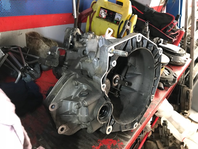

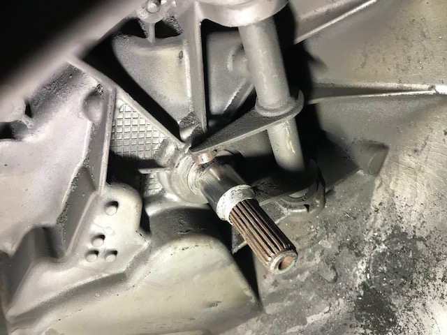

The guide for the release bearing gets chewed up by the flywheel failure. Seen it on a raft of MiTo twin airs. Parts list is bellhousing, input shaft seal, both driveshaft seals, clutch release arm plastic guides (top and bottom).
It takes around 50 mins to pull the box from a mito, takes longer in the panda due to the subframe design. If you know a decent engineer or machine shop, they may be able to manufacture and fit a new guide, but Fiat don't sell them, have to buy complete bellhousing and strip a rebuild the box.

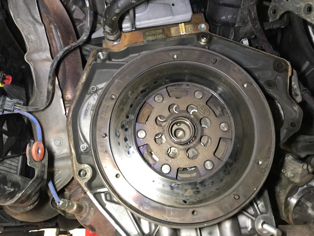

I have exactly the same issue with my 0.9 Mito, the guide is chewed up by the plate, because of DMF's failure,,, as you can see in the pics. The workshop is advising to buy a used gearbox for about 600€, I am thinking of repairing the bellhousing, or maybe just leaving it as it is. Any suggestions? Thank you.
