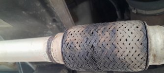

Had a look under car recently to find source of a tapping/exhaust blow sound type noise and noticed this on flexijoint. Centre pipe was replaced 2 years ago with flexijoint but this doesnt look normal to me. Or is it normal for a 2 year old pipe?

Get someone to bing op the exhaust outlet. Only leaks in the exhaust system will be obvious. 2 years is not a long time, but there are great many really cheap & nasty exhausts on the market that don't last much longer. Also check you have the support clamp just after the catalyst and the "dog bone engine mount is not worn. Excess movement will over-work the flexi joint.
@DaveMcT I guess you meant to type 'bung up the exhaust outlet'?
As in, block the tail pipe temporarily and any leak in the exhaust will make itself heard.
That flexi does look rough for two years old, but then it is the lowest point on the car and gets scuffed easily. My flexi is blowing at the moment because it's been bashed on bumpy lanes too many times. The woven steel mesh on mine has completely disappeared!
But if theres a hole/crack/split in the pipe under the steel mesh it could it sound like a blowing exaust then seal itself enough to quieten once the cars warmed up?
If it's torn, it's torn. Put your hand over the back of the exhaust. If pressure builds up and you can't hear a leak (it will be obvious with the exhaust blocked) , it's fine
It's a simple test and 100% effect as far as I know at finding leaks up the catalytic converter.
The photo is inconclusive looks more like a few drops of oil to me than black soot from a blow, I don't see any axle stands only a jack in the video, please stay safe
