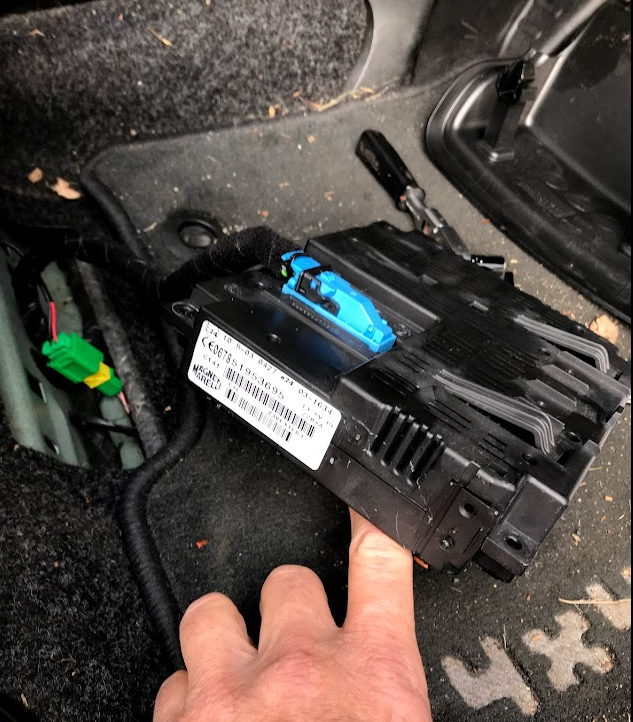

Here's mine as it emerges from its home (63 TA 4x4) That part number is 51953695. Looks like there's a few out there in Internet land - variable prices...

Brilliant! Hope you didn't just remove it for me to look at?

No, I took some photos when I did the job a few years ago now - just for reference, in case someone on here was interested ;) .
I think the failure mode is that the B&M (which would normally turn off after 10 or 15minutes after the ignition is switched off) stays on (although not working). I think measuring voltage without a load maybe misleading (ambient temperature variation for example) but others may advise here. Personally I would measure amperage but it doesn't change anything - I'd say the B&M unit is dead.
