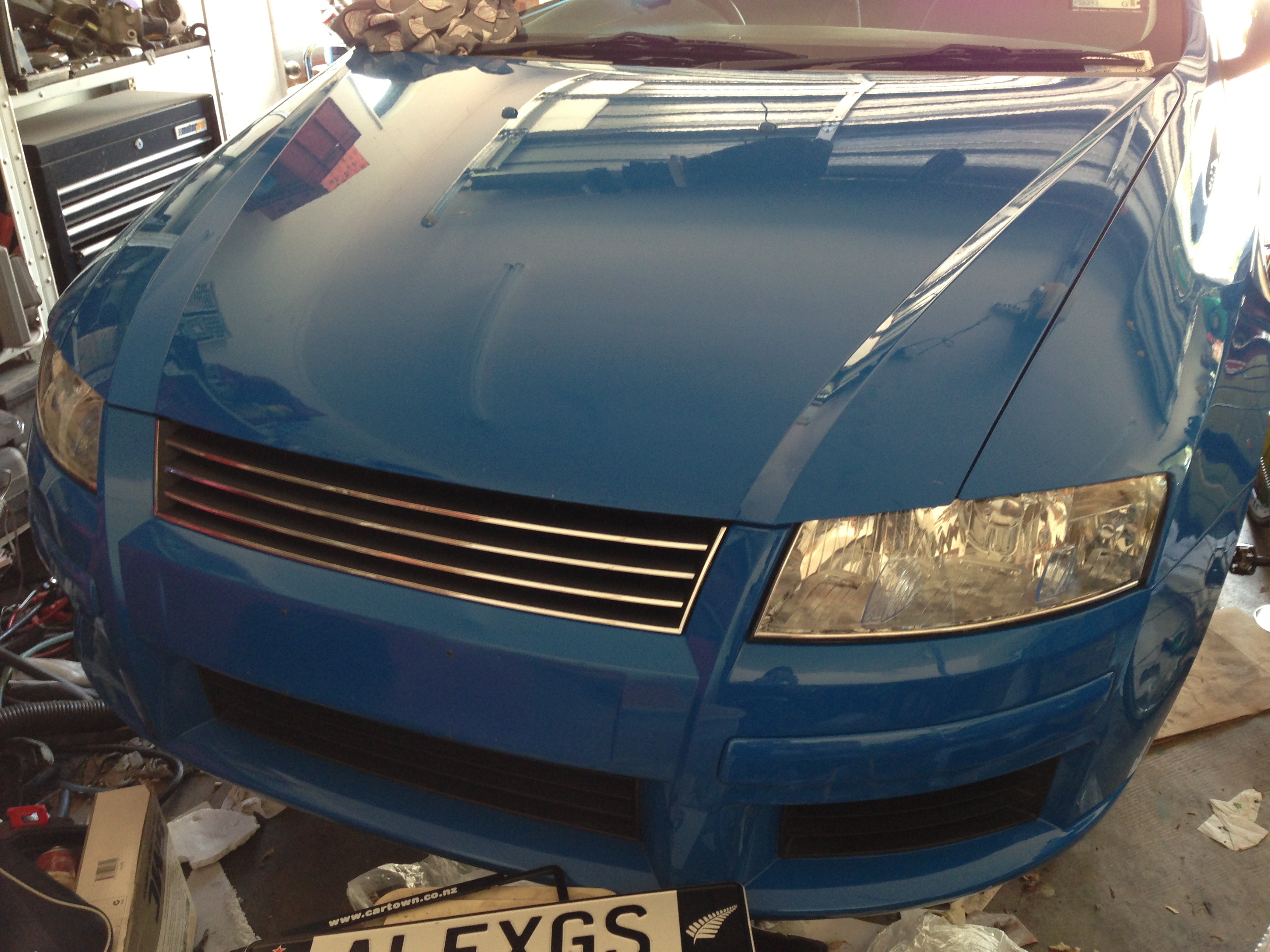

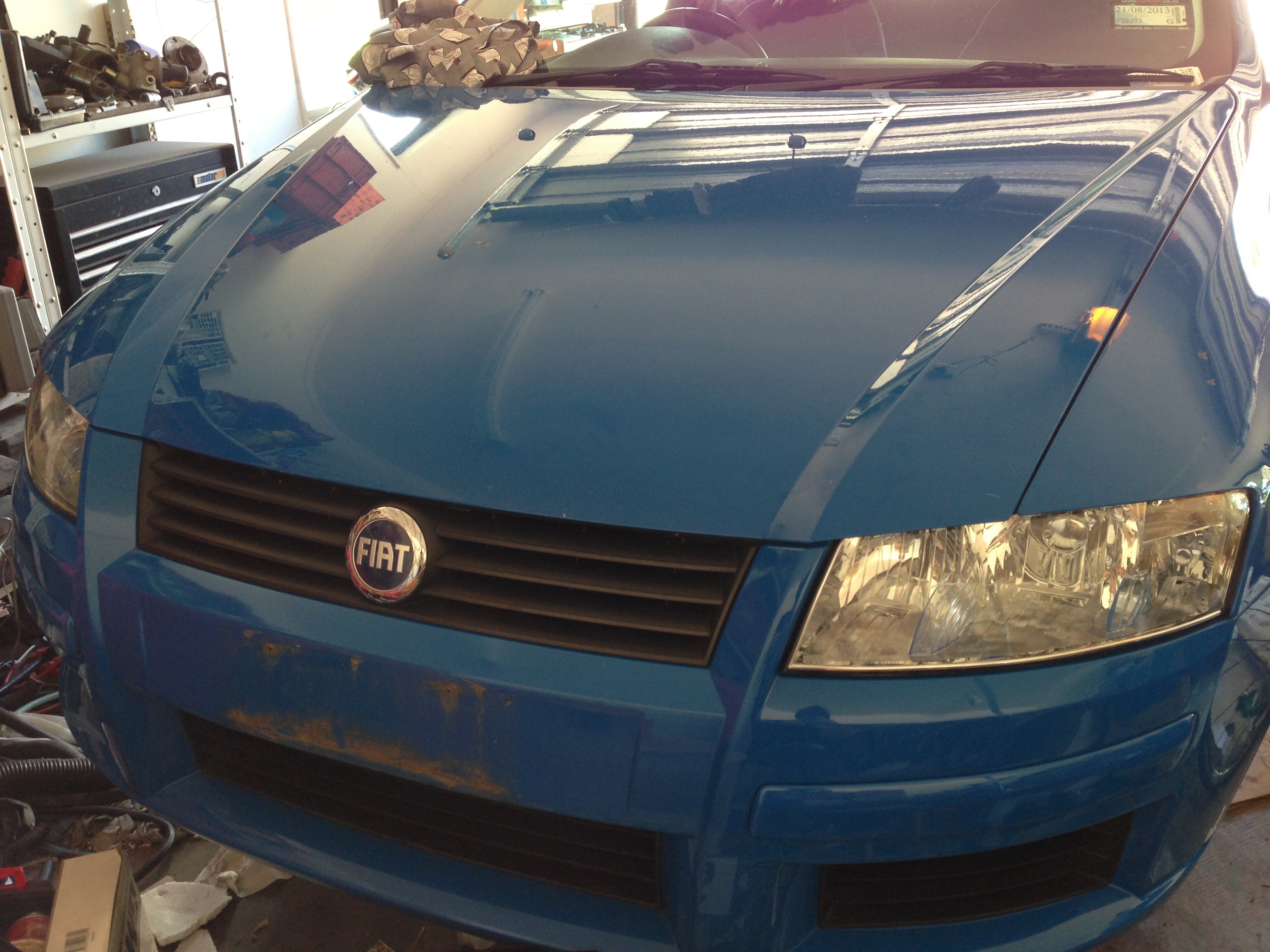

Removing the old grille was surprisingly easy - it's just clipped on, not even a single screw. I removed the four screws securing the top of the bumper, just to get a bit more movement and see what I was doing.
Fitting the new grille required some remedial work to trim down the plastic clips (tabs) and to enlarge the lower slots in the bumper slightly. Before doing this, I pushed it hard to try and get the tabs into the slots, and one of the tabs broke off. Therefore I suggest comparing new against old and trimming down those tabs before attempting installation (y)
Looks great I reckon :)
