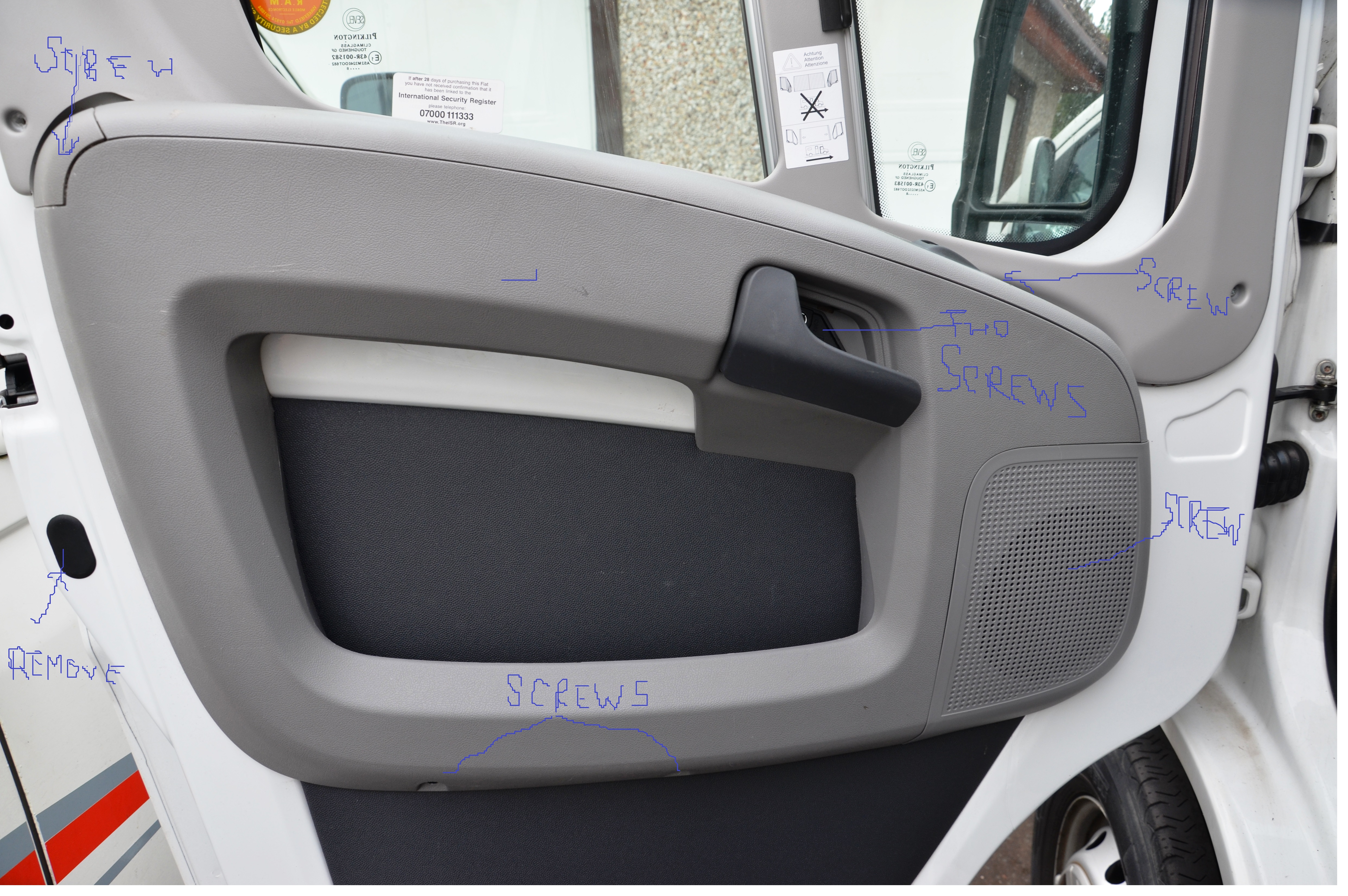

Fitting door handle. On FiatDucato 2008. There are seven screws holding thearmrest to the inside of the door that are difficult to find. two at the bottomtwo behind the inside door handle, one under the window switch, one behind thespeaker, and one at the top left under the small cap. Then to get at the threenuts behind the handle you will need a 10mm deep socket a normal socket won’tdo it won’t reach the nut. The black plastic grommet needs removing for thesocket. Hope this helps someone.
