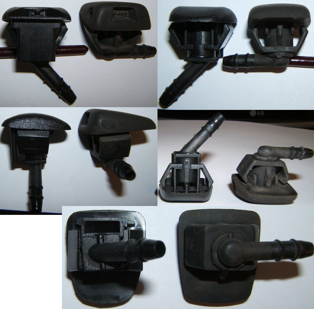

Old vs New
You can see how similar the jets really are. The new one has a sleeker lower profile and a nicer finnish.
Highlighted in red is the bit you will need to cut off.
I made two cuts you can see the heating element in the second pic that I had to cut through.
The other difference is the neck. The original is 90 degrees the new is 45 degrees. Not a problem though. You can pull the neck's off and use the originals or just swivel them around.
The new nozzle does not have vertical adjustment, but hits the windscreen in just the right place.
There you go a quick guide. Good Luck.
