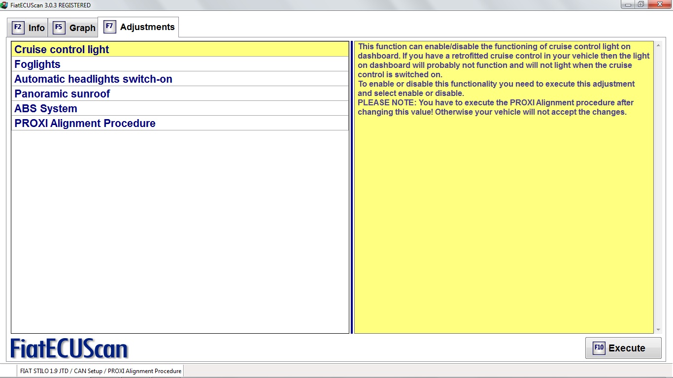

I tried but Proxi-alignment is required afterwards or it won't work. I'm unable to to do Proxi-alignment on my Stilo as FES is still unable to access the Stilo Climate Control node. :(

Is this actually possible? I understood retro-fitting the stalk meant you had to do without the dash light, as the body computer will never recognise the fact that cruise is installed...
Yes, check out the attached screen shot.
I've got no Idea how this happened but the Cruise Control Light on the dash is working.
When I turn the cruise control on, the light on the dash lights up.
When I turn the cruise control off the light on the dash goes off.
Proxi-alignment must have worked. :shrug:

Proxi-alignment definately failed because the millage is still flashing but the Cruise Control light on the dash deffinately works as it should, check out the video below.

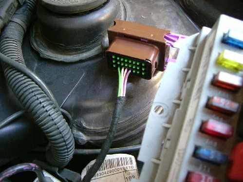

If I have this connector in the battery bay with these four wires going into it, does this mean I am prewired?

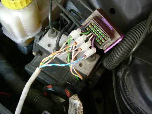

I have a question cause I plan on using your approach:) I have two wires going into each pin of the D4A connector like in this picture here:
attachment.php
So I have these two wires going into a single pin one of them has to be connected to a 12V feed and you use toggle buttons that just send a pulse to the ECU that way, right?

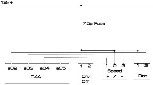

D4A requires the relevant wire to be fed with 12v to activate each part of the CC system
for your off - (on) 'resume' switch give it 12v at one teminal and link the other one in to a02
for your (on) -off - (on) 'speed' switch give the 'center' terminal 12v and link the other terminals to a03(speed -) and a04 (speed +)
for your on - off 'power' switch put a 12v feed to it and link the other terminal to a05 (as long as a05 recieves a constant 12v then the CC system will be active)
switch types that i used were as above.
depicted like this (on) means it has a momentary operation. so you press it and when it is released it returns to the off position.
i think that makes it a little clearer but i dont know.

all well and good on a CC system that is linked into CAN network... Stilo CC isnt... its just feeding certain pins on the engine ECU with a 12v supply hence why its only 4 wires... the light on the dash is the engine ECU talking to the dash module telling it that it has a 12v feed on the CC 'activate' pin. (the dash module only recognises the signal from engine ECU and puts the light on if it has been correctly set up via a parameter change and proxi alignment)
