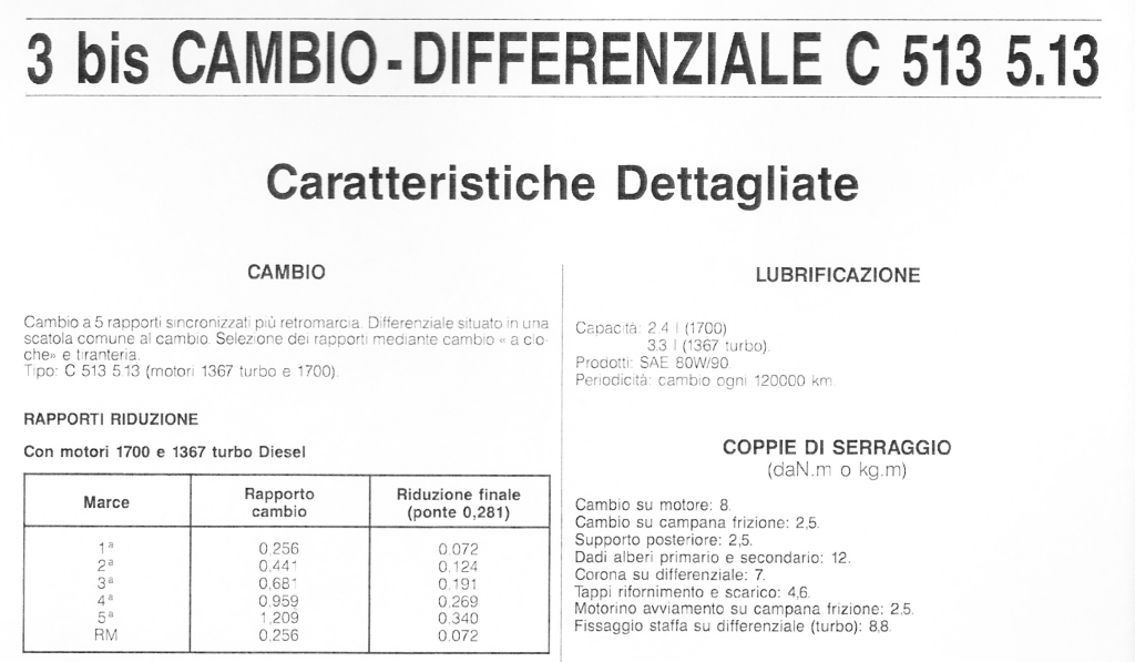

Looking for advice I am changing the gearbox on my fiorino 1.7d (which I am happy with doing) my problem is what oil to fill the gearbox with?
I know its 80w/90 but its the API bit I am not sure on the attached pics show:
Punto mk1 (close relative) and it API GL4
Uno Gearbox C501 5.10 (not mine but same user manual) API GL5
Uno Gearbox C513 5.13 (mine but doesn't show an API)
I think its the GL5 but have read on google that its not good for synchromesh rings anyone know the actual answer?
