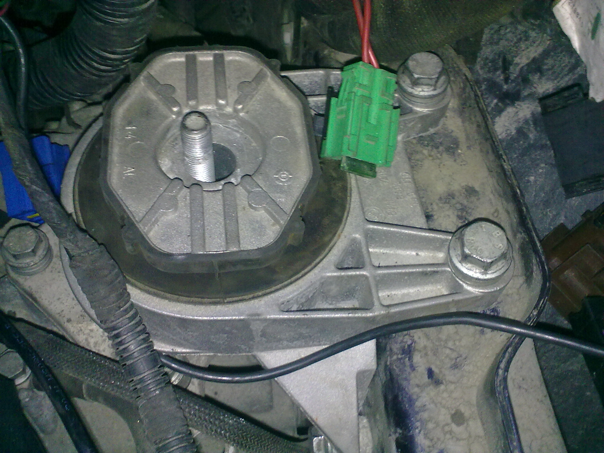

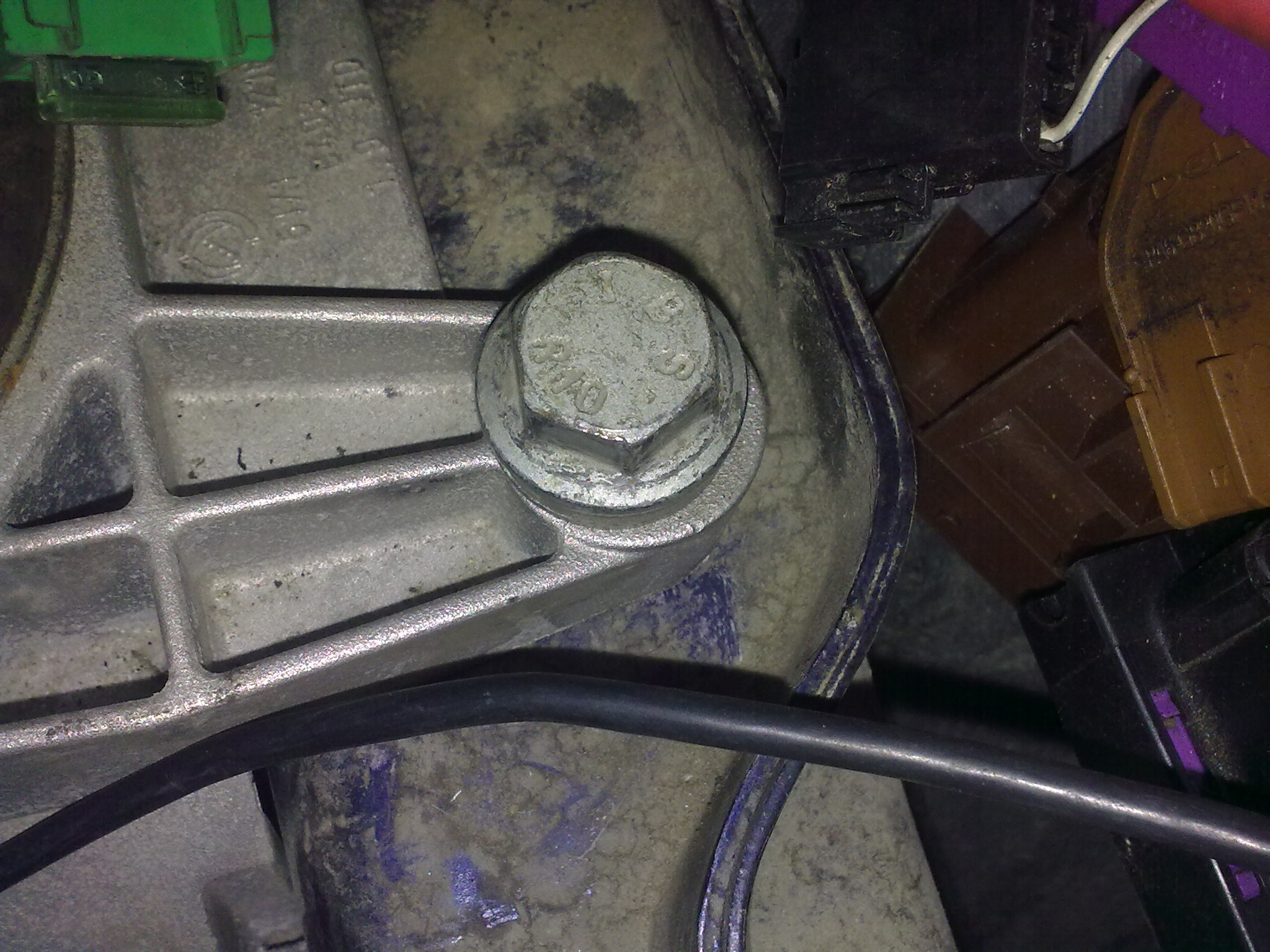

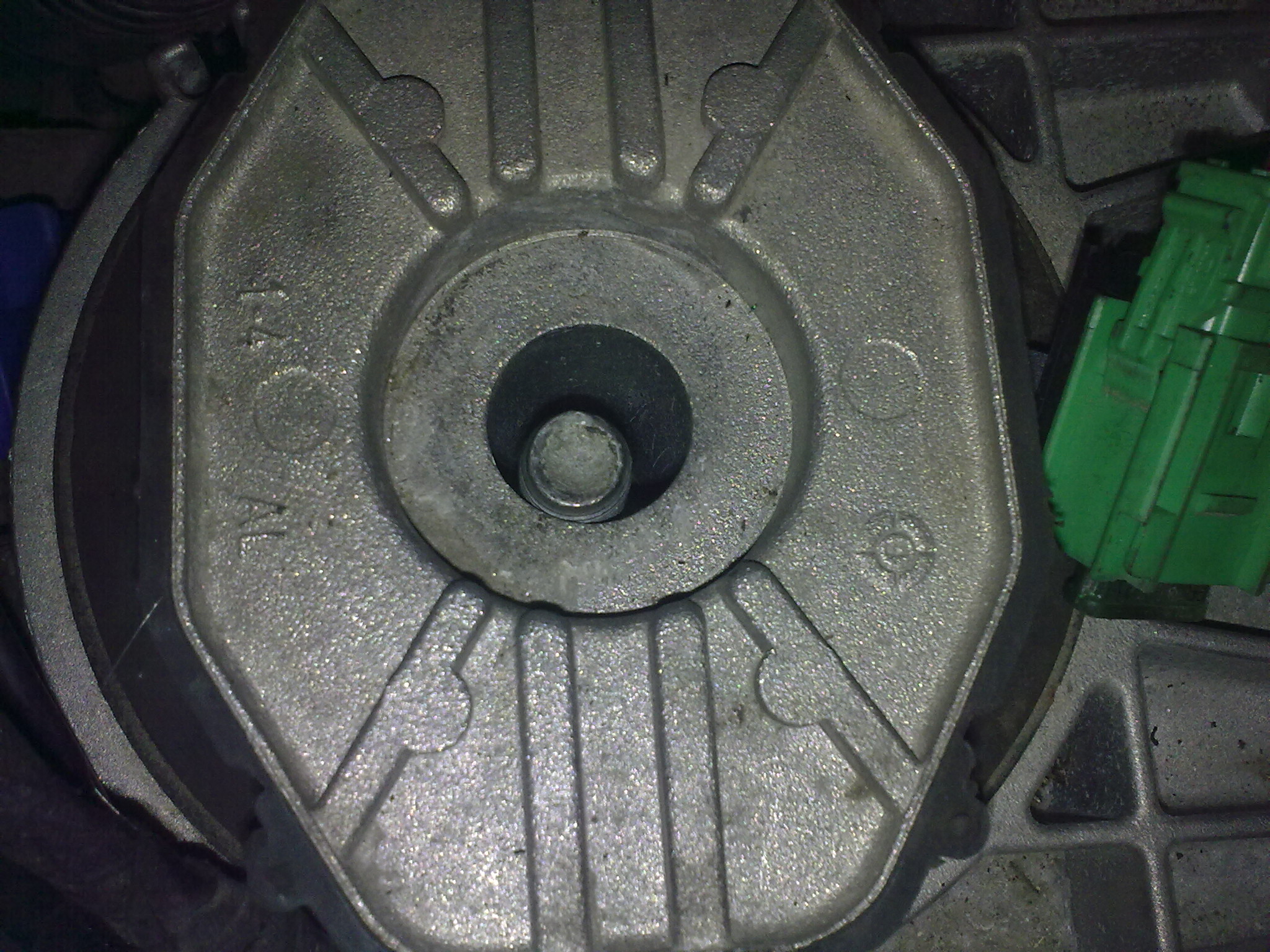

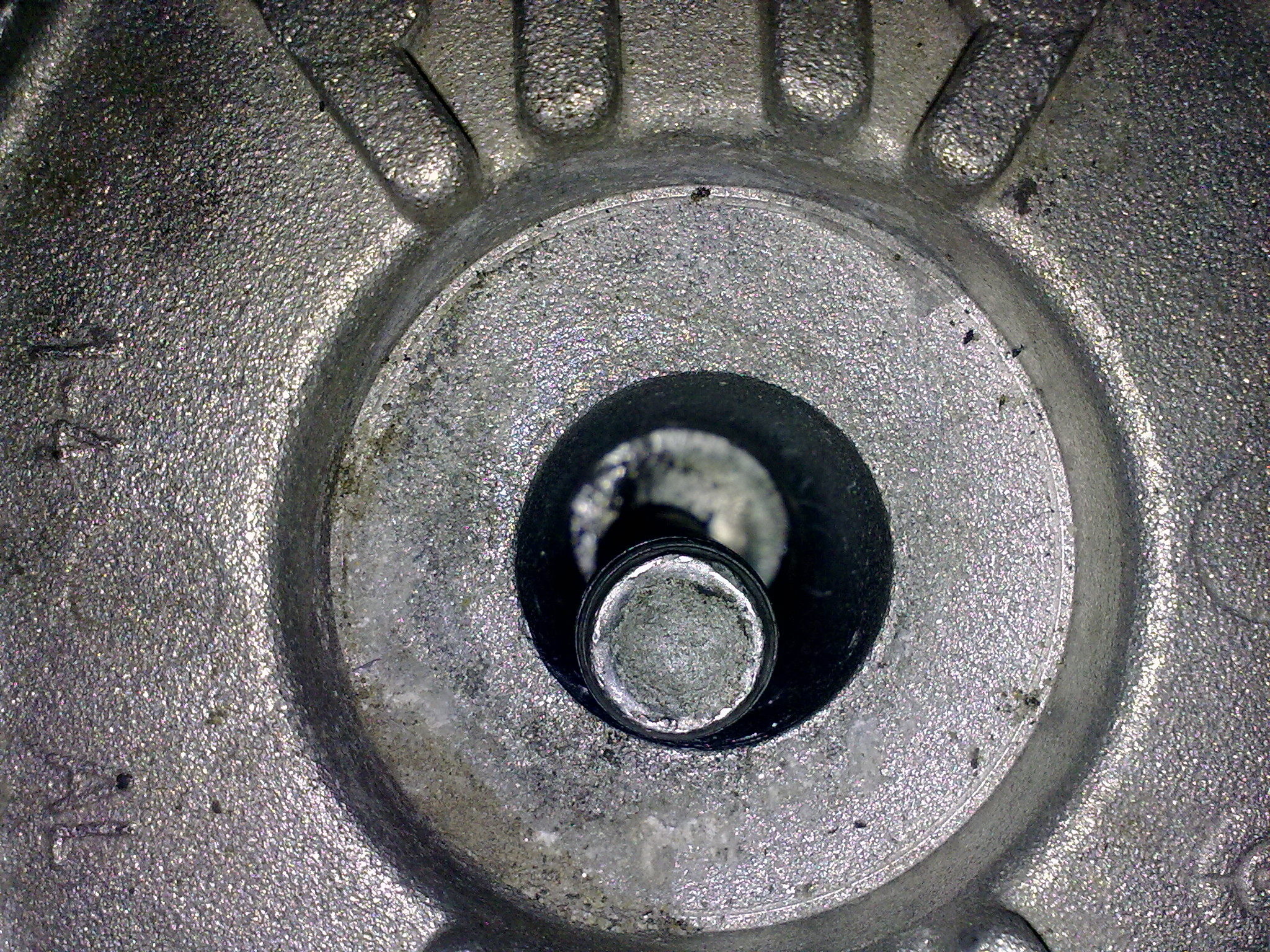

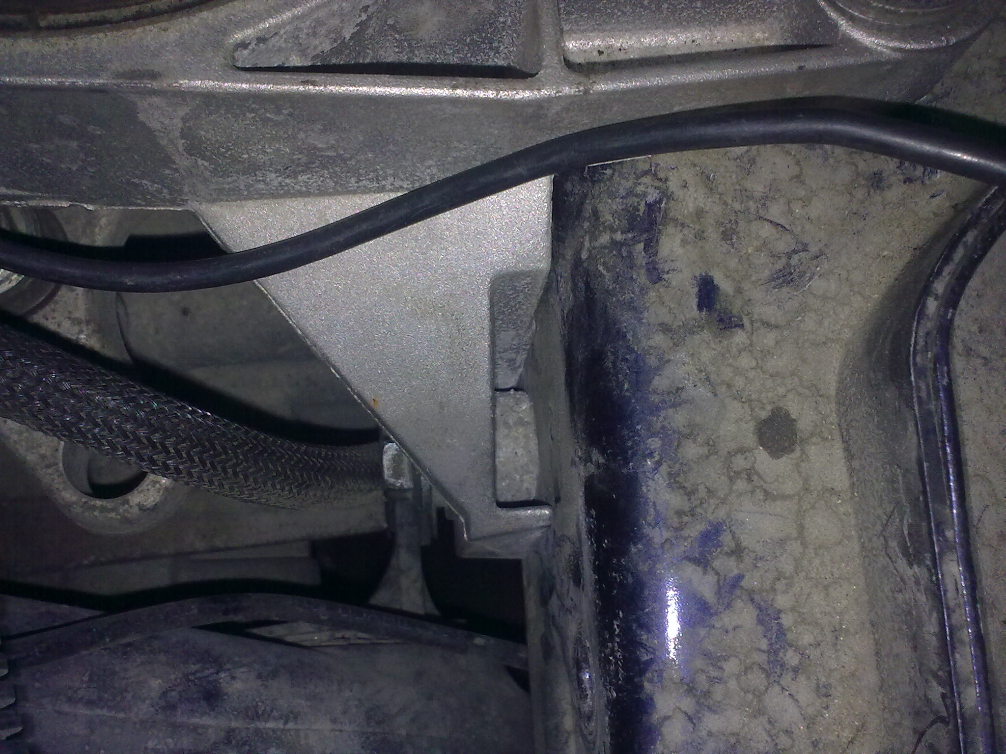

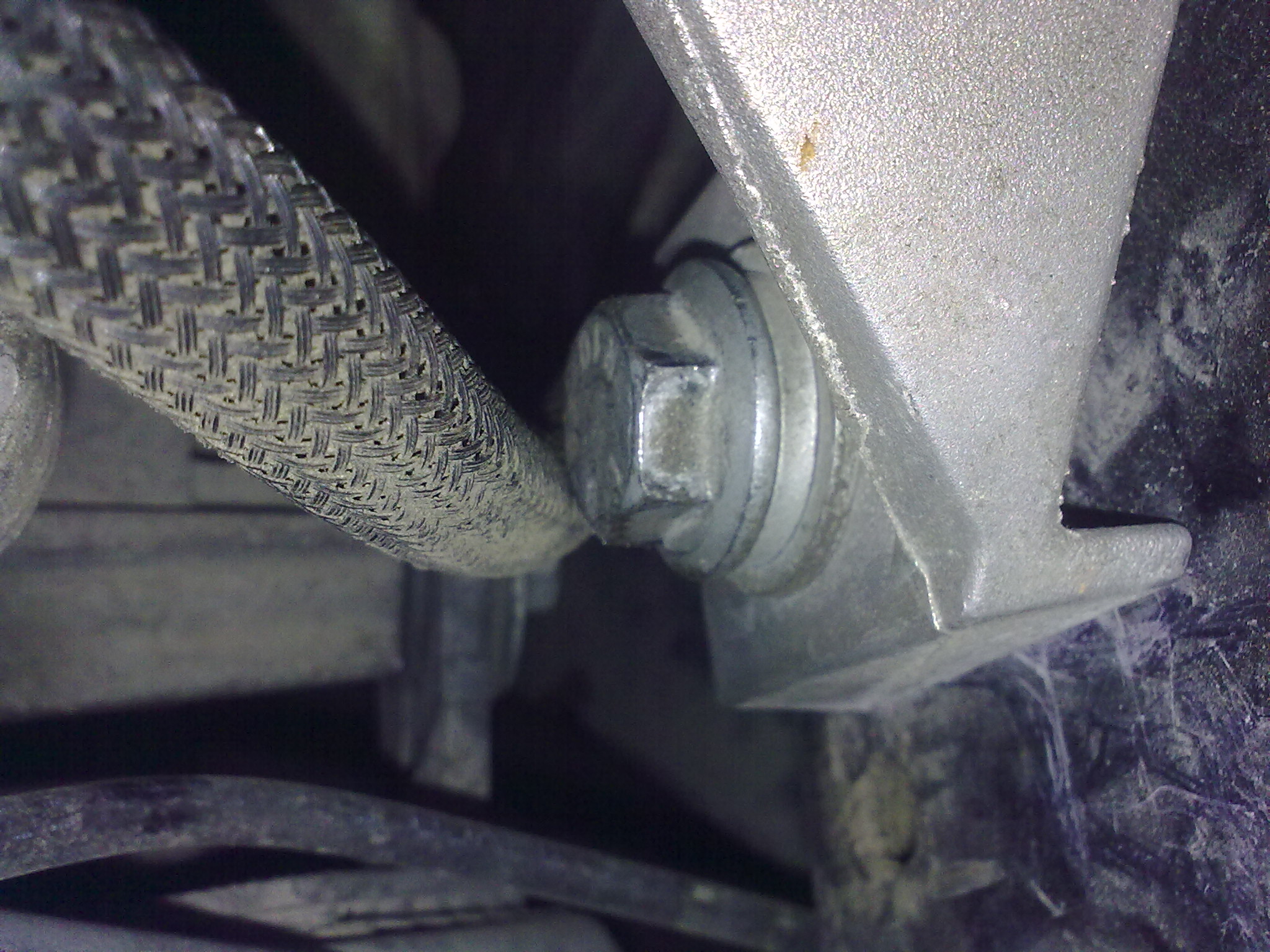

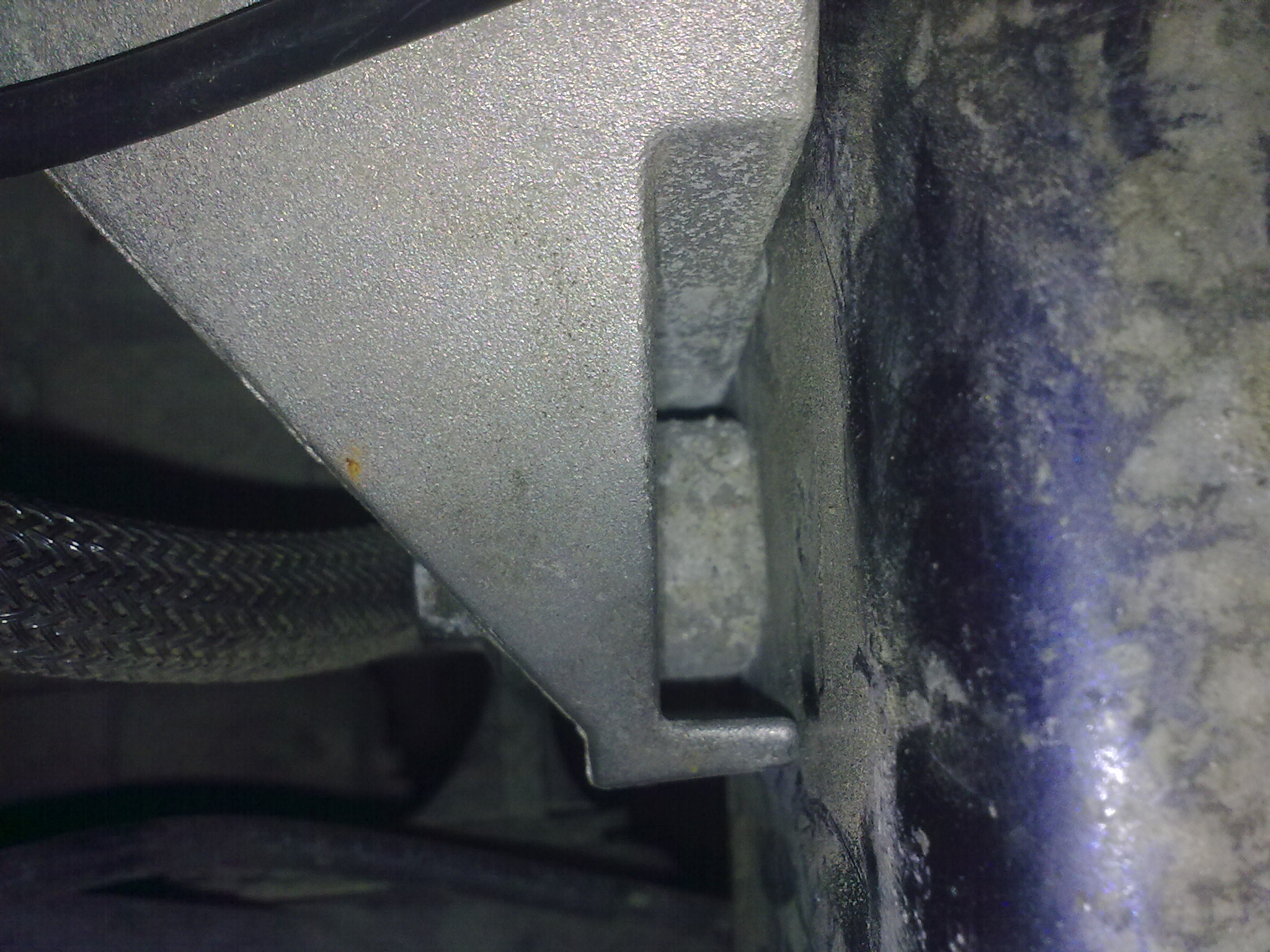

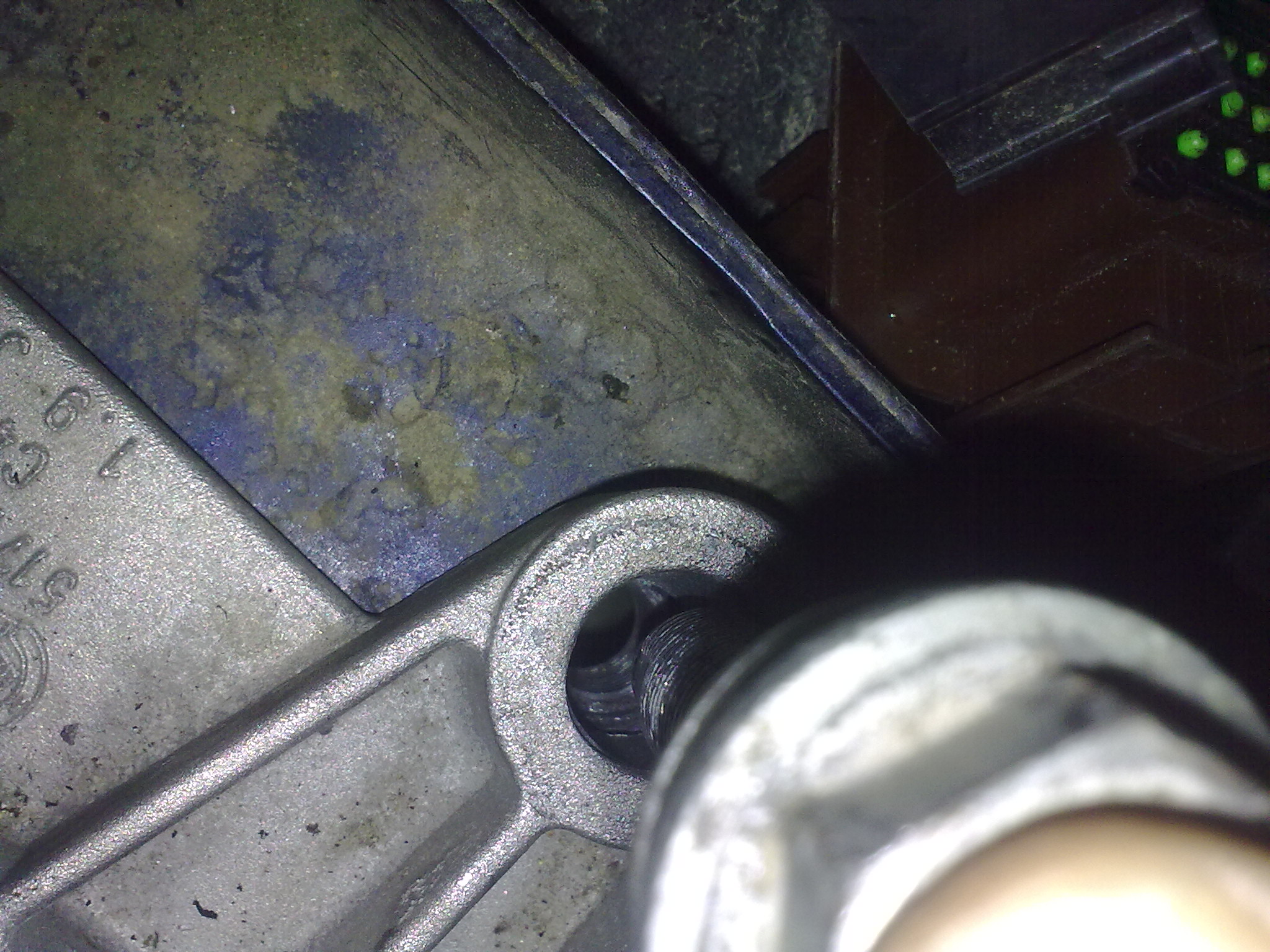

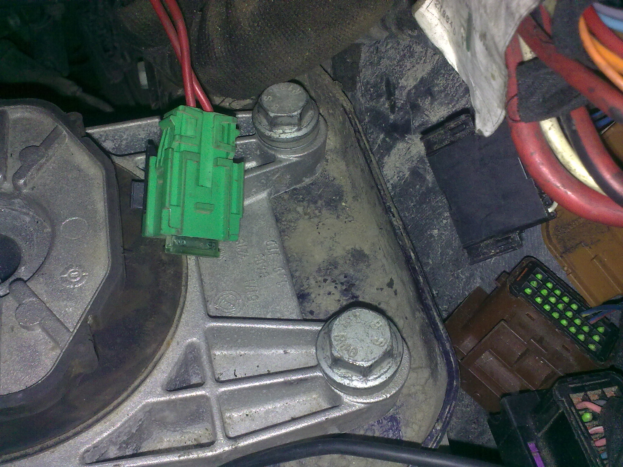

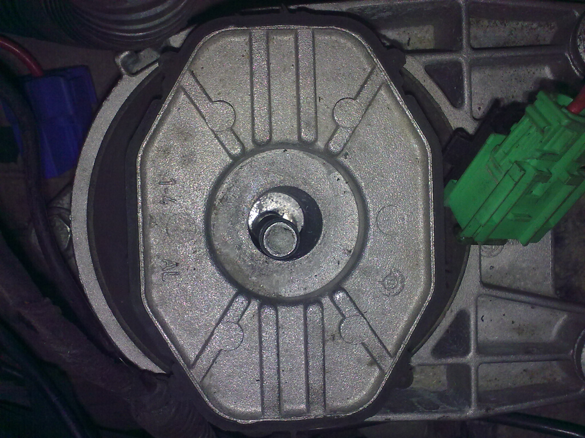

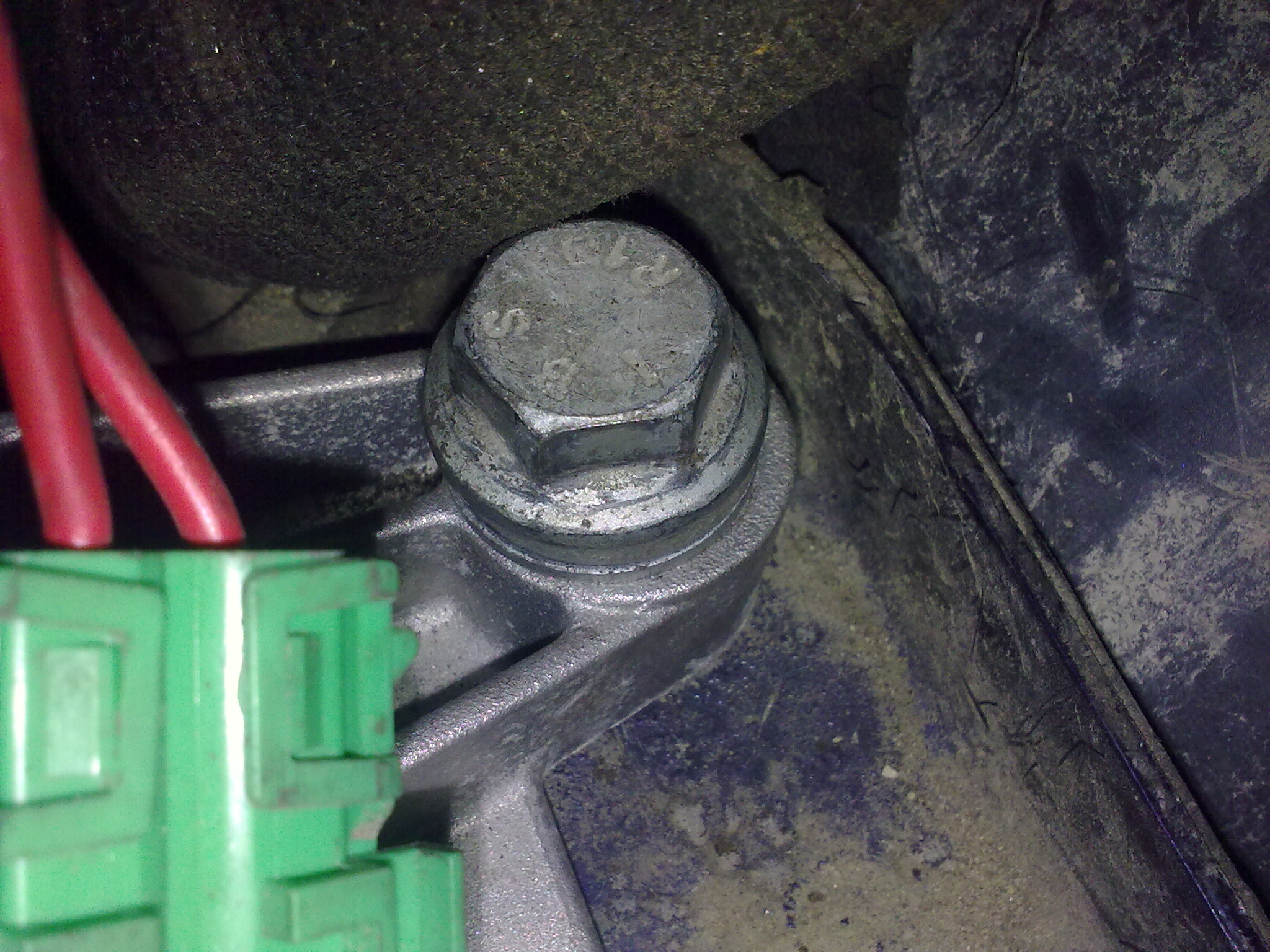

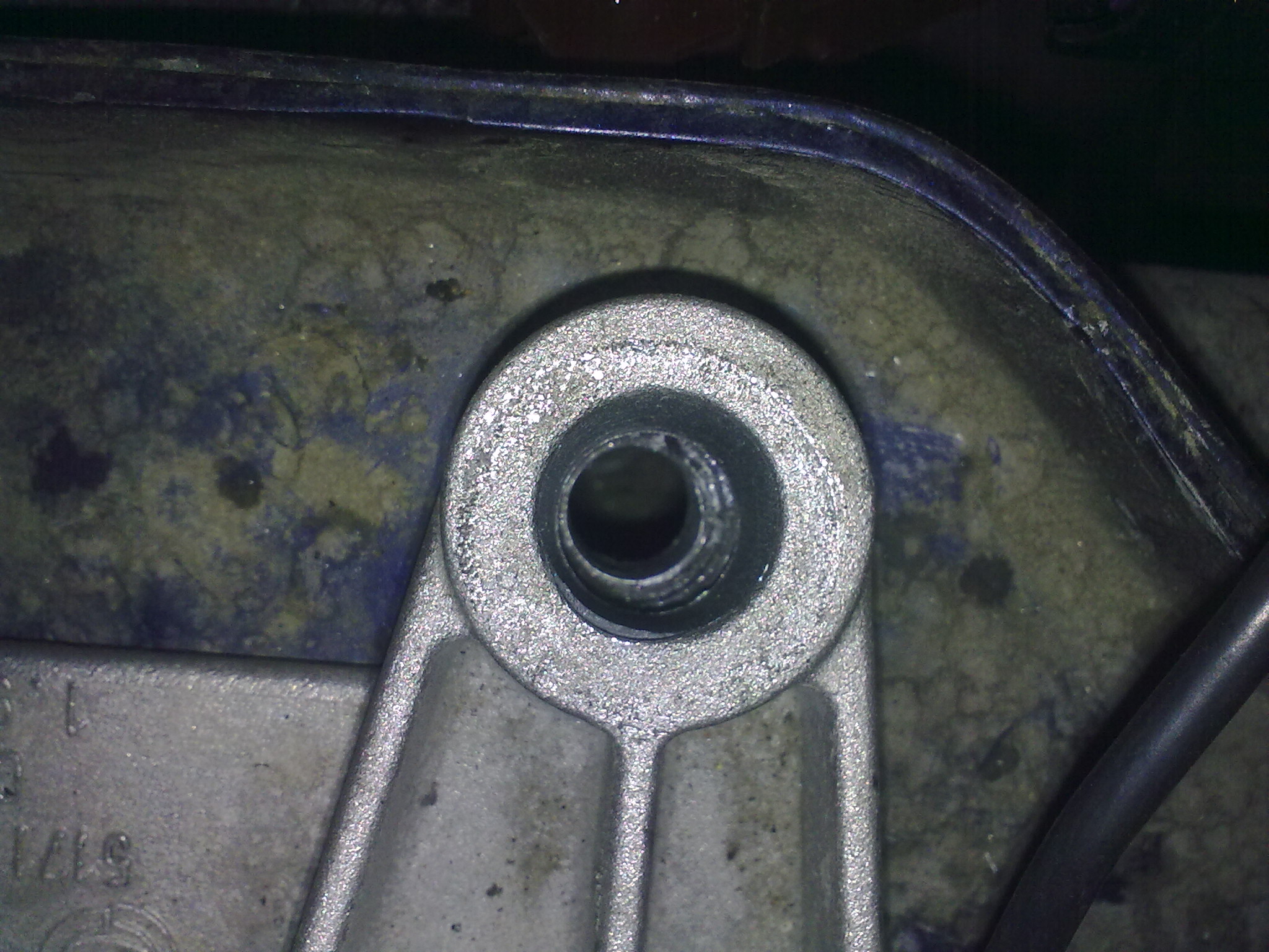

I have the following problem:
And whatever i do, i can't fix it in the middle, so the mount is always under pressure and i have awful vibrations only in iddle. They shake pretty well the car.

I watched my mechanic fit the thing and to get it centred you have to play around with the jacking to take the pressure off to allow it to centre.

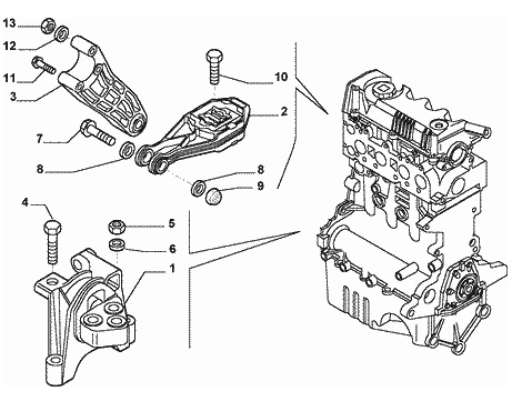

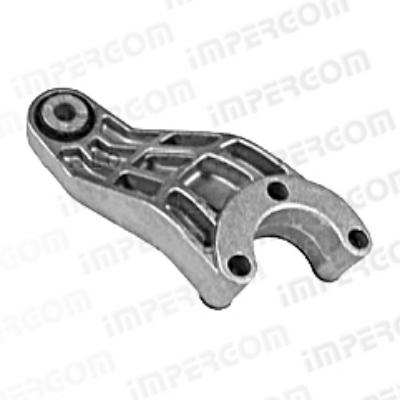

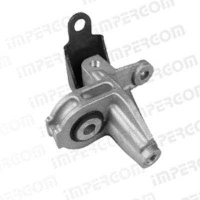

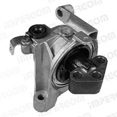

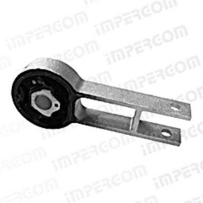

Hi!
Can anyone tell me what are the rest of the engine supports ? I have some pictures from a car shop but I don`t know where they are

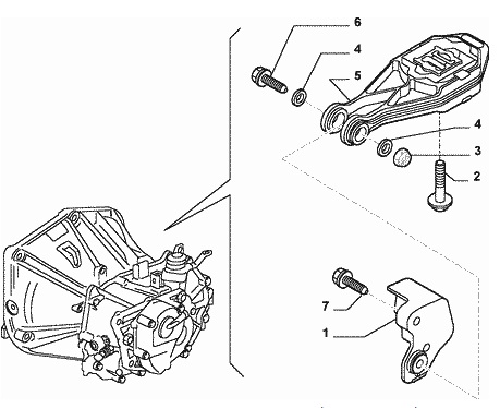

I`ve found this on ePer
