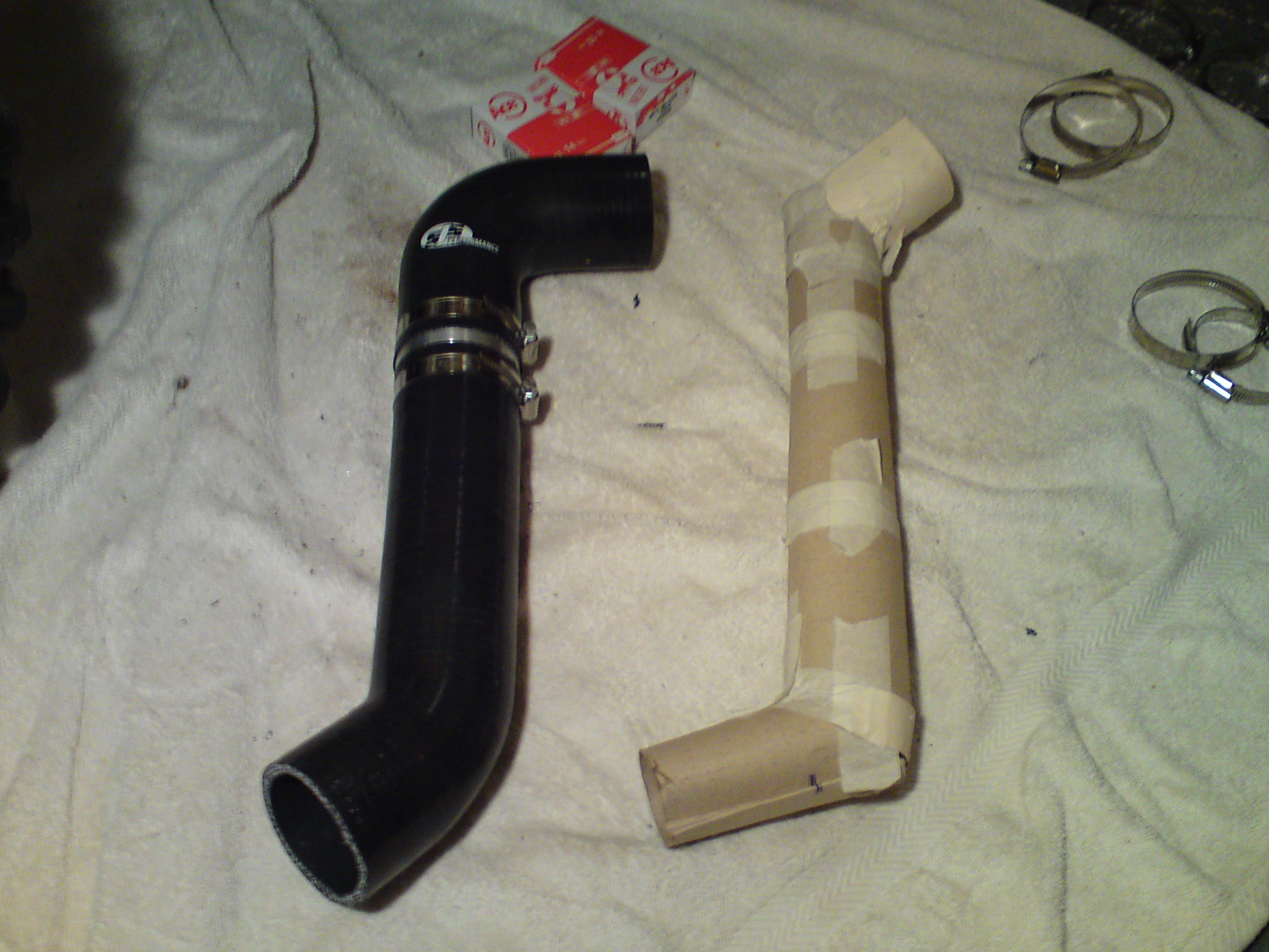

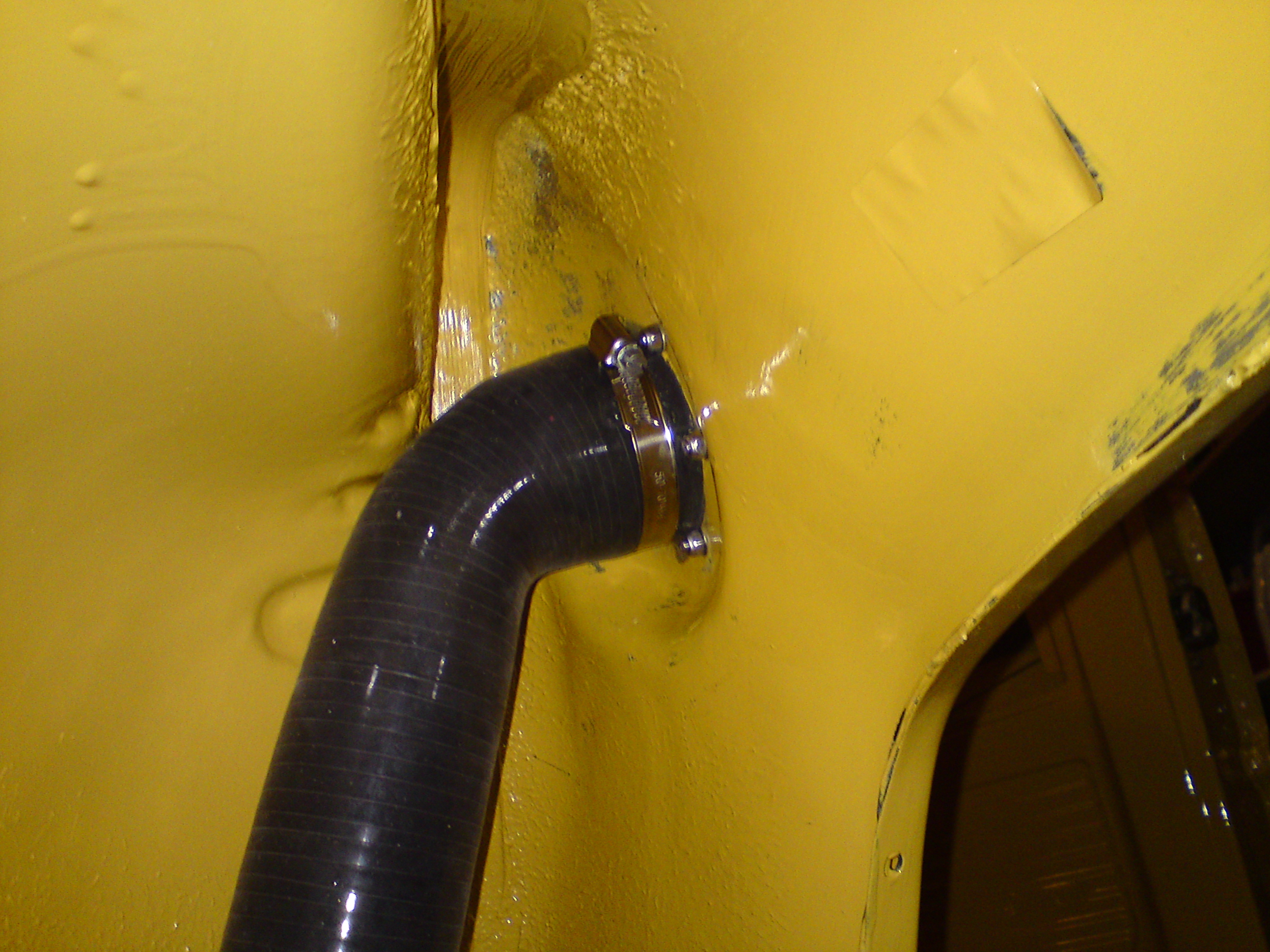

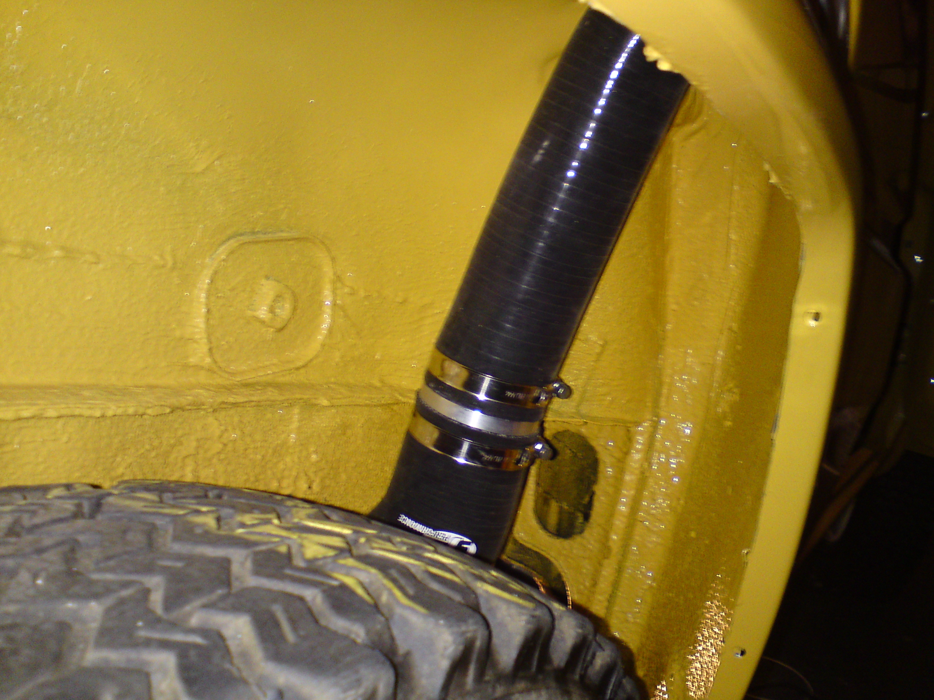

Well after months of fannying about, my tank is on with fuel lines and filler neck attached.
I've used the standard braided rubber fuel hose with an extra in-line paper filter and Stainless hose clips to prevent corrosion to the worm drives. (I find corroded worm drives on jubilees to be almost as annoying as Alan Carr! :bang:)
Also SfS finished my Fluro-lined Silicone filler hose and that fits well.
