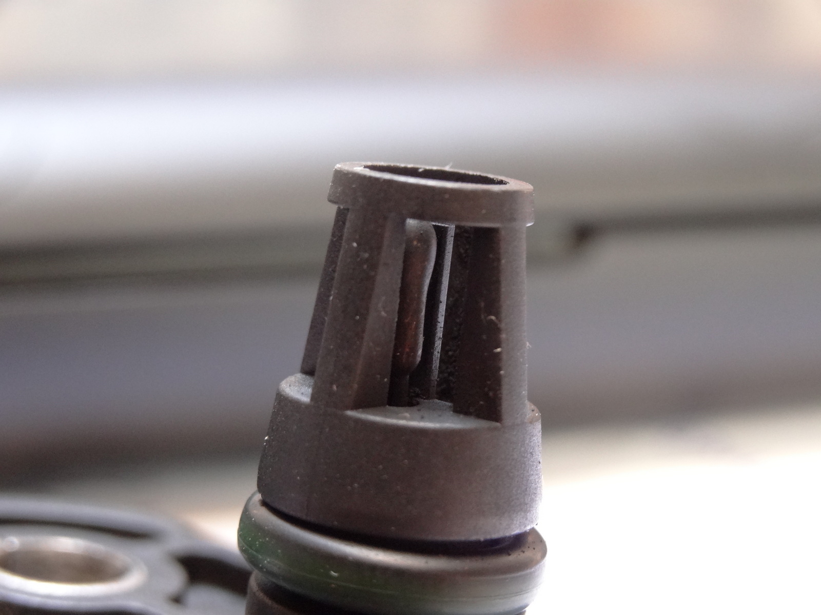

Next, pulled out the MAP sensor (just along from the EGR). It was covered in gunk....cleaned it up and put it back. Figures in MES looked OK.

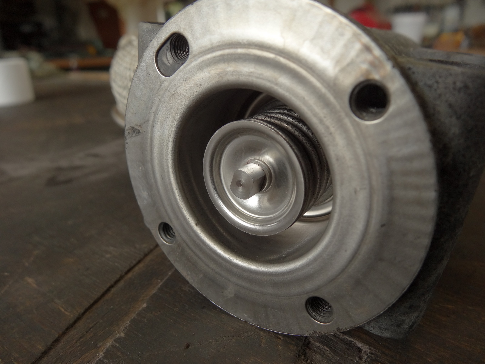

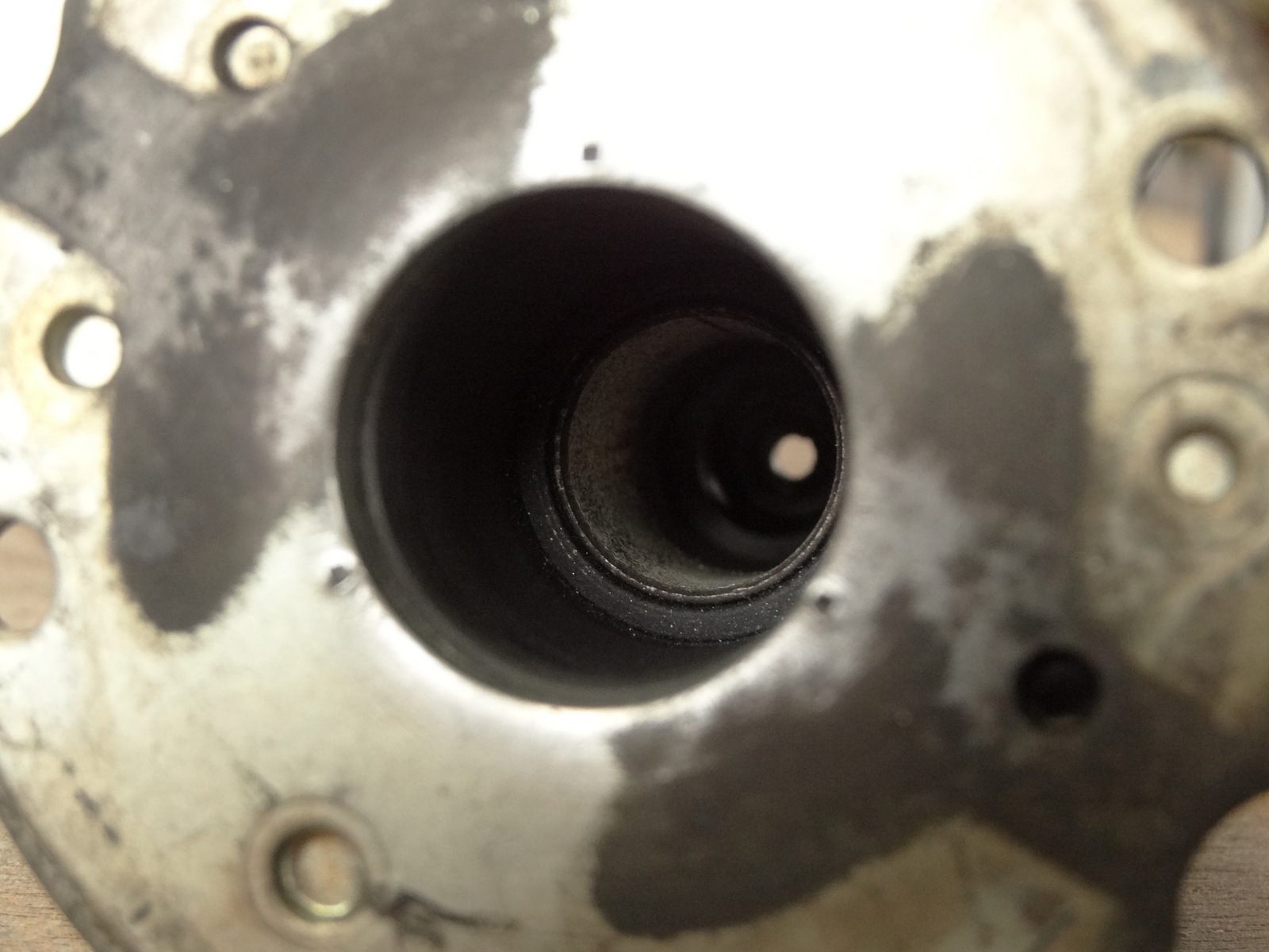

Whilst pondering on how to undo the bolts which hold the EGR to the inlet manifold I decided to undo the four M5 bolts which secure the solenoid to the main body of the EGR.....yup, the void next to the solenoid plate and the EGR body (where you can see the return spring) was full up with soot. On closer inspection the valve/spring assembly was quite free moving but the solenoid pin was pretty much stuck fast.
Finally worked out what was going on with the bolts. Well, they looked like M6 nuts on an M6 stud. Looking at them a bit closer from where you could just see the bored through tapped hole in the manifold it turns out that they were M8s with a 10mm (across the flats) head and a short bit of M6 thread stuck on the top.
What's that all that about then?
Any rate, got the EGR off and over to the bench.
I read somewhere to clean up the metal work with oven cleaner.....did this, amazing stuff....might even try it on the oven.
The solenoid pin should run in and out freely with little pressure against the spring within....it didn't. Tested with 12v battery...it just groaned.
Found and did this, how to get into the solenoid and get it working again: https://www.fiatforum.com/croma-ii/201645-egr-valve.html
Reassembled.....all now working fine. Tested with MES actuator. My guess is that this happens a lot and really these EGRs should be serviced occasionally.

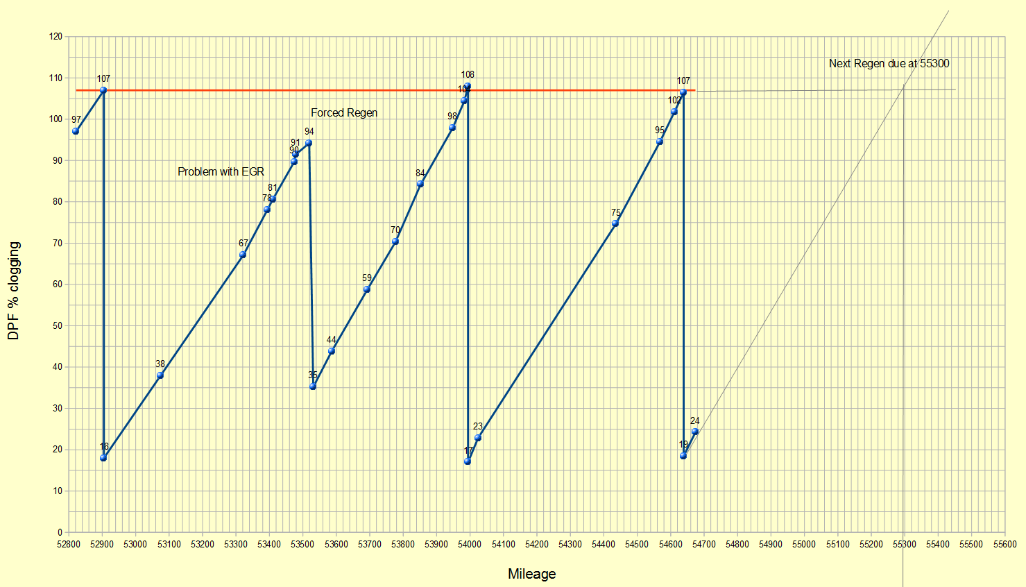

Well, it's a few months on and fingers are still crossed.
The problem with this sort of occurrence is that it makes one keep an eye on things...possibly too much. For me this has been monitoring the DPF to the extreme and plotting a graph of DPF clogging against mileage.
Quite interesting (how sad!)
Here it is:

Regen cycle looks about normal. My old 320D would regen between every 500-800 miles. That was with doing 22k a year.
Obviously keeping on top of things like regular oil changes (of the correct spec), clean EGR, and an intake with no boost leaks will ensure regens are kept to a minimum. A well maintained engine will ensure a happy DPF. One of the company fleet cars at work had nearly 200k on the clock, still on the original DPF and had no issues (was regularly serviced)
