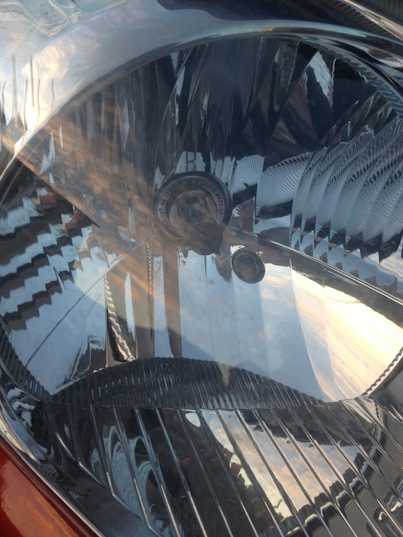

Ive got Bosch Head Light bulbs to give me some more beam at night and can't for the love of god figure out how to put them in?!?!
Opened up the bonnet and got scared lol! This might be more challenging than originally thought.
Really?
you just place them on the engine and your done, close the bonnet :devil:
I hope you have a big bright torch then as where I live when I finish work it is very dark and if you couldnt see anything in the daylight then looking in the dark isnt best advised lol.Cheeky, if you didn't have such a nice Orange GP I'd slap you with a fish lol!!!
I almost did what you advised though.
Got bulbs out
Opened bonnet
Poked around and let off a big SIGH
Closed bonnet
Left bulbs on front passenger seat
Going to have a go after work :idea:
Regards
Stephen
he has the bulbs on his seat they will light up the area up
but just incase your actually being serious here is some instructions
open your bonnet
locate the back of the headlights and you will see a rubber backing (circular in shape)
pull it off
and you will see a U shaped spring which you need to press and pull back (it'l be obiovous what you need to do)
pull the plug off the headlight (before or after the spring)
put new bulb in and perform the above in reverse![]()
I'm getting bullied on the GP Forum - moderators - wahhhhhh
Lol, cheers man for the heads up, will let you know how I get on.
Our place at work has a huge warehouse that lorries reverse into to load up, so will work under there for as long as it takes me - FYI I clock off at 5.30pm lol!![]()

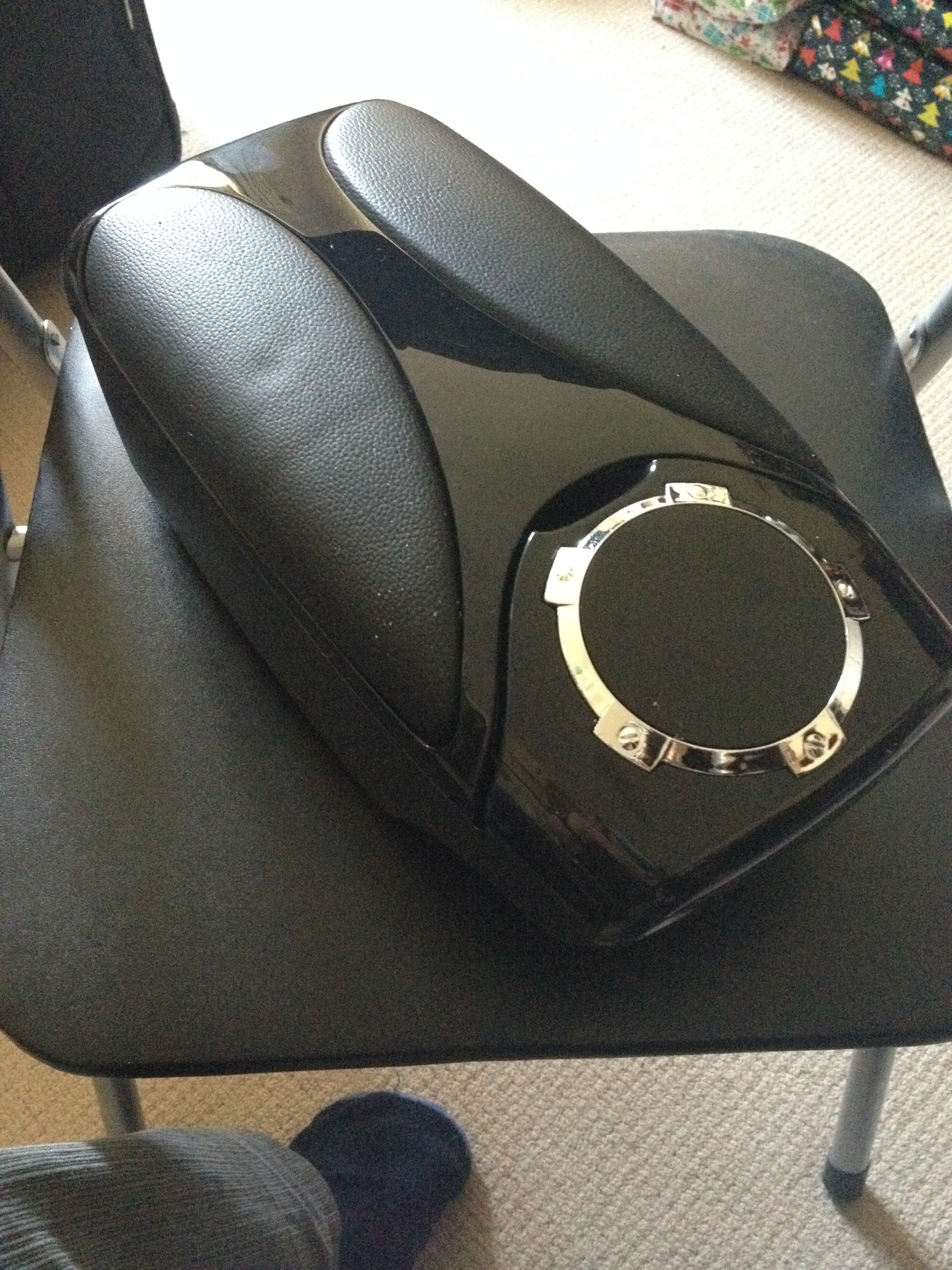

Looks nice I like the center console how much was it
UPDATE
CENTRE CONSOLE
Centre console went in, took like 10 mins to assemble and stick in.
Looks ACE...
...I've bought a FIAT badge online to put on that black circular part.

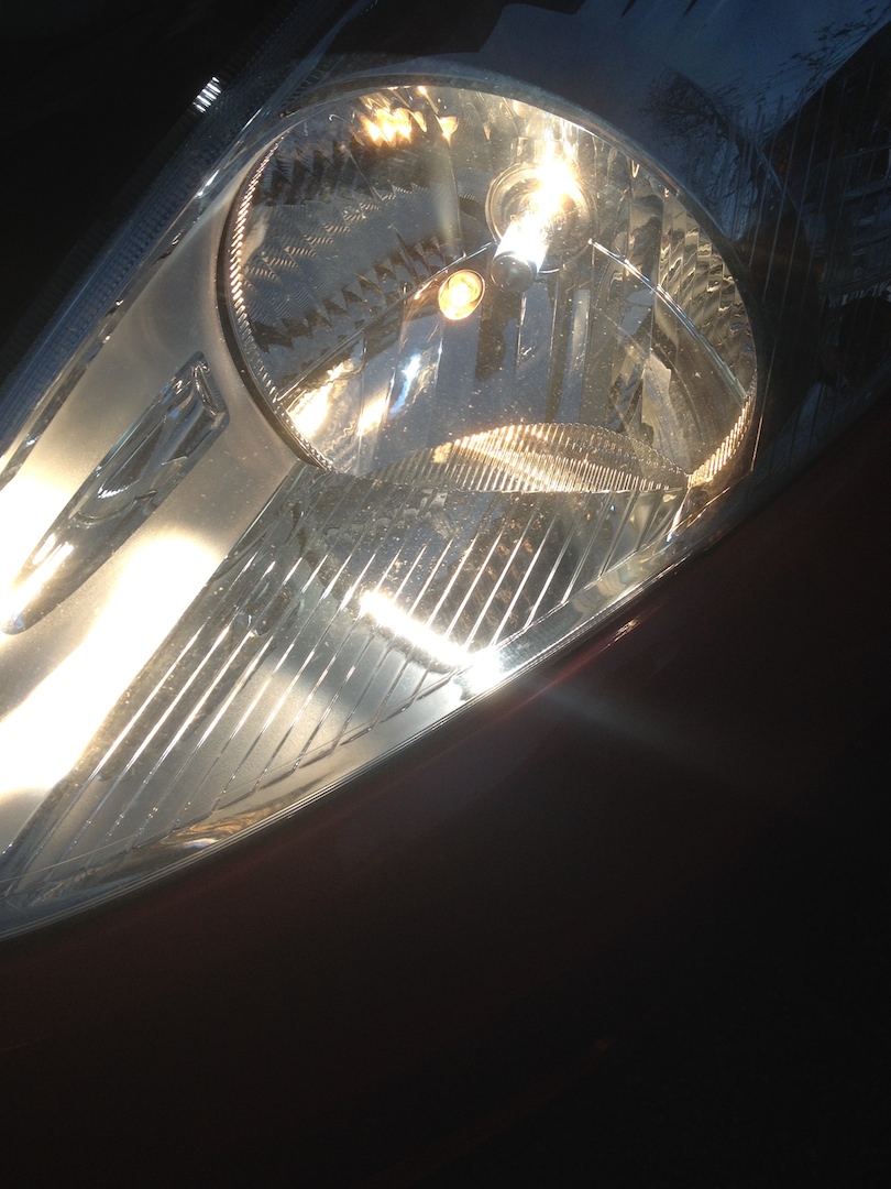

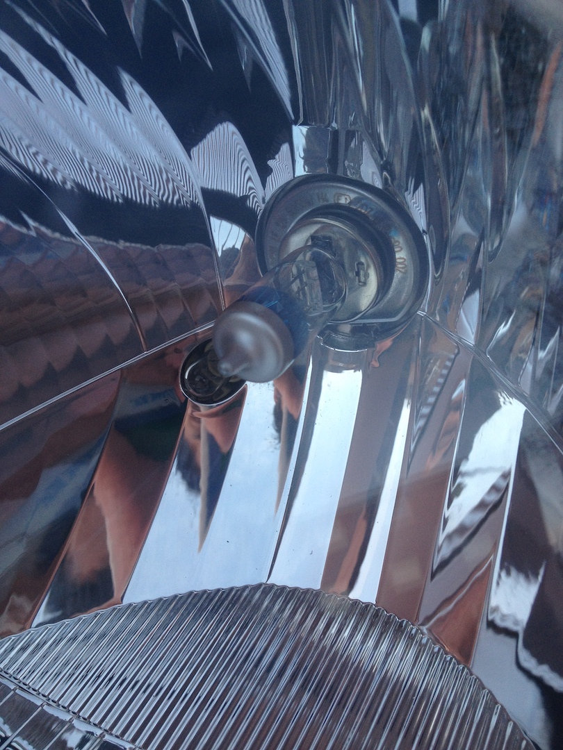

NEW BULBS
I've put in the Bosch bulbs that I bought finally, don't know why people found this hard on the forum, good guide on here that I followed! :slayer:
Only took maybe 20 mins for both of them.
So much brighter!!!!
HID's in the next year or so if I've got modding itchyness inside me lol!
