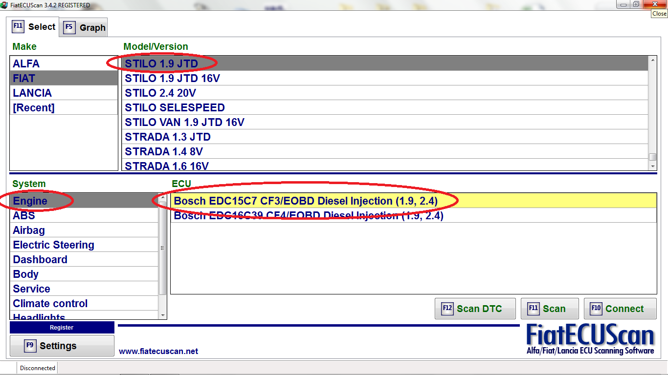

Just joining in this thread - boug a VAGCOM off ebay for 7.90, as pointed to by Shadeyman.
Gave me an ISO error on connecting, but still told me that my engine fault was due to a low signal on my MAF, which I will dry out if the fault re-occurs. Not sure why I got the ISO error though - I used the scan function to connect to the control unit it detected?

You must have selected the wrong car/ECU type.
Edit.
Yours is the Stilo JTD 8v(I think)?
This is what you should have selected(attached).

Will have another go tomorrow lunchtime, I guess... having said that, it cleared the fault, so no problems now.
I'm assuming that selecting the wrong control unit will have no affect on the VAGCOM cable's inability to reset the service indicator?
Selecting the wrong ECU type means certain options wont be available.
But you may need an EML to reset the service indicator.
