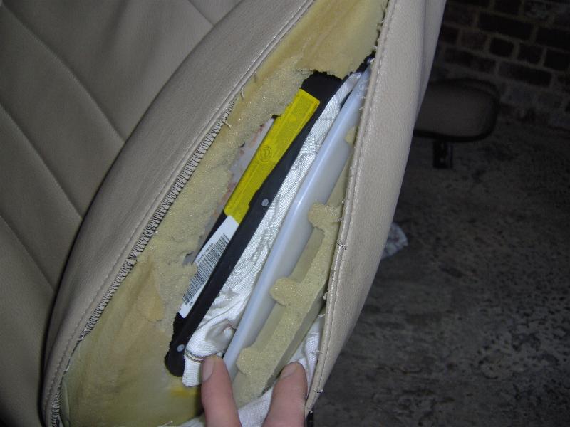

The orange ones on both sides are for the side airbags
My OCS is a white connector I think but yours may be different
Then there's the black one which is the "is seat belt fastened?" sensor
OCS is dealer only as far as I know, mind you get the seat base cushion as well. Perhaps you could get your passenger to chip in for it after all it's their brains and face that will be splattered all over the windshield if it doesn't work. I wonder if you'd be open to litigation if .....

Why does the wiring for the side airbags go into the seat ?
Cos that's where they are:)
