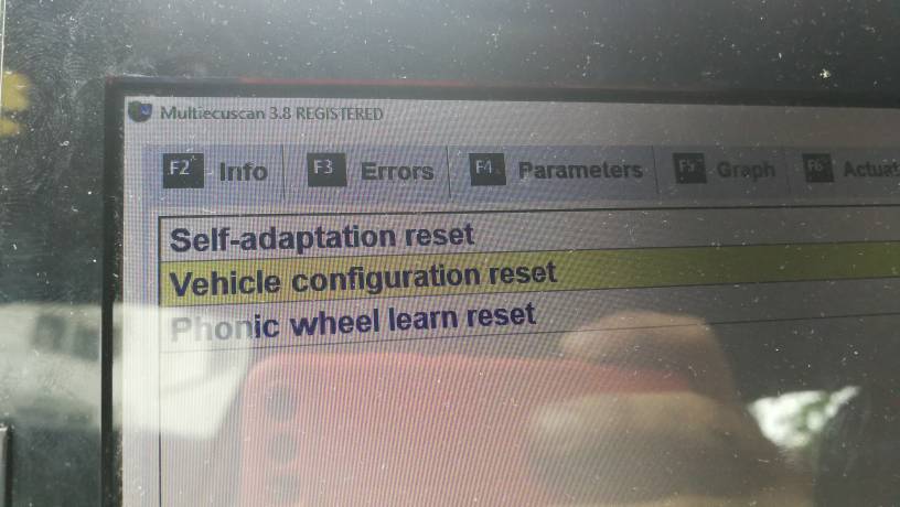

Hello friends, it works now 100%
It is done and now all work perfectly.
Just need Vehicle configuration reset through Multiecuscan ... just 15 seconds job.
Even though the Ecu T9 was virginize.. otherwise may Vehicle configuration reset is needed when changing from T1 to T9.
