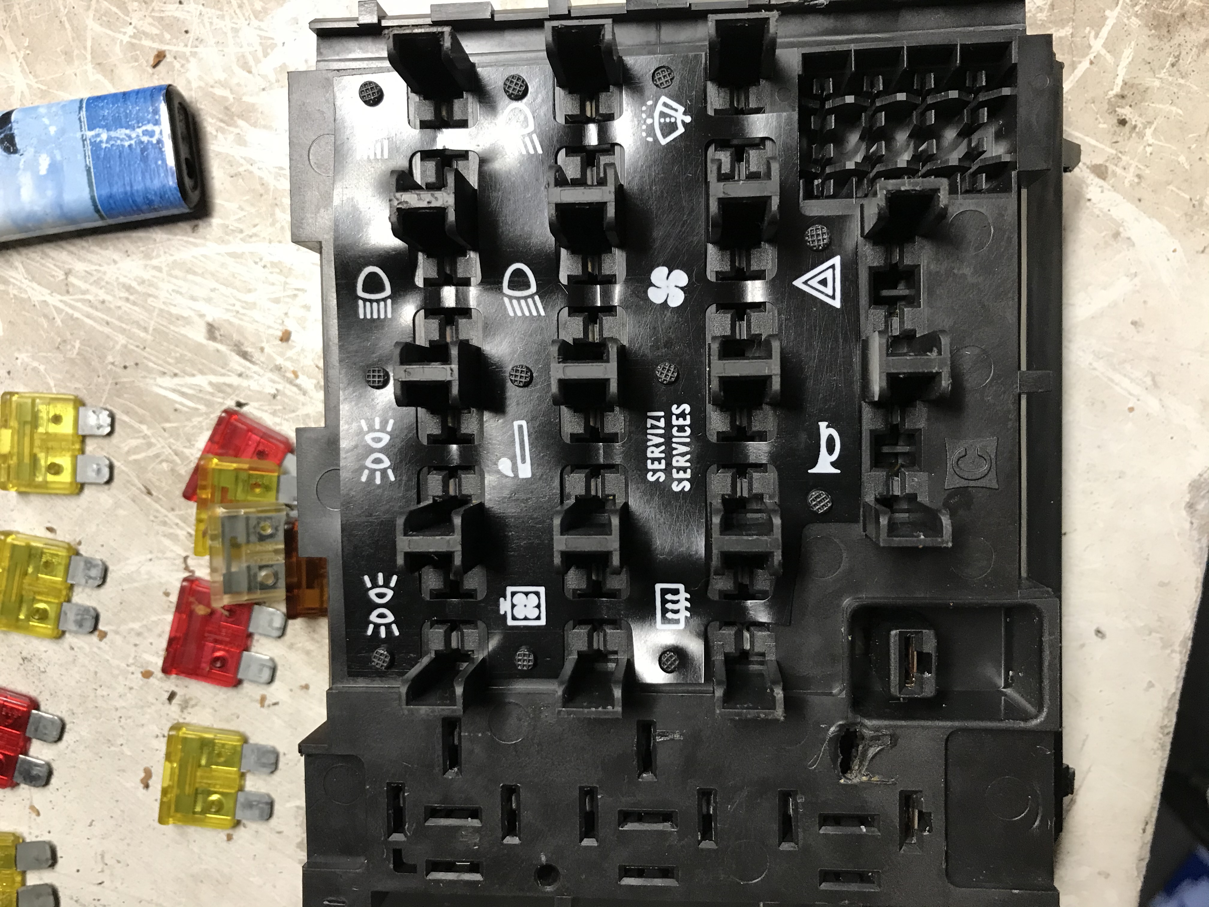

The problem is that when i turn ignition to on i can’t turn on any lights, only radio, and this is when i activate the choke. But when choke is off i can only turn on radio but nothing else! I checked the fuse box and i saw that one of the relays have been burned at one of the inputs. Could this cause this problem? Or what can

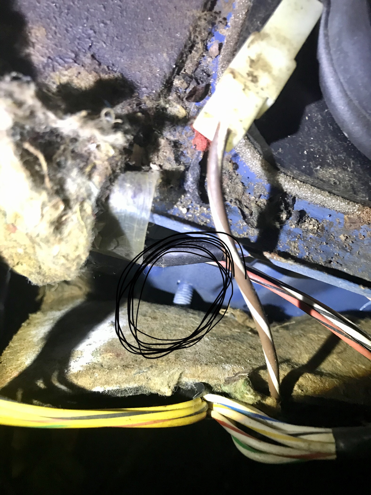

Used to be a commoon issue many years ago, that if the main earth cable failed, or the connections got poor, all engine electrics would find an earth through either the accelerator or choke cable, sometimes they'd get very hot during starting.
First thing I'd do is check the engine earth cable. Not just the end connections, but also for continuity along its length. Then check all other earths you can. Fiats of this era often had several little connectors bolted to the body, like an upside-down spider, to which many earths were connected. When these get dirty, current travels anywhere it can, giving interesting results.
Your relay damage could be a victim, or possible a cause. It will need fixing along with all the tedious connection checking.
Good luck with such a rare car, not seen one for a long time.
As portland_bill suggests poor earth can cause havoc.
This would be my starting point.
Should you need help finding the various earthing points then I can help but you first need to start with the main batter negative lead which goes down to the front chassis rail and then onto the engine block/gearbox. There is only this one main lead and all other earths are taken off "tag strips" and "earth posts" on the vehicle chassis.
If you can tell me what the relay number/position is that was burnt out then I can tell you what that relay was used for.

The relay that is burned out is the bottom one, it says 5H or H5
You can see it on the image i uploaded!
On the Ritmo/Strada 130TC then the relays (top to bottom - 1 to 3) on your fuse/junction box are:
1) Horn Relay
2) Heated Rear Windscreen Relay
3) Front and Rear Windscreen Wiper Relay Feeds
The above are all high current devices so makes sense.
If required I can check the earlier Ritmo 70/75/80 workshop manuals (would need to dig them out) but Strada/Ritmo base wiring from the main fuse/relay panel remained pretty much well unchanged. The later models just added relays/etc. wherever and whenever some other circuit was added to the base vehicle.

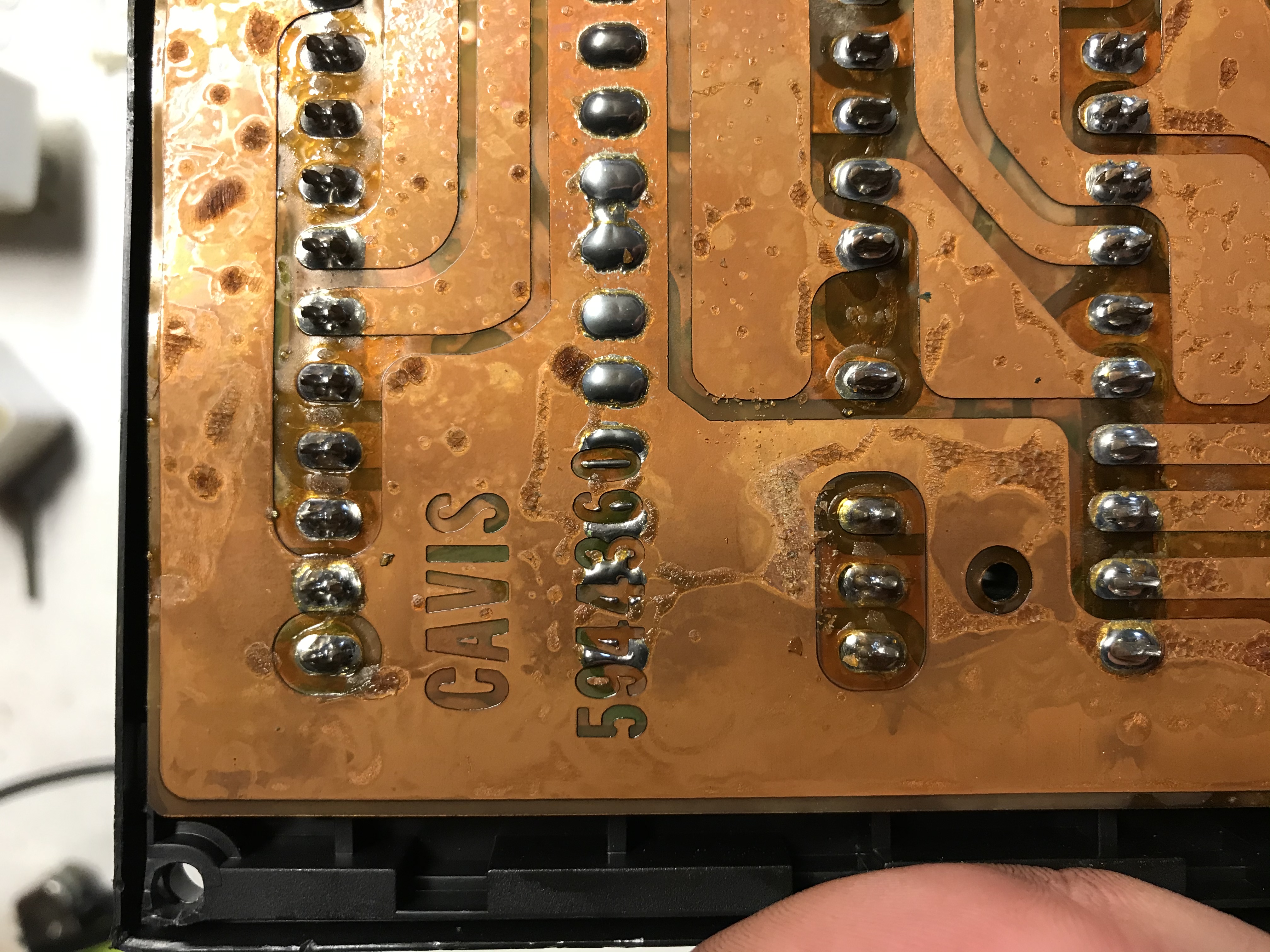

The choke cable will have two nero/black wires. One will go to ground/earth and the other to the dashboard choke light. When you pull the choke cable/switch the dashboard is finding it's earth bath via the choke light wiring.
The dashboard wiring connections are a known problem. Basically there is a flex circuit board system with the copper tracks going to the connector positions. As such the connector is not a normal "pin" type but the flex copper tracks go over a raised central ridge. The vehicle wiring connector consist of female opposing wiper contacts that slide over the flex tracks thus pinching the raised flex tracks.
The flex copper tracks tarnish/oxidise and need cleaning. Also the connector opposing female contacts can get separated and weak over time. The need to be check that they are close enough together that they will correctly pinch the flex circuit.

As im not English i have a little hard to understand you sadly. But i’ve tried to clean the connection on the wires that goes directly from the choke, but nothing happend. Maybe i need to change many of my wires ? Because some looked a bit “rusty”.

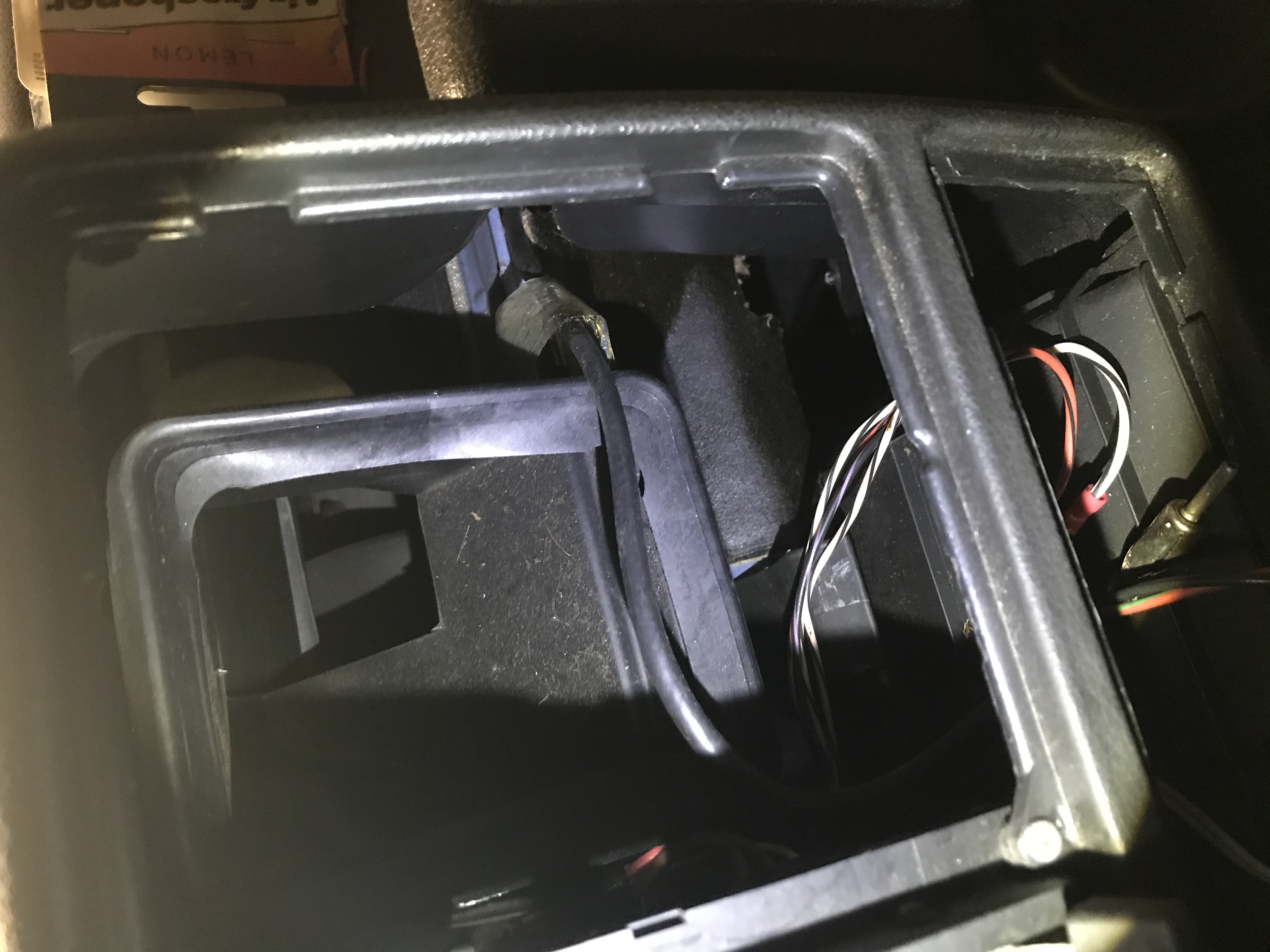

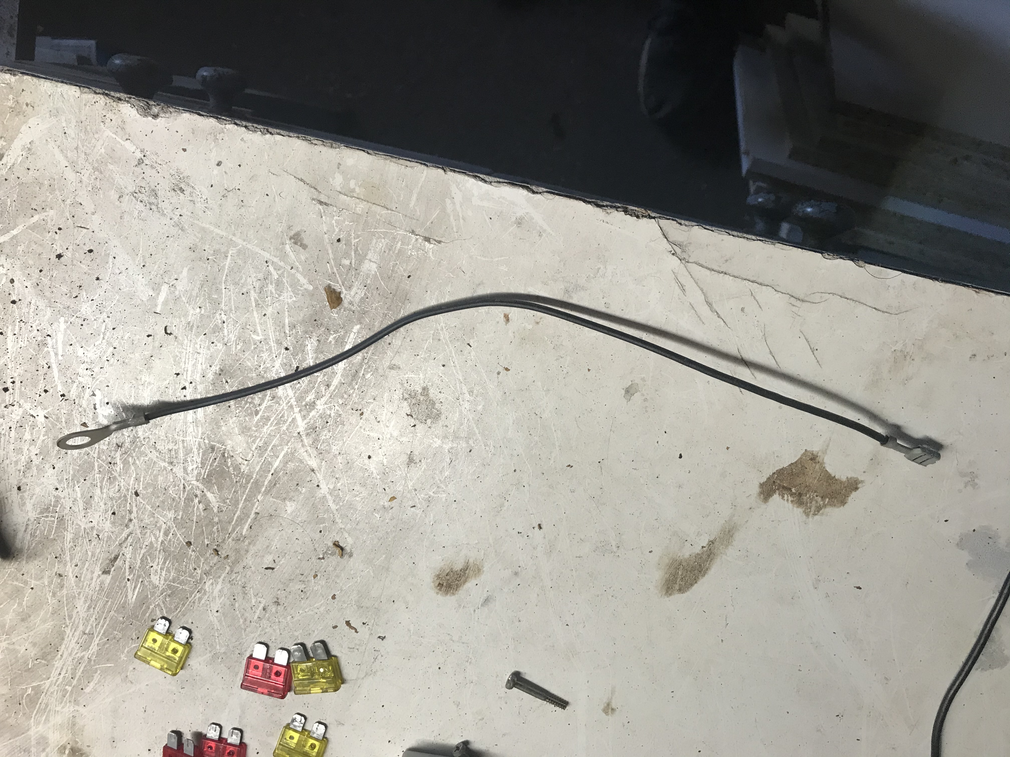

I also just found an earth cable hanging and not connected to anything? I’ve checked up on it but couldn’t finde where it should be and it’s not the radio. I’ve marked it with a black circle where it was sitting and the female pin was not connected anywhere

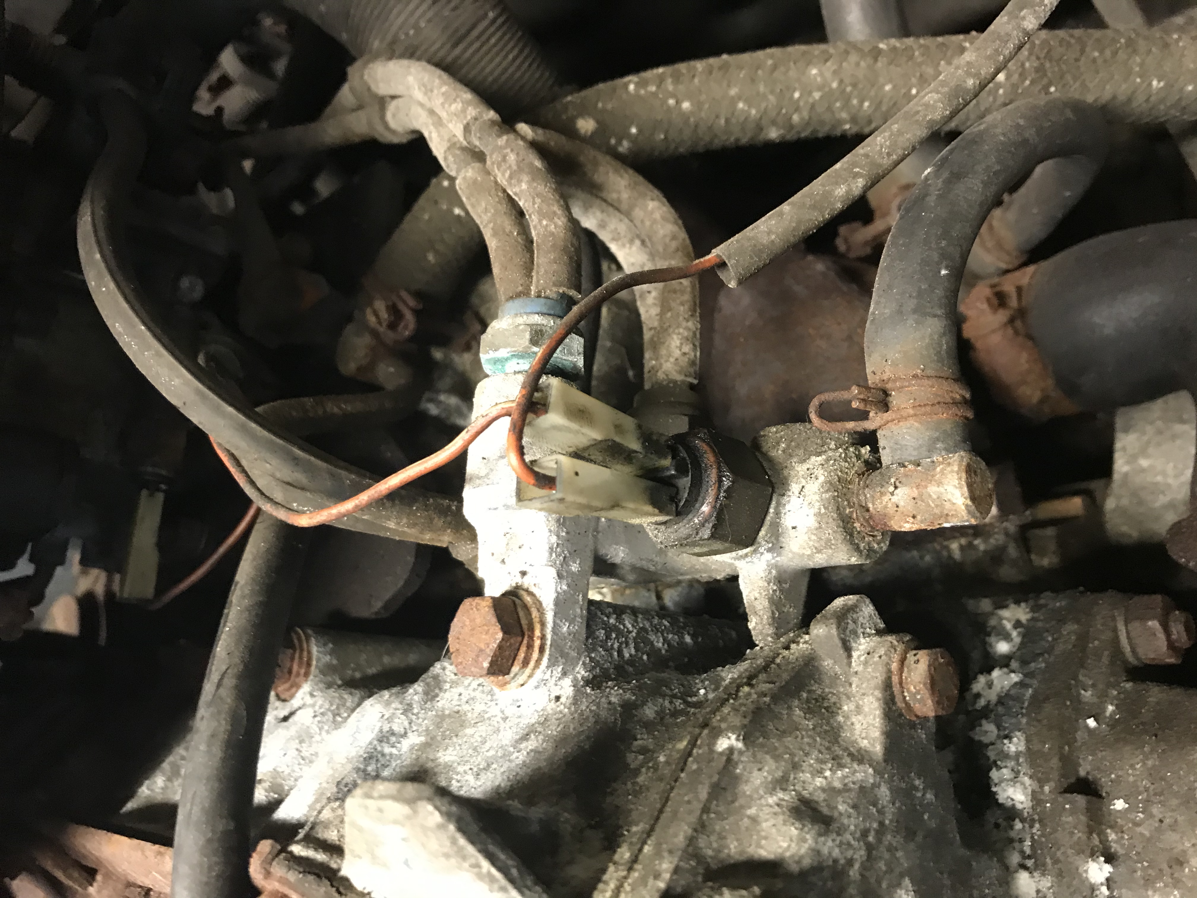

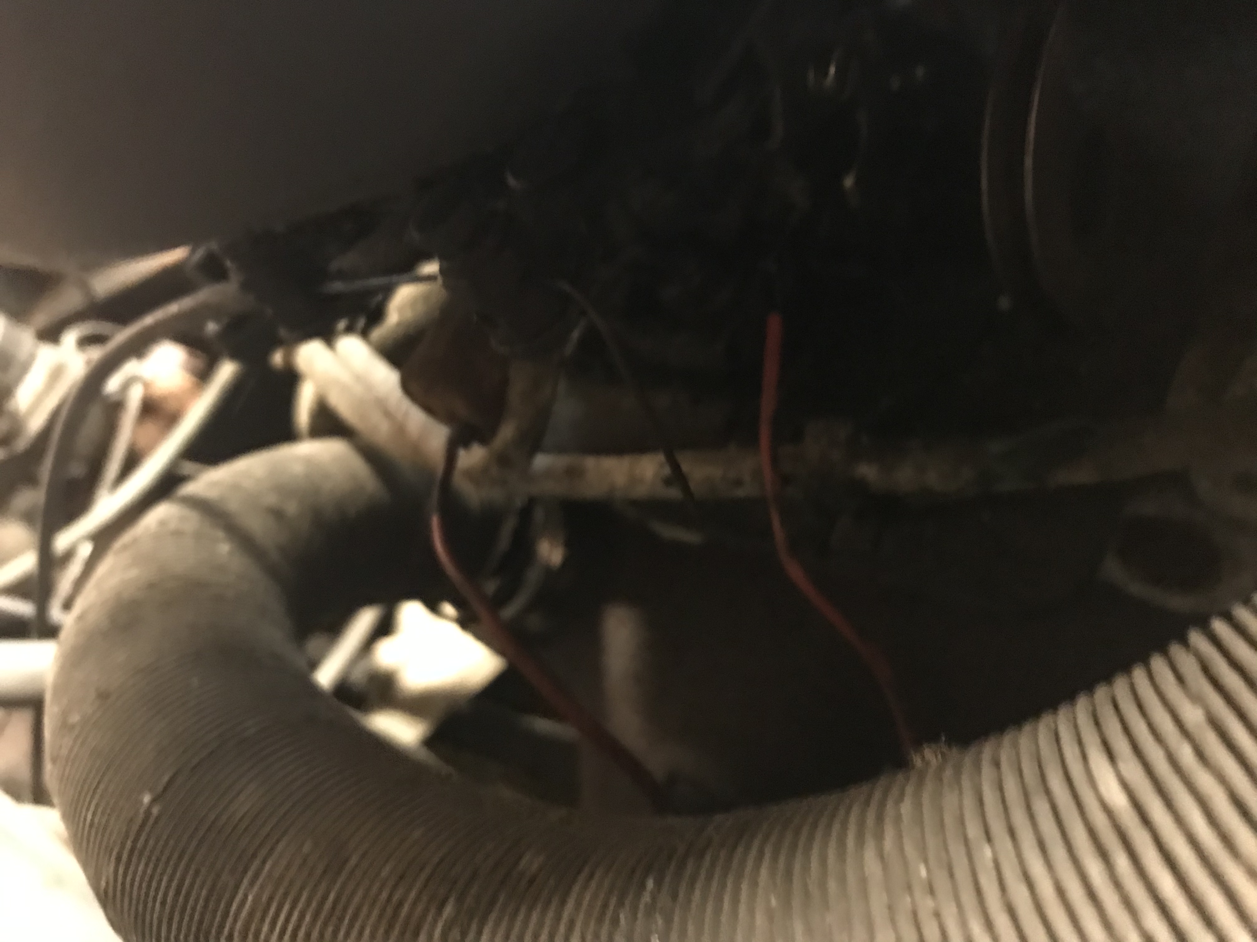

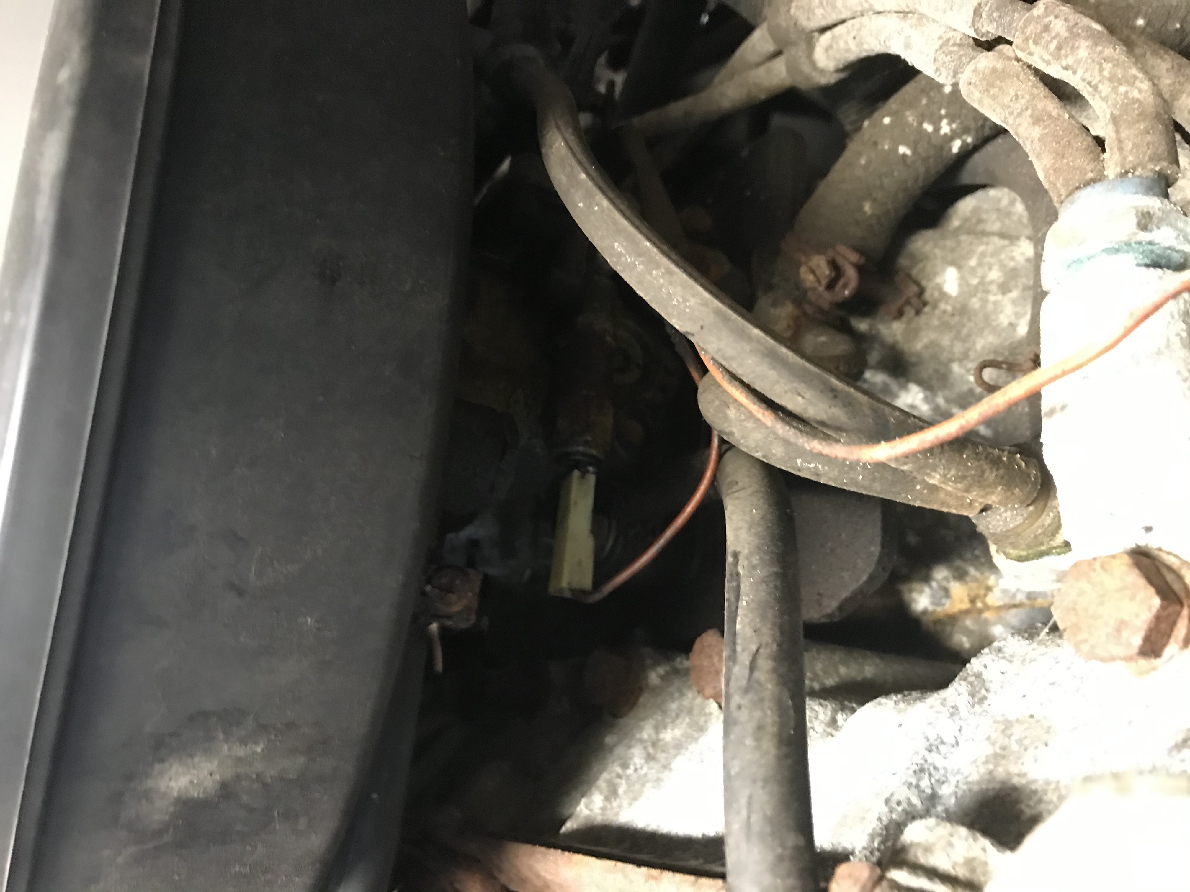

I also cleaned the wires connection that leads to caburator as shown on images.
