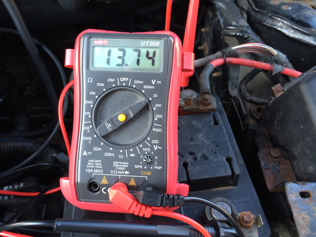

Yes checked all wires and all ok, just typical... Battery light comes on and goes out randomly and battery voltage goes back up to 13.8 for a few seconds then back to sub 12V... Me thinks a new alternator is needed. Shame because I wanted to take it out for a test drive but can't believe how heavy the steering is!

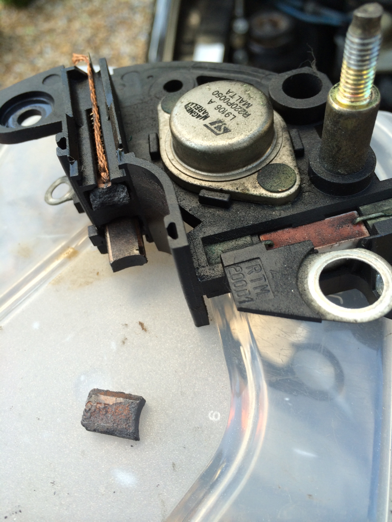

Took the plastic cover off the back of the alternator and tried to separate the case but it looks like the windings (red wires you can see through the vents) seem to poke through the bottom and are 'crimped' into the electrical components at the end (rectifier) so the case can't be separated... Can't find the article on repairing alternator / brushes can anyone help out on this?
Well I worked out how to get the brushes out and I think I found my problem
Just need to locate some replacements, they measure 15mm long x 4.5mm x 7 mm.
New brushes £3.00 inc delivery happy days ;-)

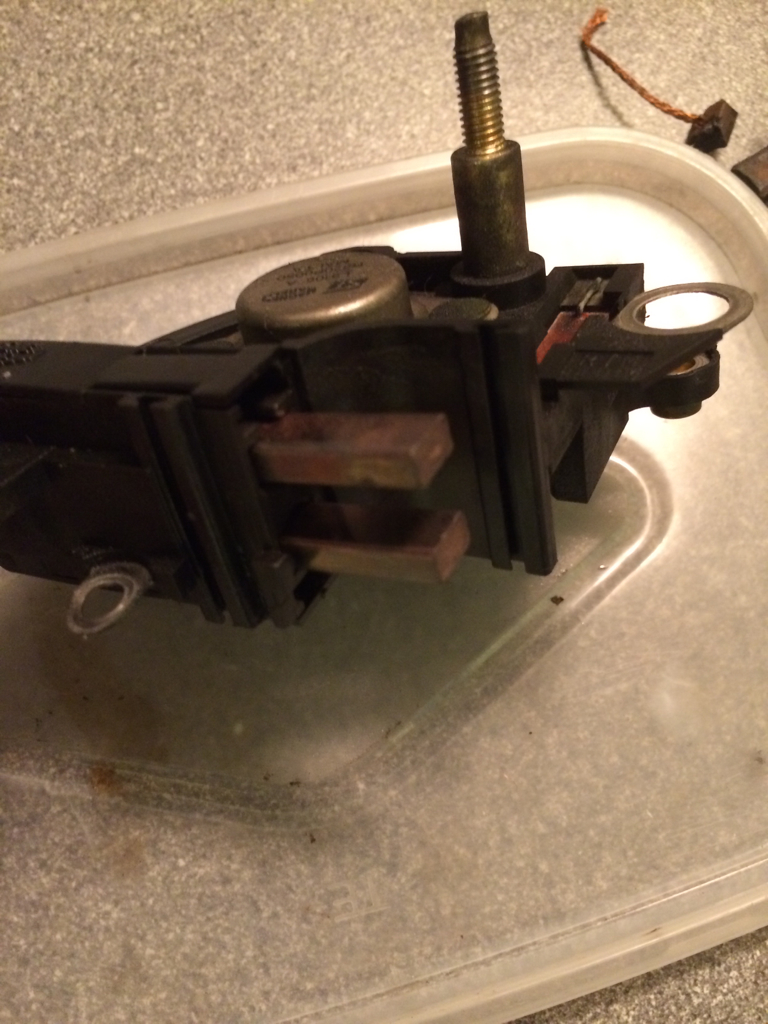

Old brushes well knackered
Job done ;-)
Just saved £90 for new alternator

Might be at 13.8 because the battery ran flat a couple of times?
