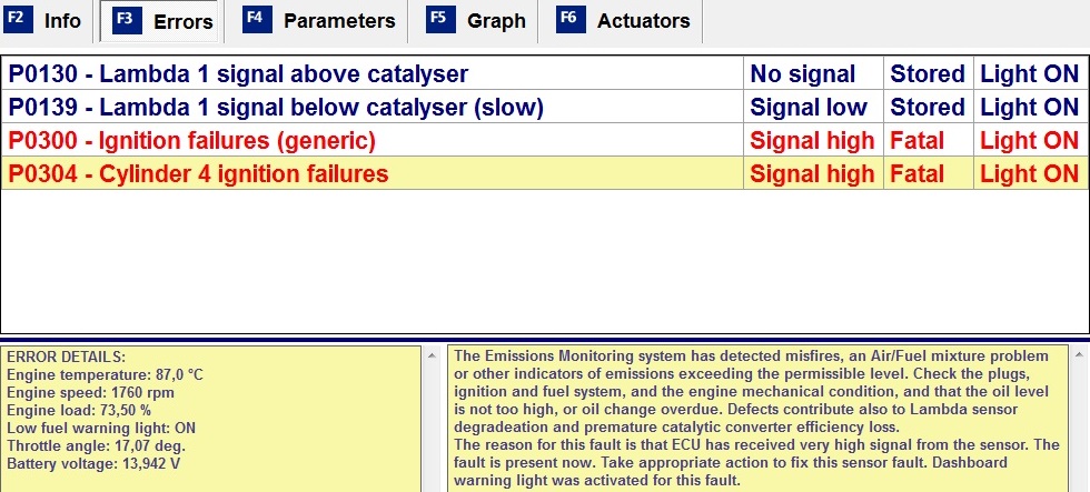

I scanned the for fault codes with Multiecuscan
So the misfire is on cylinder 4... ok that's something new... I was expecting cylinder #1.

Your mes screen shot shows no signal from pre cat lambda sensor.......
That could be significant . Does the error come back if erased?
