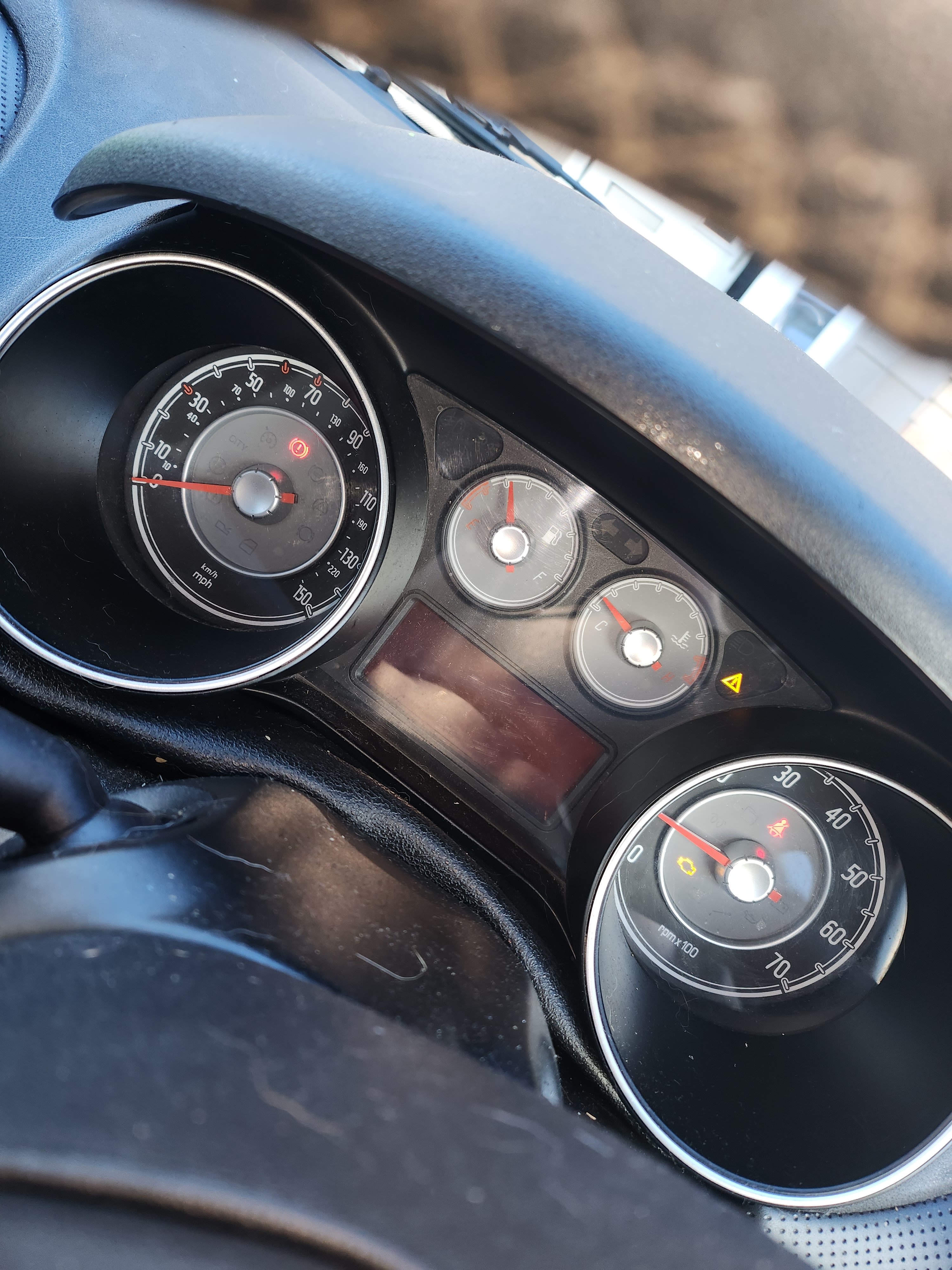

Fiat Punto Evo no Display worked before I took it to a local mechanic is this his fault or just bad timing
Why was it with the mechanic..
What work was done?
New clutch handbrake and exhaust it also has a check engine light he gave up on I'm taking it to fiat to look at the check engine light cause it failed mot because the check engine light but before I took it to garage dash was working
Really silly question but have you checked the fuses, it’s likely when at the garage they would have taken the battery off and putting the battery on again, or if they did any welding on the exhaust, it’s possible they could have blown fuses.
Once the dash is working again then you’ll need the ECU to be read to see what is causing the engine light
