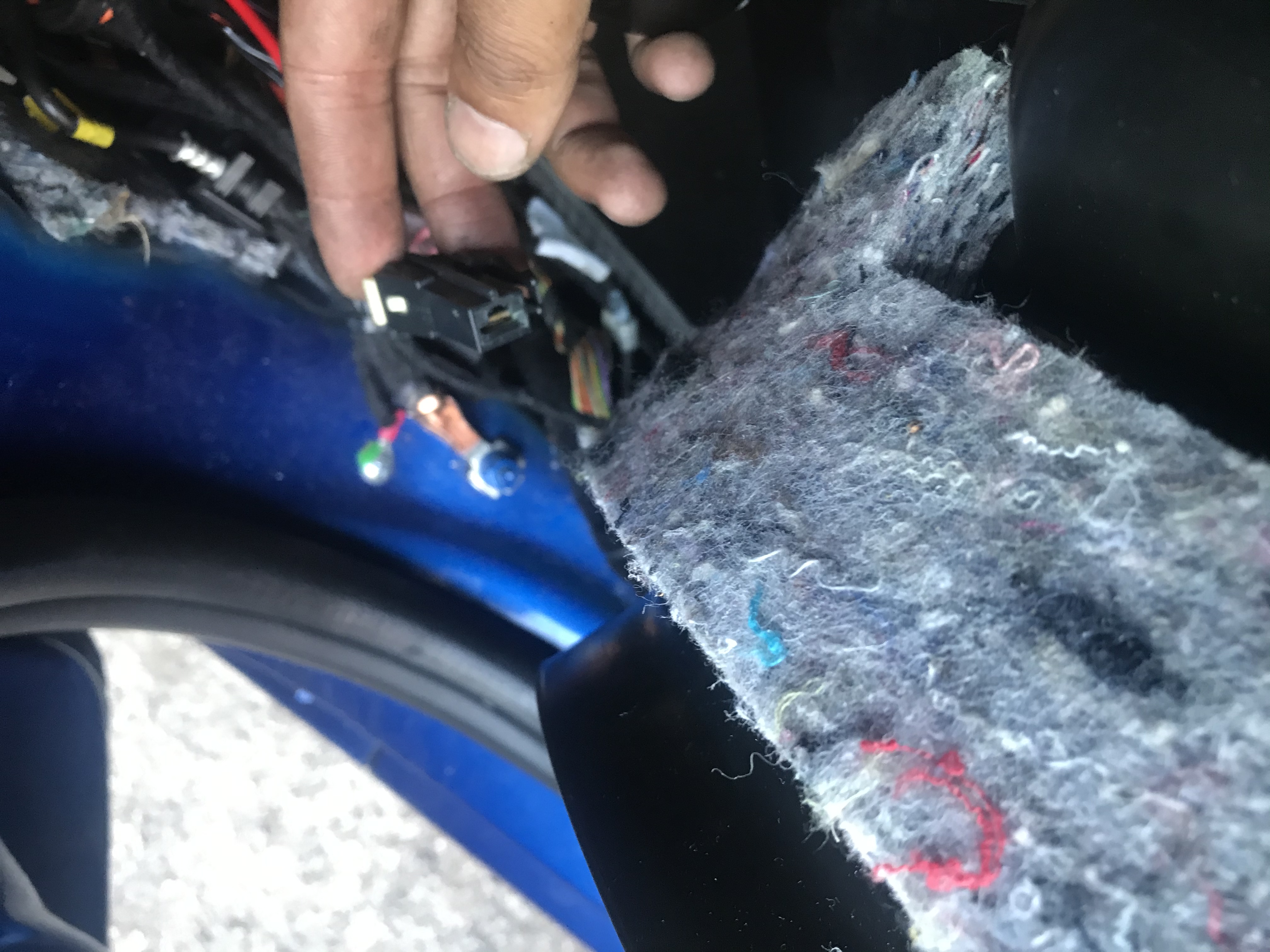

Hi all new to the group thanks for the add
My punto no start no crank I have an error on dash. Battery is good and had that checked. I had a look at wiring and seems ok and checked passenger footwell can see a connector but carnt find anything to plug it into maybe supposed to be like that. Any ideas guys based im based in Birmingham. Checked fuel pump fuse seems ok. Alternatively any indie in or around Birmingham have a look at it?

Have you tried resetting the fuel cut off?
This should be the procedure
To reset car operation, follow this procedure:
turn the ignition key to MAR;
activate the right-hand indicator;
deactivate the right-hand indicator;
activate the left-hand indicator;
deactivate the left-hand indicator;
turn the ignition key to STOP
