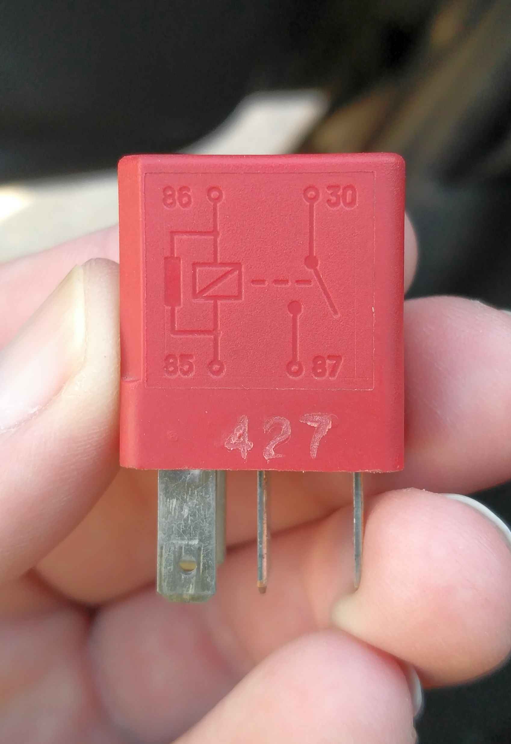

sorry i got that relay wrong. you dont have t10 so you want relay t09 which is the red relay nearest the headlight.
I tried fiddling with that relay, the problem is those terminals are quite narrow and I had trouble shorting the pins. I ended up using narrow tweezers, there were some sparks, but the pump wouldn't be heard with ignition on.
I also tried inserting the relay in there and lifting it just a little bit and then shorted the pins on the relay itself, but still nothing.

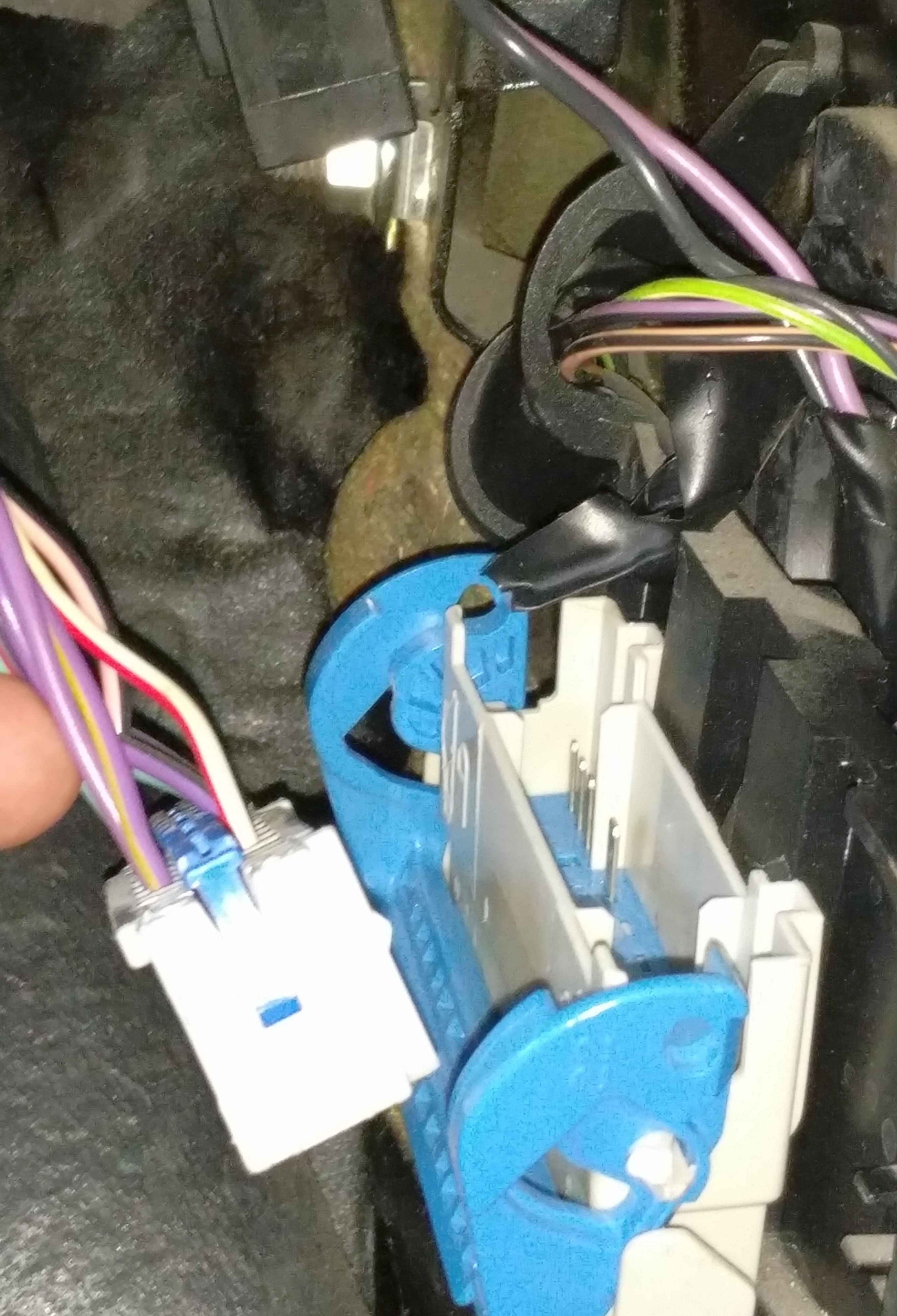

You've found the ignition switch, you could try disconnecting that, and joining the relevant wires together to put ignition on, and start function. (You'll need a wiring diagram). That would make known good connections, and prove whether the actual ignition switch has poor contacts inside. You will need the key in the ignition switch to be read by the immobiliser, and to unlock the steering.
OK, this is the situation. On the back of the lock I have two three pin connectors. I'll do a little diagram here.

When I turn ignition on, there is a short between 1 and 4.
When I crank the engine, there is a short between 1 and 2 and 1 and 3. I tried shorting these pins individually, and I did it over my ampmeter. It measured some 5A on both occasions, but the starter was nowhere to be heard. At first I though I fried something, but things turned out OK.
A short recap. After fiddling with that relay, ignition started acting almost normal again. I tried turning ignition on good 15 times, started the engine a few times, it worked perfectly. Probably till tomorrow. I just can't eliminate anything, can I?

For the ignition switch you need a wiring diagram that shows which wire goes where. I might be able to look at the Panda one, but not until Friday.

I believe I shorted the correct pins on the relay.
As per this schematics, the two pins on the right are feeding the pump, the two on the left are control pins. I shorted the right pins. Also, I tried repeating this operation a bit earlier with my ampmeter. I measured some 3.5A through the short connection, but the pump didn't turn on. I also measured some 12.5V on these pins.
To make things perfectly clear: I turned the ignition on, the pump didn't operate. I removed the relay and shorted the two pins. Confirmed that I did have a short connection by measuring the current through it. The pump did not operate. I did all of this on the T9 relay, which is the red relay on the left side, in the middle.

OK, firstly a correction regarding the pump.
Now I tried to short the relay both with ignition on and off and in both cases the pump operates. I measure 3.5A and 12V on the relay pins and the pump operates. Earlier today there was a match on and probably a bit too much background noise so I didn't hear it working. Yesterday, however, I did the same thing and it didn't work and I did have the assistance of my brother who was sitting in the car listening for the pump.
Either way, the pump checks out.

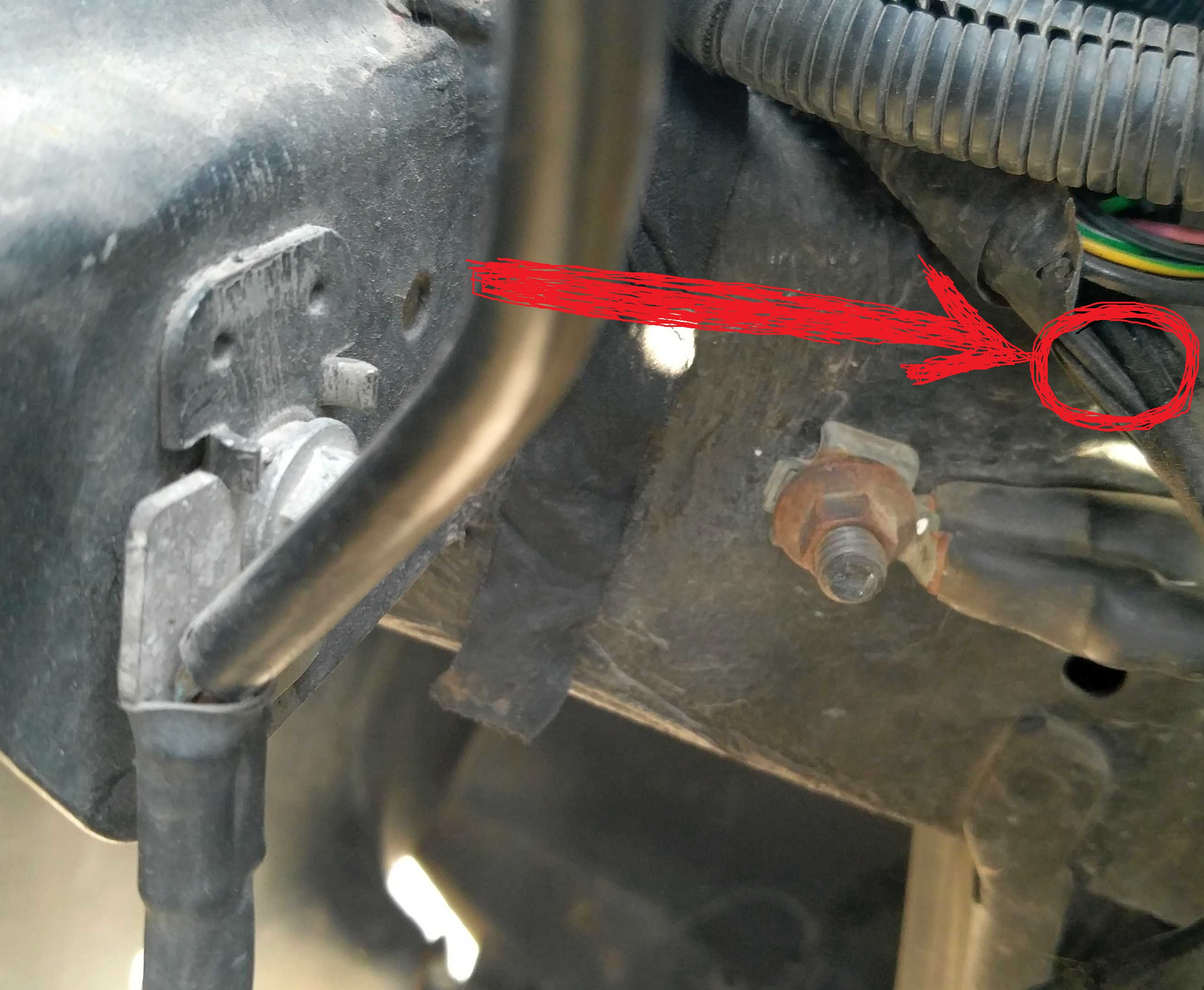

Most likely you have a bad earth to the pump and to other items. where on my car a bundle of about ten black earths go to the front of the car as already shown.
Assuming the pump in its circuit has only the battery, that relay and maybe some electronics on the pump itself, if closing the circuit does not start the pump one would have to assume that the battery is dead (which it isn't) or the pump is dead (which due to the intermittent nature of the issue I assume is not; assuming the pump has an impeller I guess it could get mechanically stuck periodically) or something is wrong with the electronic circuitry (if any) on the pump or the circuit is not closed.
Assuming the latter is the most probable and obvious cause, it boils down to having a loose wire or a bad contact on some of the connectors or a weak ground. In the latter case, I'm left right where I was stuck before, unable to locate the spot to which the pump is grounded.
This being the probable cause and with that ground connection looking the way it's looking on my car, how would I go around fixing the problem?
The best I can tell, this ground is affixed to a factory mounted screw which was probably welded on the inner side of that profile. There is some corrosion on this screw. Also, there is actually a second screw, just like it on the left side of the car, quite symmetrical, which is used like a mount for something, I can't recall what it was right now. This car may have had a ground box like the one on your pictures which was "lost" and the "repair guys" used the screw (to which something may have been mounted) as ground.

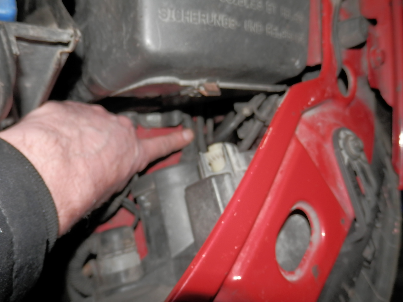

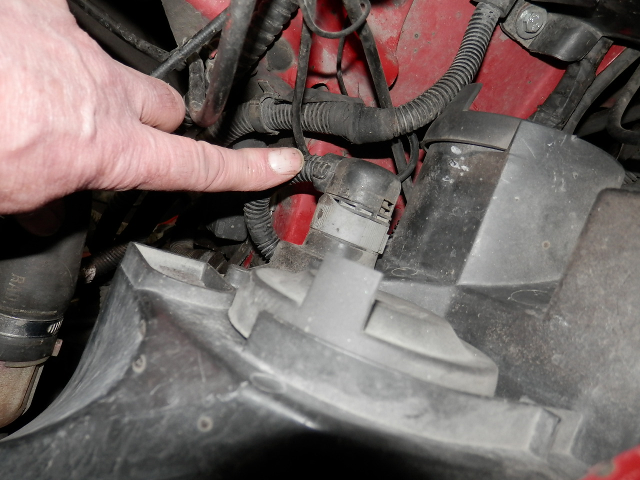

On one of your pictures of your earths at the front of your car you can see a bundle of many black wires. I am guessing that is the same bunch of wires that goes to my earth block.
I will check on my car.
How hard can this be?
:slayer:
On my car it appears the headlight earths and the other earths for the pump etc are all going to the same location at the front of the car in that black box which is bolted to the car near the battery.
The pump and other earth wires reach the front of the car by travelling under the engine fuse box.
Two bundles of wires exit the engine fuse box at the very bottom of the fuse box plastic. One is for the radiator. The only other is a single bundle for the earths and headlight wires. So it is quite easy to work out which wires go where from the fusebox towards the front of the car.
After leaving the bottom of the fusebox, the headlight positive wires, and the earth wires all exit the main bundle in only one location where the main bundle divides into 1. earths 2. left hand headlight positives and 3 right hand headlights positives.
The headlight earths must be using the same earths as the fuel pump heater motor and so forth.

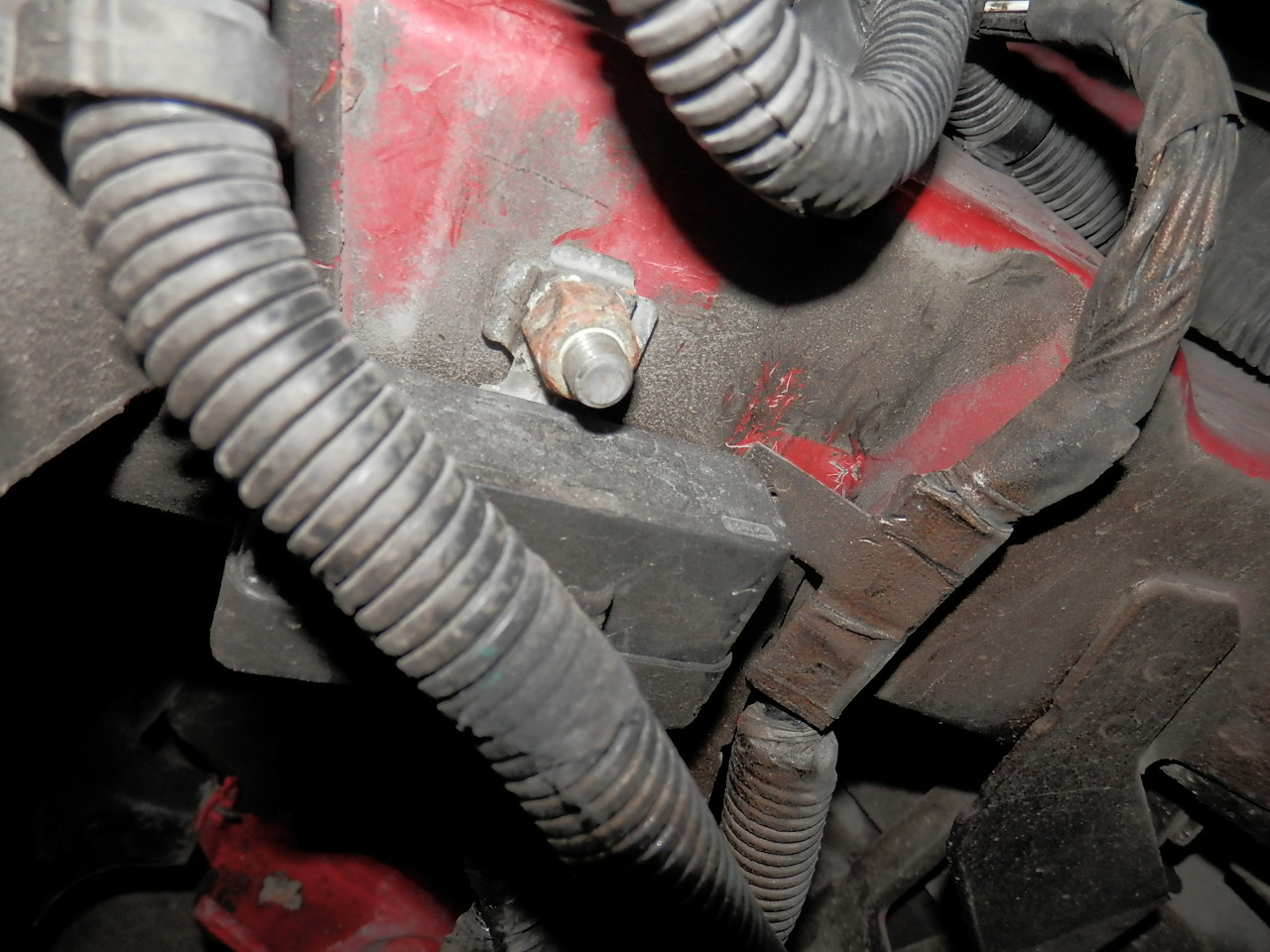

comparing my earth picture to yours.
1. In your picture those black wires are your earth wires.
2. In my photos the wires going from the join in the cables and heading downwards are my earth wires.

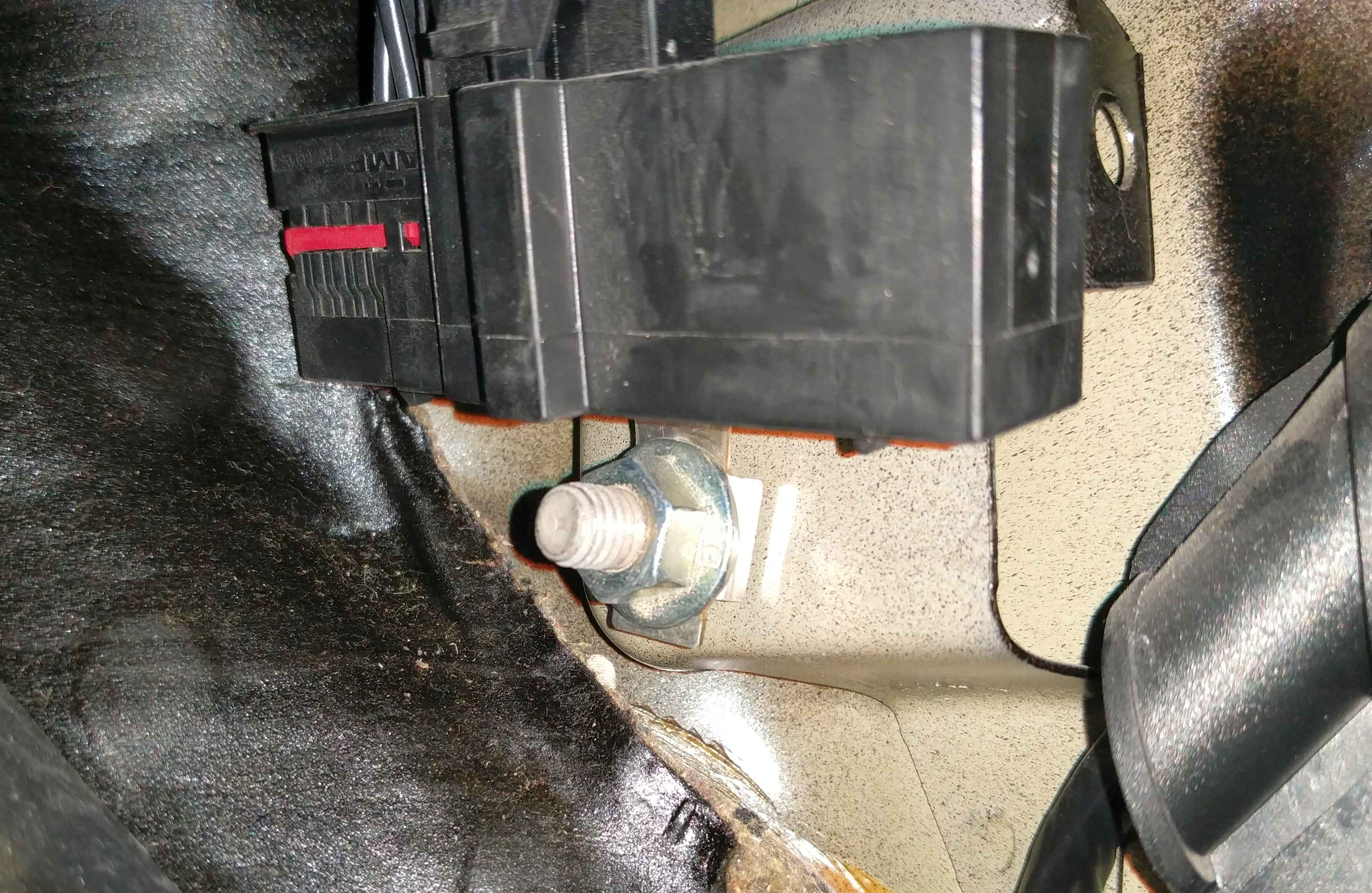

There are no electronics for the fuel pump. When the engine is running the pump runs continuously.
On a left hand drive car, the pump earth goes to the impact switch under the glove box just under the carpet at the top. So you pull back the carpet slightly where it goes up the side of the car and reaches the glove box nearest to the outside of the car and you see it there. I think I am right saying a purple comes from the pump and a black goes from the impact switch to the earth block at the front of the car. Again from memory the pump positive is purple yellow.
Just assume you have one fault and fix the pump first. If you run a good earth wire to the impact switch you are likely to solve your other problems - at least as far as starting goes when you are not using many other devices. The pump earth is probably a ten amp cable - fairly thick. Your other devices will get an earth via the pump earth back to where they are all connected.

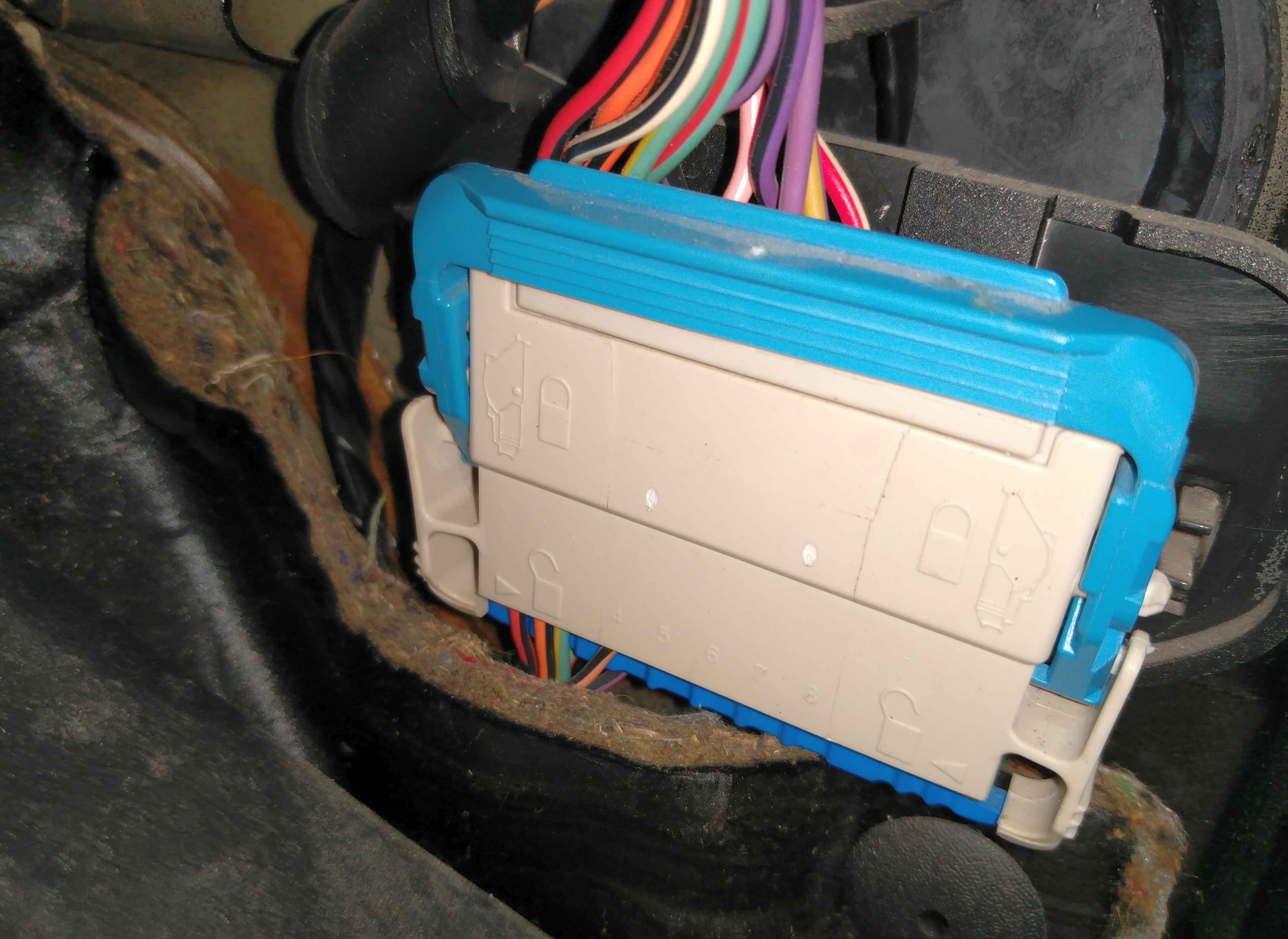

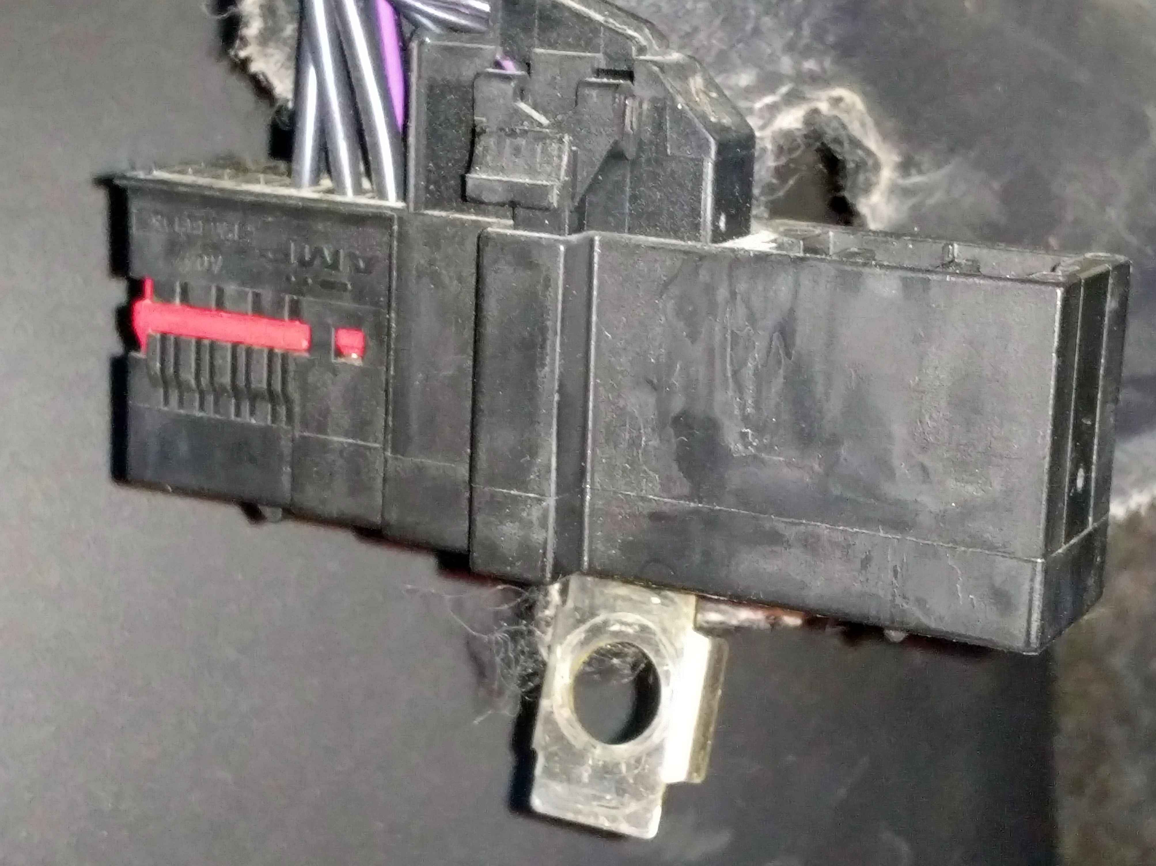

Just as you stated, this it's right below the glove box, behind the carpet to the side. There's this large connector to which I see that yellow-purple wire from the pump seems to be connected. The bottom two pictures seem to show one of them sought after ground boxes. I'm not sure whether or not this is supposed to replace the one that was (previously?) located under the hood, but it's evident that this is a far better location to have a ground connection. It seems very clean.
Much to my surprise, the fricken nut was loose, I could undo it with my bare hands. The connection must have been very poor indeed. I tightened the nut and the car seemed to work OK the half a dozen of times I turned the ignition on, but I'll obviously just have to wait and see. The only constant is change.
Some progress indeed!
You are not showing that fuel cut off (impact) switch, but you can see the black and purple wires for it in one of your pictures in the top right hand corner.
