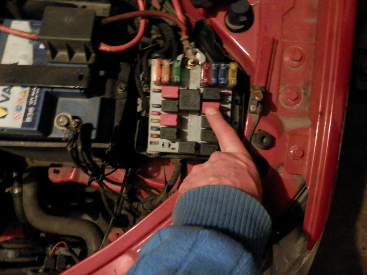

The pump is under the rear seat. The fuel pump relay is the red relay nearest the wing in the engine fuse box. If you remove the relay and bridge the large connections in the fuse box which are normally under the relay the pump should run. There is a continuous positive wire from the relay connections to the fuel pump. The earth for the pump goes via an impact switch just inside the carpet in the passenger area under the glove box. So if you turn on the car and the pump does not run you can test these connections to isolate the problem. An ECU/ECU Earth problem or wiring connection that impacts the ECU will be isolated if the pump runs with the relay bridged but it does not run for a few seconds when you first turn on the ignition.

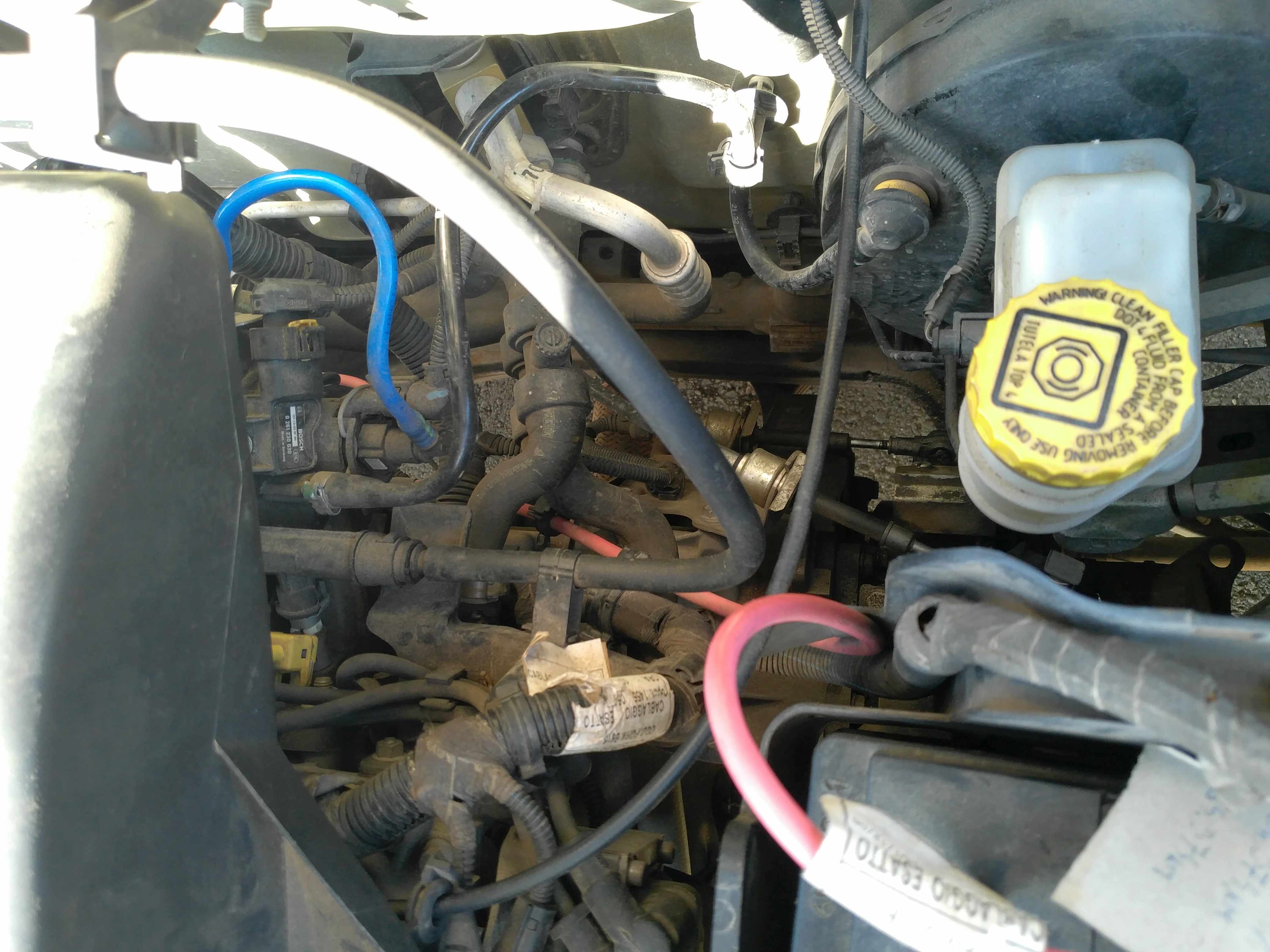

There is a big wad of wires coming from the cockpit. It splits three ways; part of the wires goes toward the fuse box, part goes toward headlights and the last part is connected to the servo pump, or whatever that is. One of those large connectors is coming from the cockpit, the other goes toward the engine.
I have lifted the air filter from the engine top and is something I'd consider to be plugs.

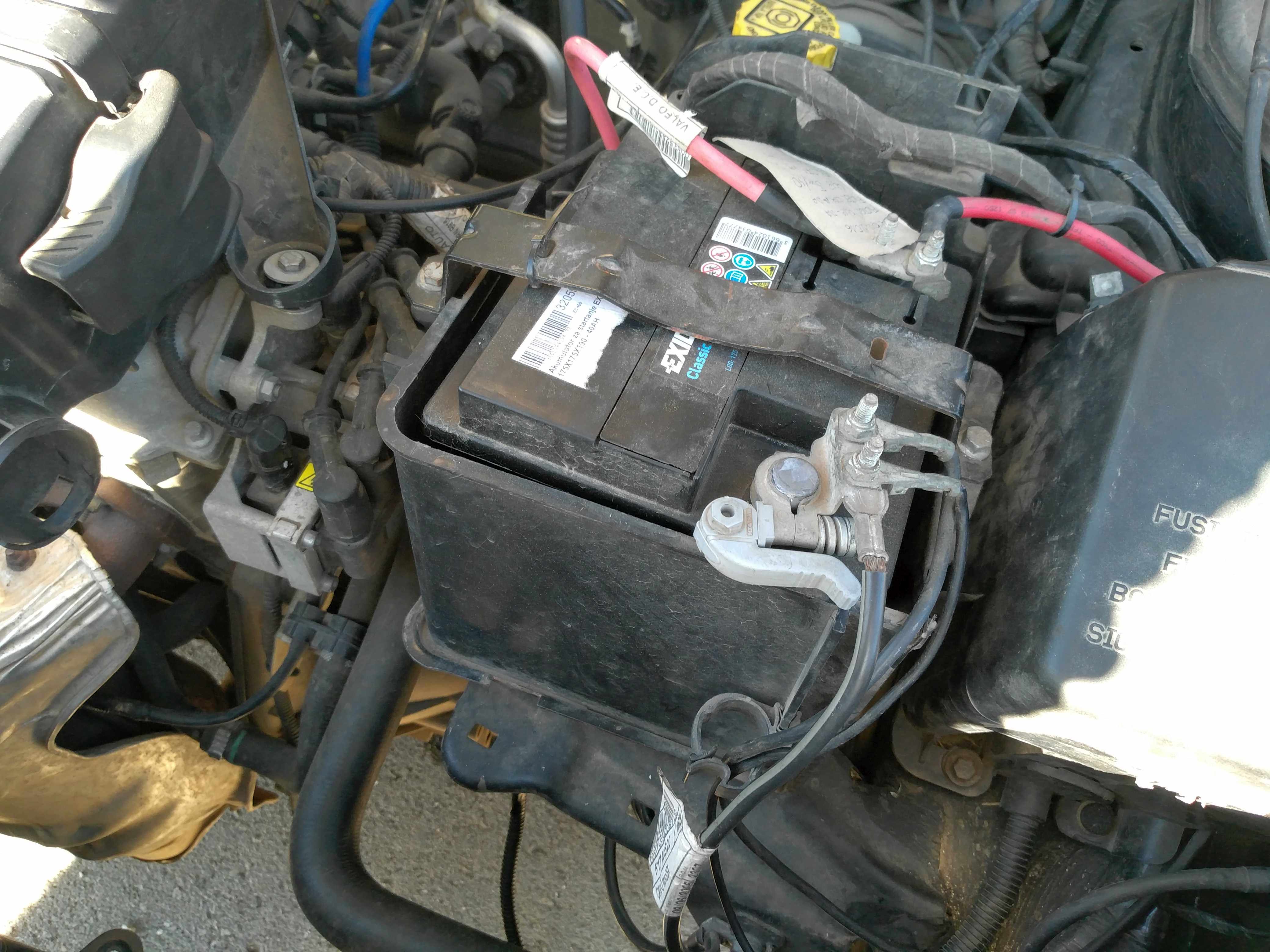

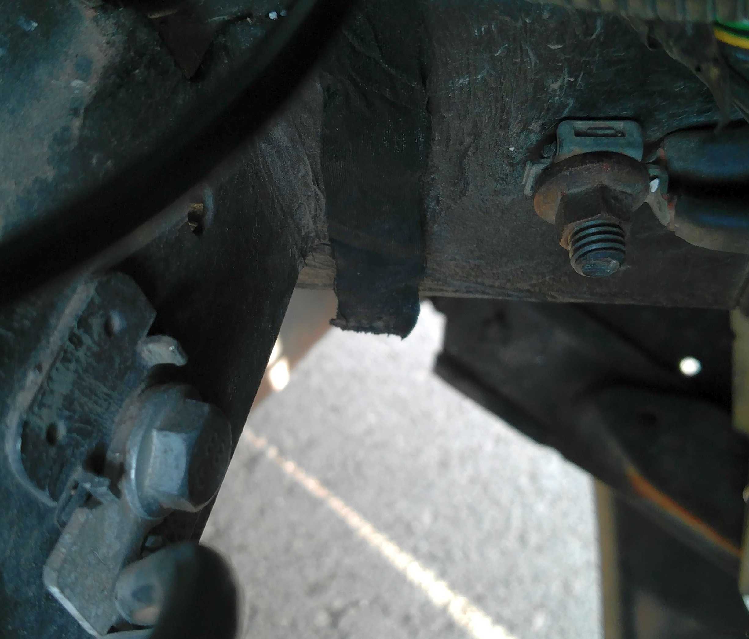

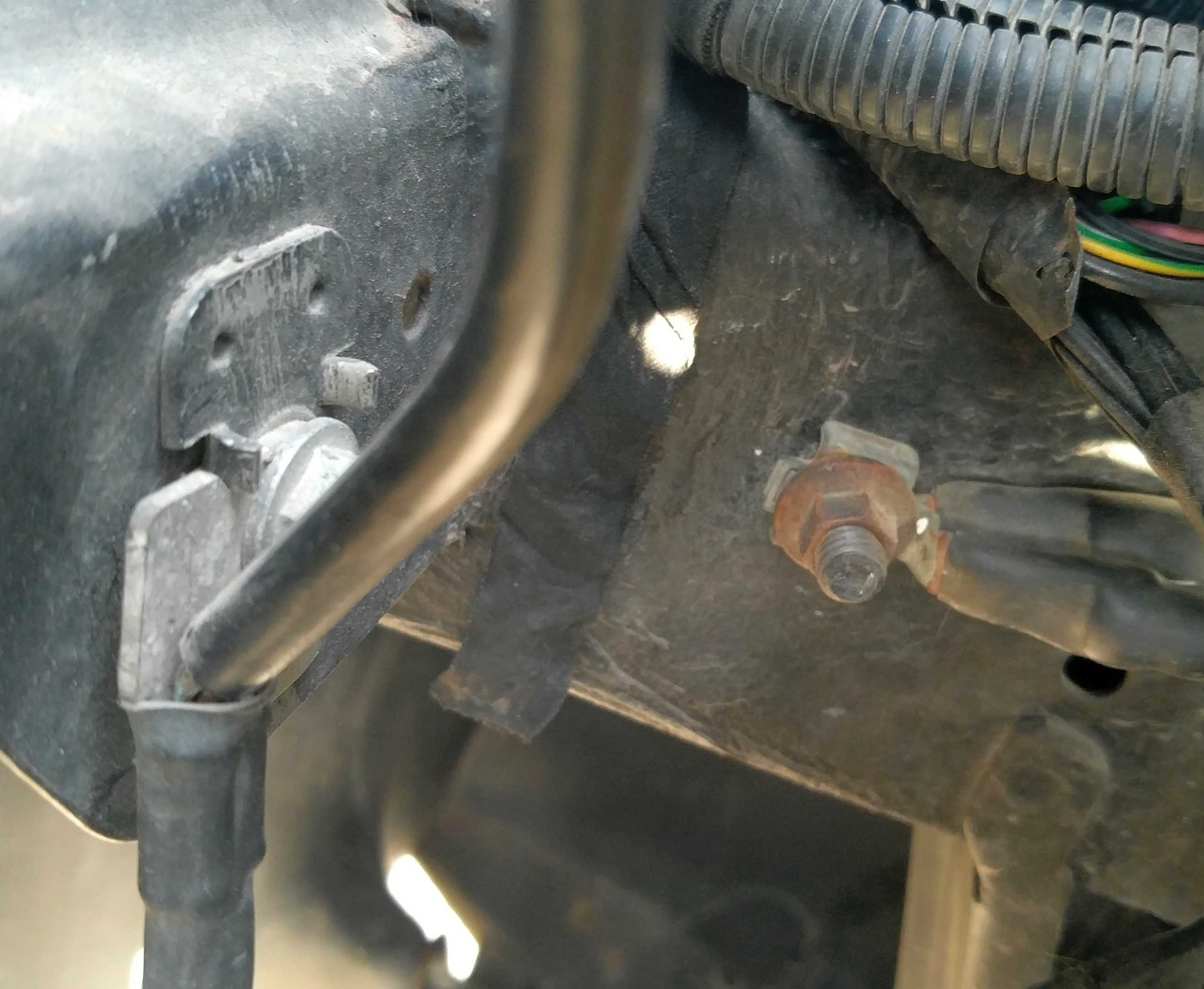

judderbar, near the battery I have two earths, but I can't see the playing card shaped box. On previous images you can see this "main" earth, to which the negative of the battery and the gearbox (as far as I understand) are connected. This connection looks solid to me. Close to that spot, there is another grounding connection where thinner cables are connected. This connection does not look that solid and it appears to be connected to an area which has been painted over. To the right is this ground of questionable quality. I'd love getting some advice on how to improve that.

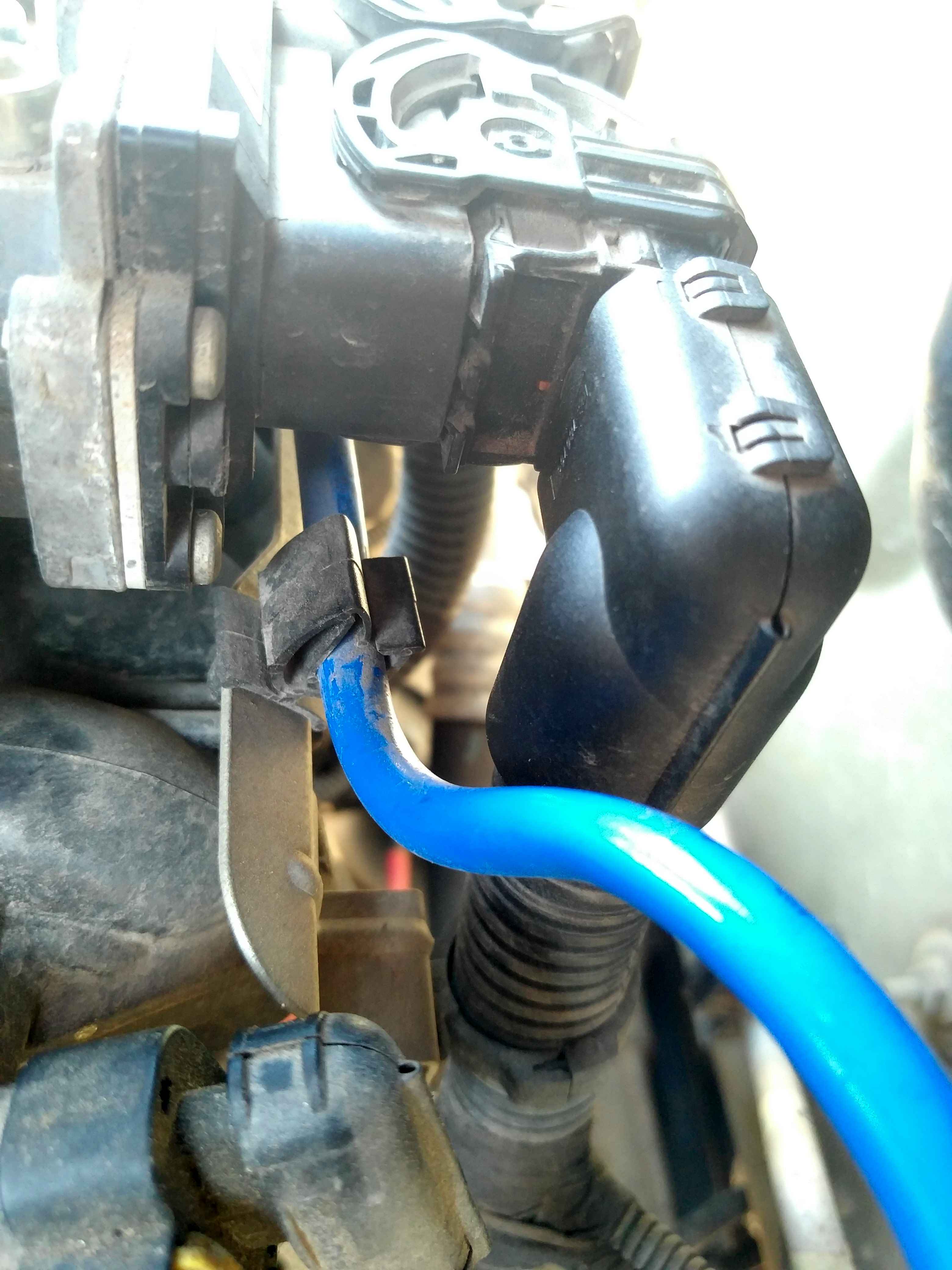

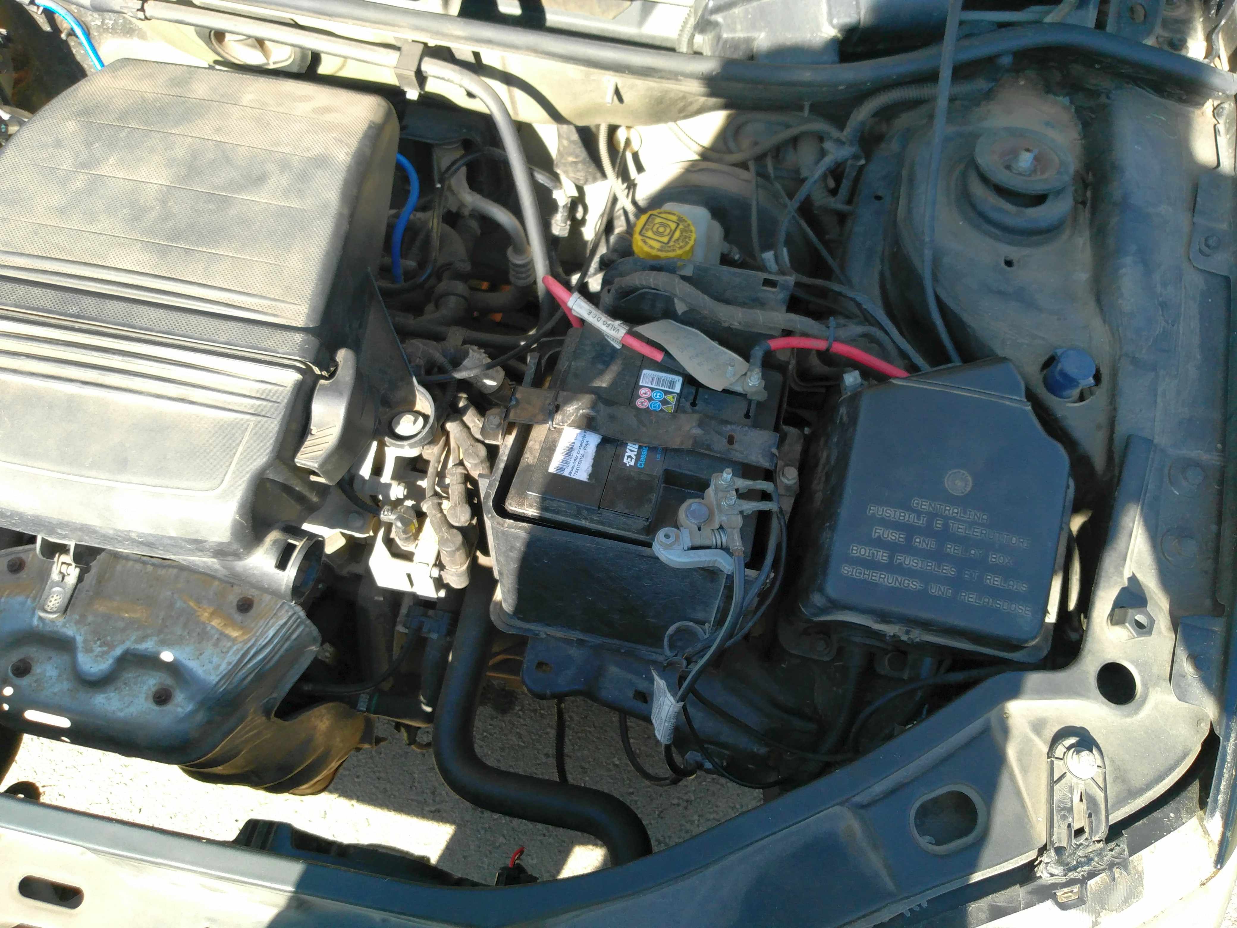

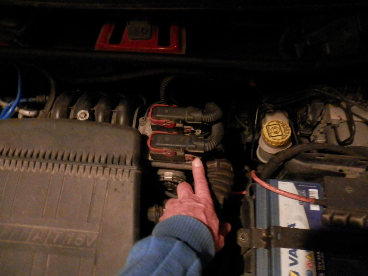

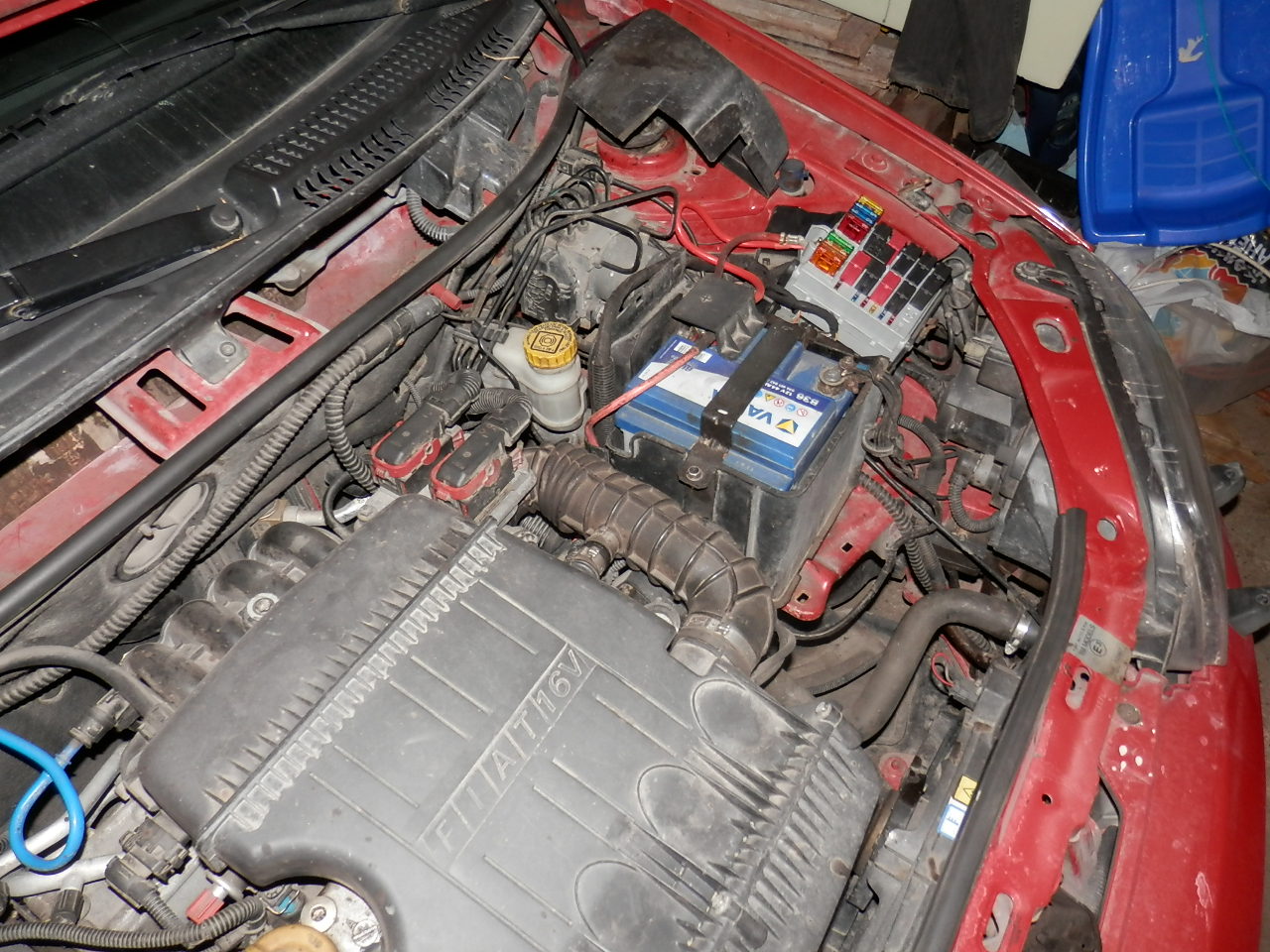

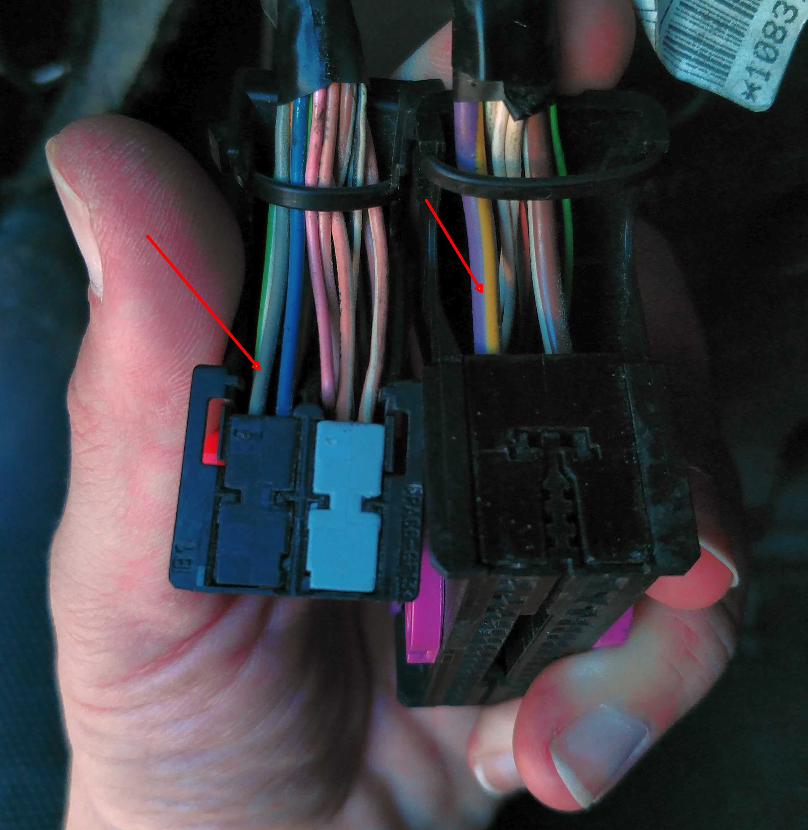

in your second picture there is a bundle of small black wires. Without looking at my car I am guessing these are the earth wires connected to that 'playing card' shaped block. I can check this tomorrow.

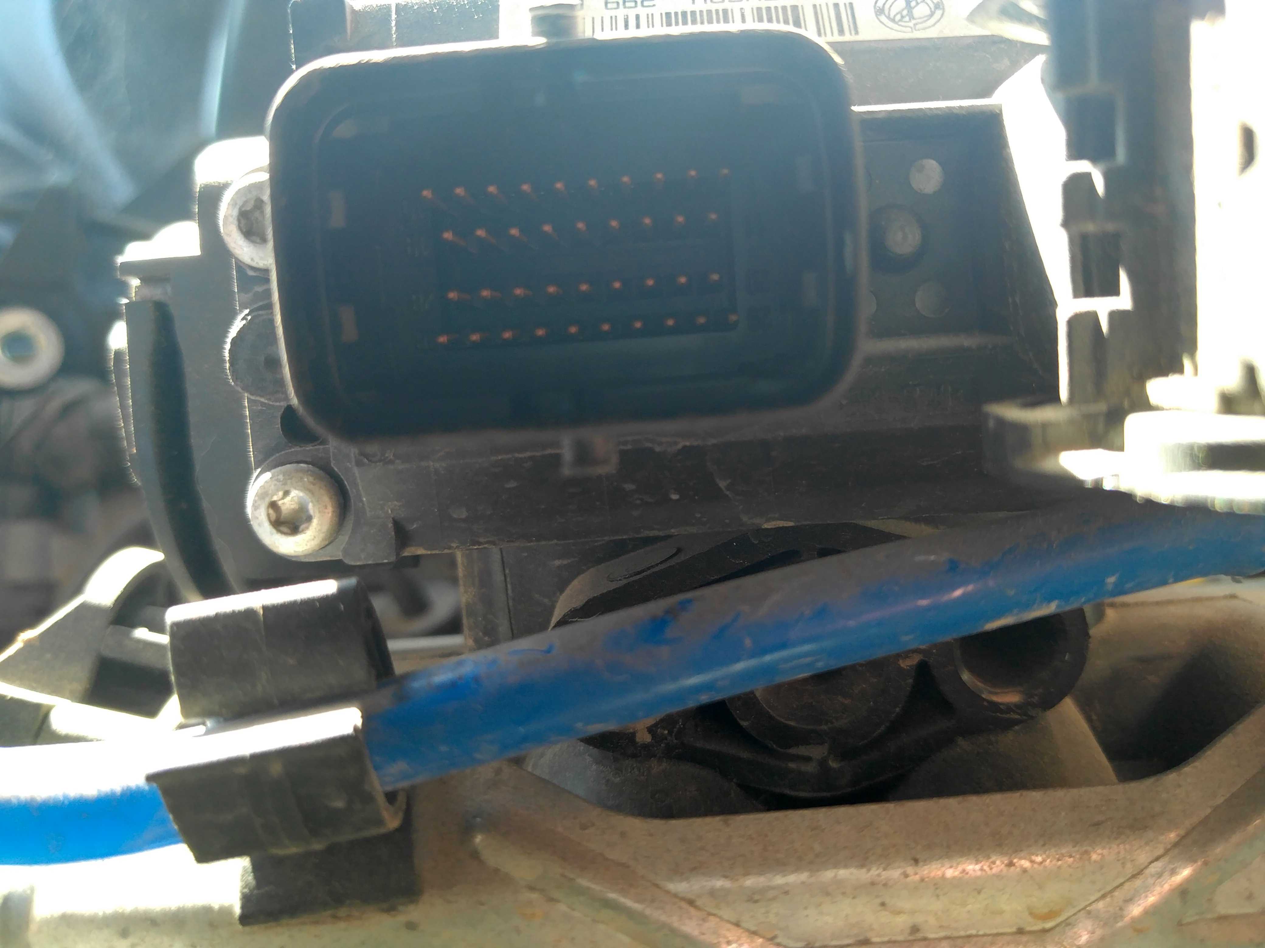

The engine ECU is not hard to find. Follow the path of the air and you will find in one location there is a metal thing with two electrical plugs and thick bundles of wires. It is to the right of the air intake manifold .
I don't have a block, that bit of metal plate seems to have been welded on and painted, that part of the car supposedly suffered the most in the crash. Please, do check, I can use more information.

Are you saying the top left red relay is turning on the pump? I didn't want to fiddle with this on my own since I didn't know which relay does what exactly.

3. Given the crash damage it seems possible there is a problem with the multi earth box I have put my finger on next to the lights. The wiring is possibly perfectly fine and it just needs the single earth of the earthing box connected to the metal of the car via the bolt to be in working order

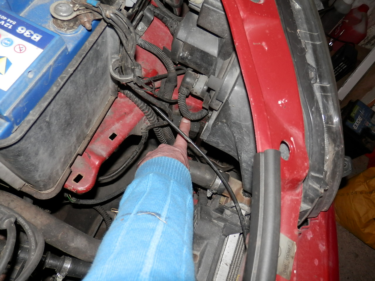

4. I have my finger on the earth of the engine ECU which has the two plugs and thick bundles of wiring. That earth needs to be in good condition.

3. I don't have that earth box. As I have shown with a picture before, it's just a bolt and two bundles of wires connected together. Maybe this car model doesn't have such earth box or it was removed during the "repair."

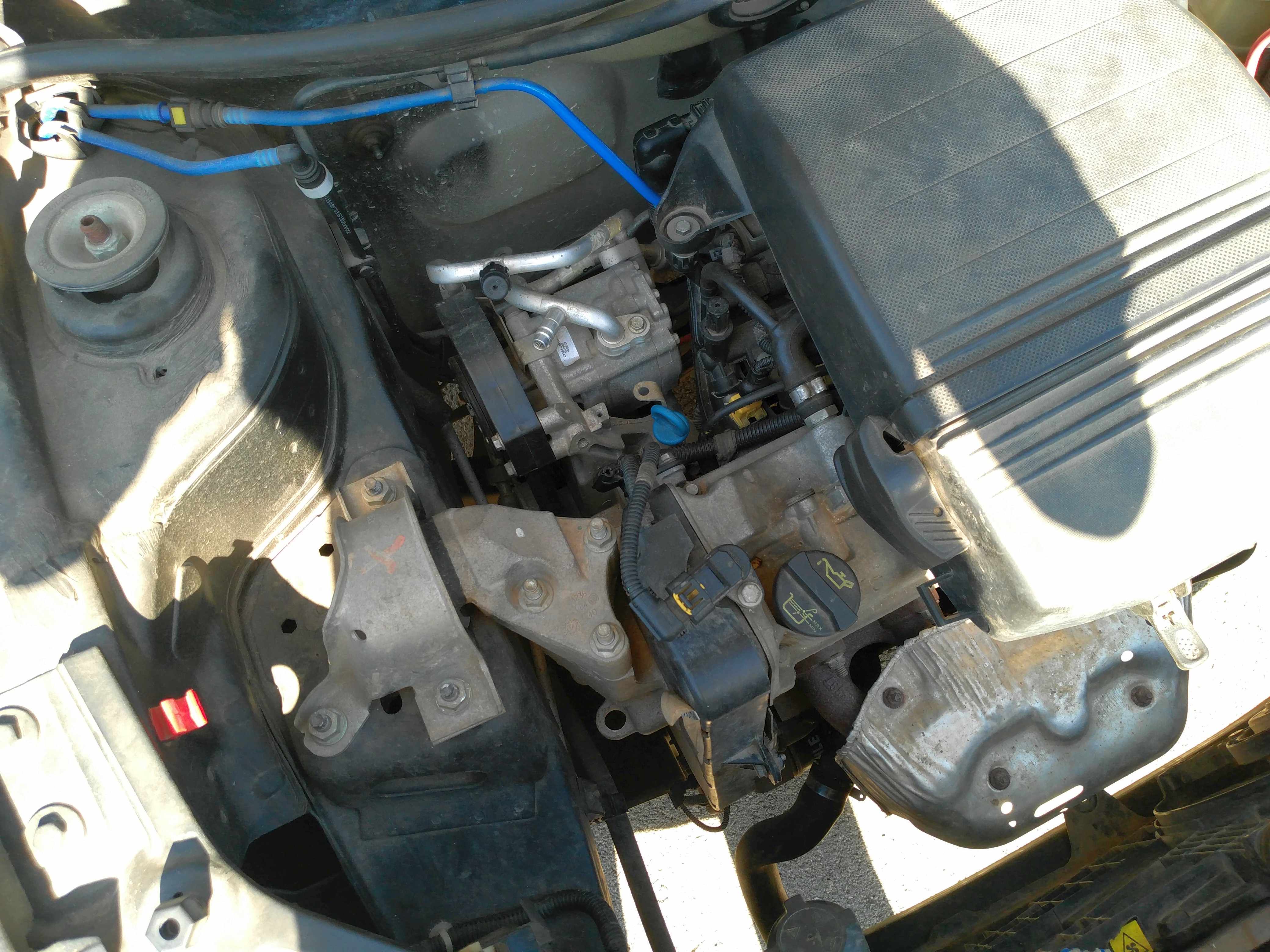

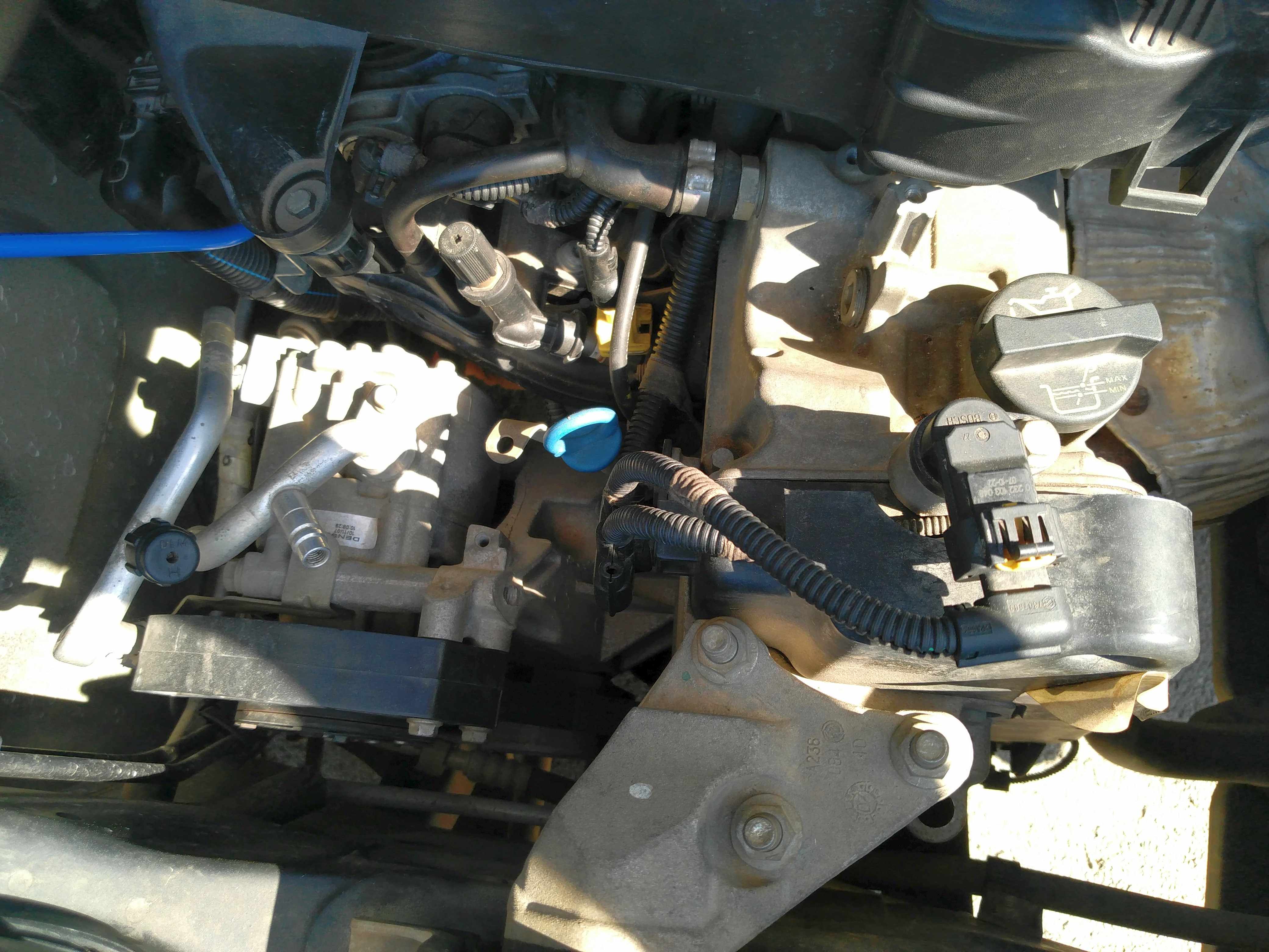

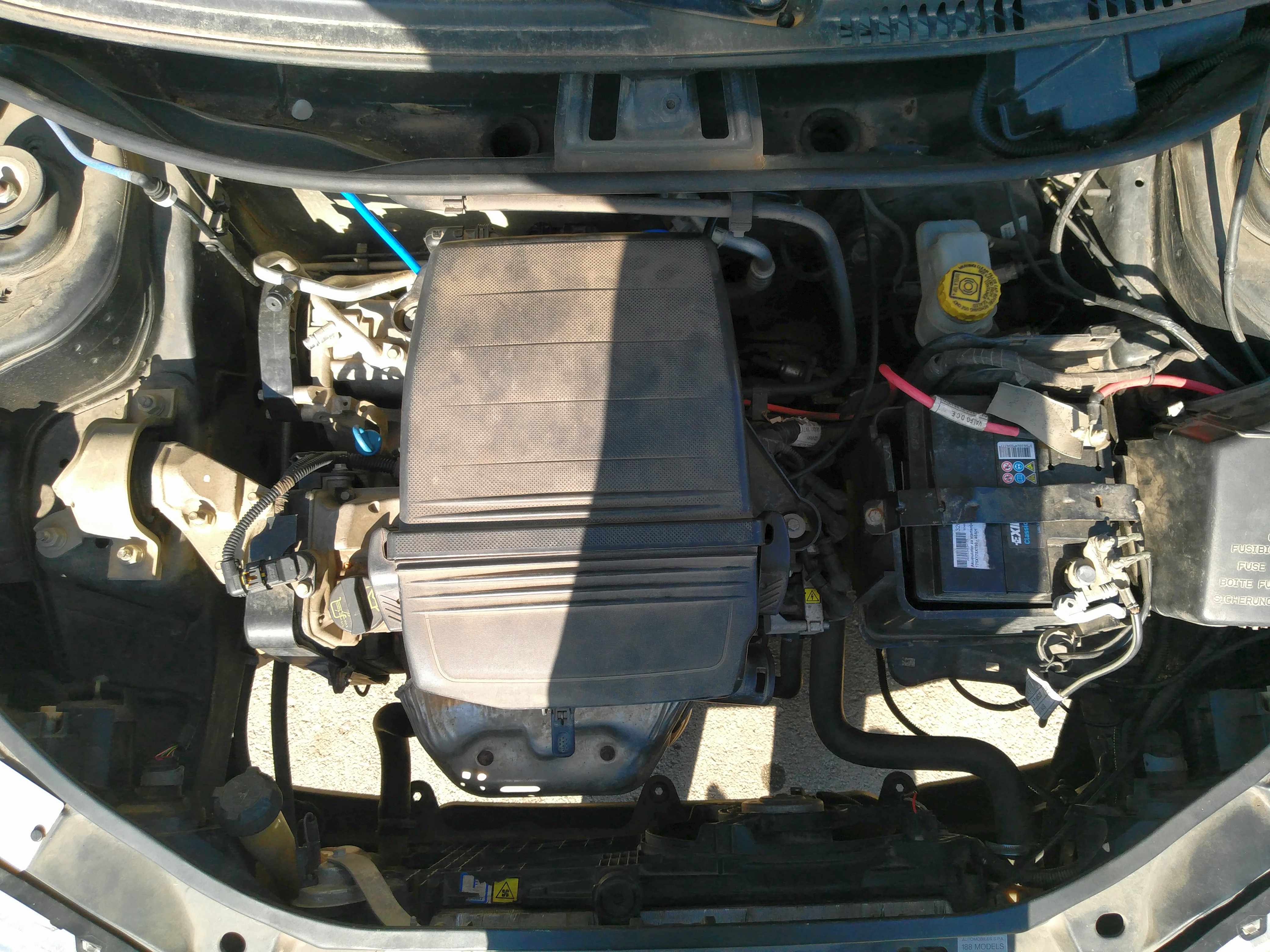

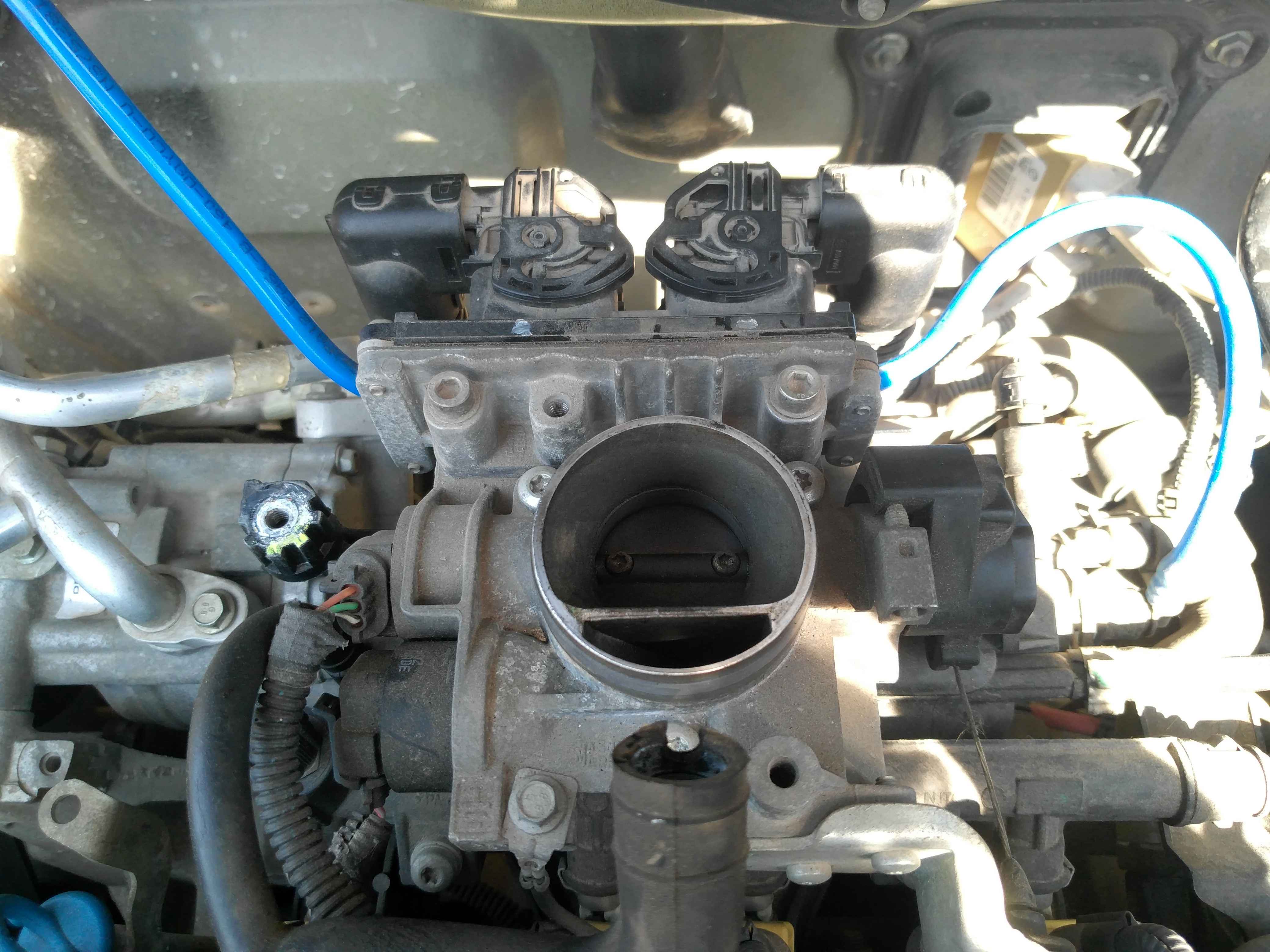

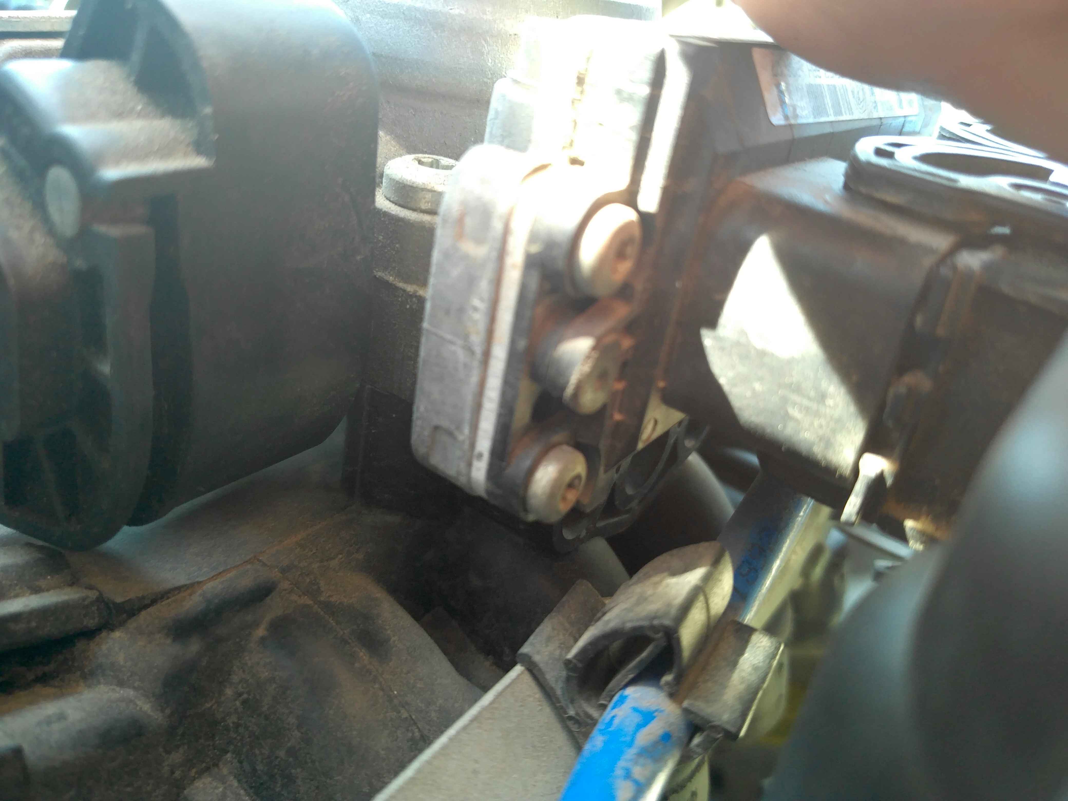

OK, I found the ECU, it's behind the air intake, toward the cockpit. I'm not sure what I'm supposed to check there. I removed one of the connectors, it looks clean and really solid. I'm not certain where's the ground connection on the ECU, but I guess it's the whole surface which is tightened down with a number of screws. It's a really inaccessible location.
I removed that red relay on the right and the pump went on working without it. So, as my brother pointed it out, I looked at the schematic on inner side of the relay box cover and there it states that red relay controls the heater fan.
Here http://fusesdiagram.com/fiat/fuses-and-relay-fiat-punto-2.html it states that the fuel pump relay is a black relay on the left side, however I don't have that one. So I'm assuming that's meant for diesel engines.
View attachment 190040View attachment 190039
View attachment 190038View attachment 190037

sorry i got that relay wrong. you dont have t10 so you want relay t09 which is the red relay nearest the headlight.

So first up that plate with the earths on looks unpleasant to say the least! I'd clean that up and look hard at the crimping to the eyelet.
If you have found the ECU, the pics you've posted are not it. The pics you've shown are of the throttle body. (The electronic equivalent of a carburettor) A few sensors and actuators there, but no ECU.
Look back at post #28 .
Top right of the four pics is pointing at the ignition ECU. You have one like that somewhere. Then follow the wiring to locate the single earth terminal and check it is clean and secure.
The bottom right of the four pics is a good overview of the engine bay. Let's have a look at yours please.

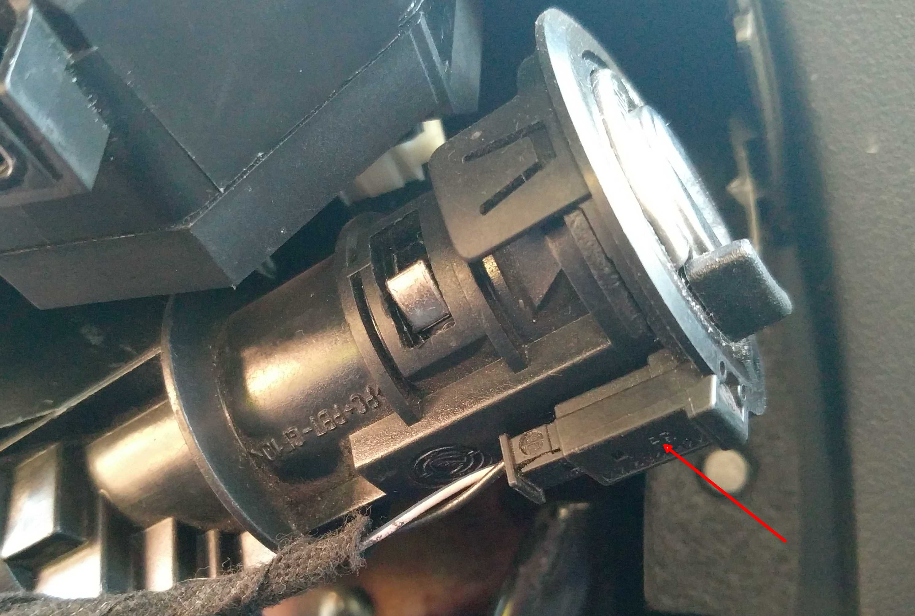

You've found the ignition switch, you could try disconnecting that, and joining the relevant wires together to put ignition on, and start function. (You'll need a wiring diagram). That would make known good connections, and prove whether the actual ignition switch has poor contacts inside. You will need the key in the ignition switch to be read by the immobiliser, and to unlock the steering.
Can this be used reliably? Further, how certain can I be that the immobilizer is working correctly?
