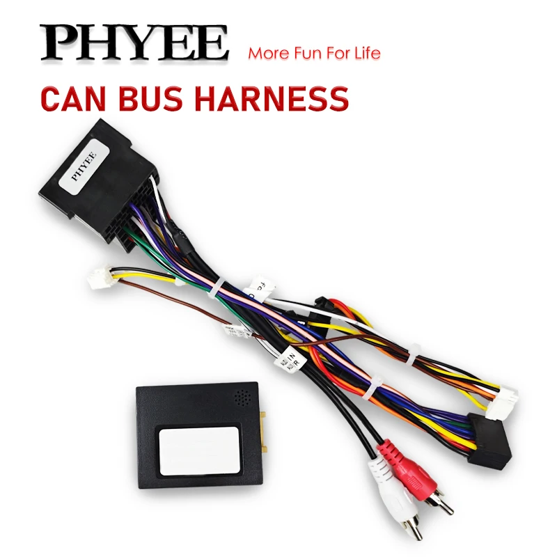

Fiat Canbus adapters are £12-20 including shipping direct from china
I can't recommend any as I haven't used them
The first one i looked at, a review say it worked fine on a fiat 500
Here's another, a quick Google found
Yes you will have to wait a few weeks for it to arrive
Again I haven't used the supplier

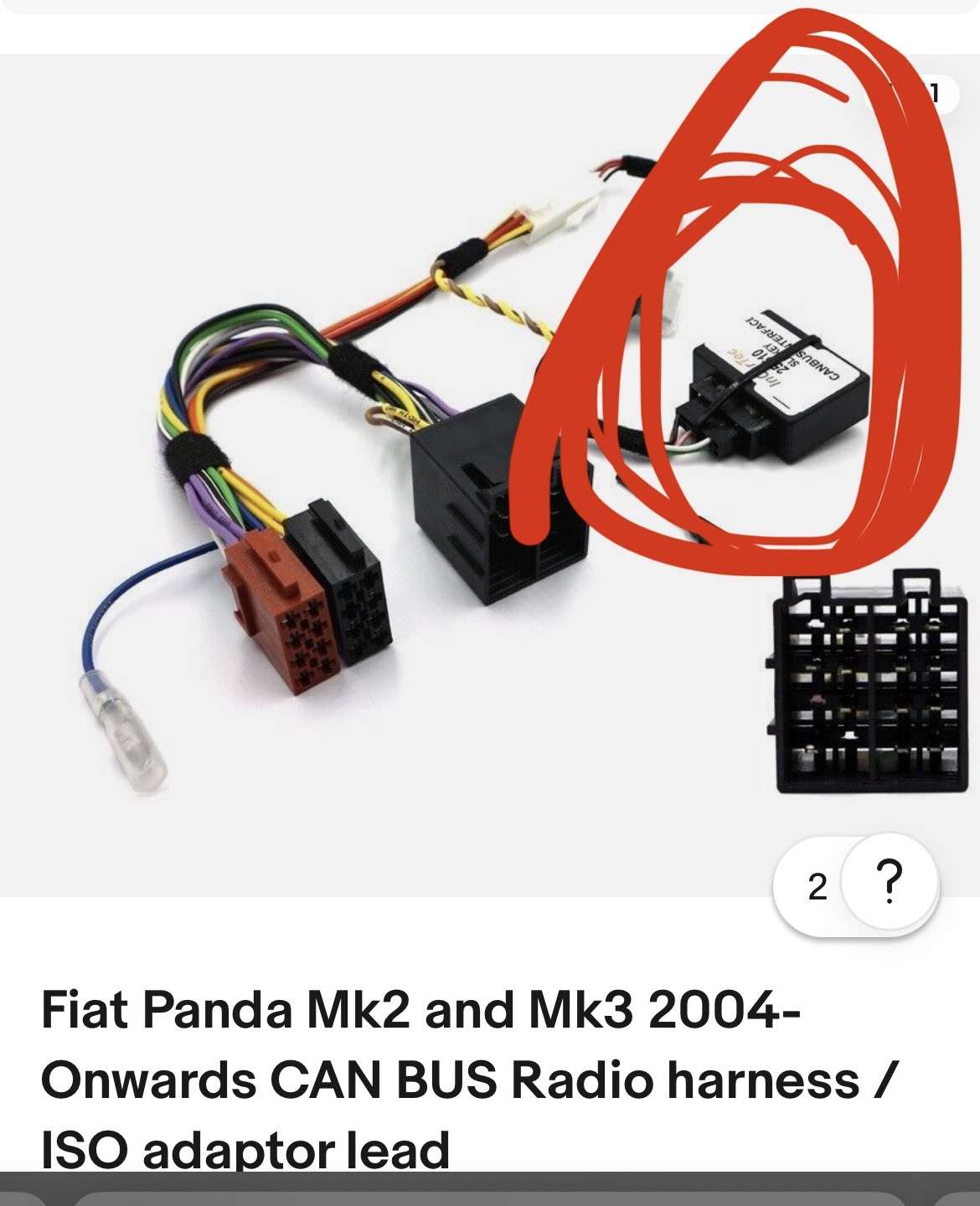

Just to double check — is it this part (circled in red) I need in order to make sure the head unit turns off with the car?
