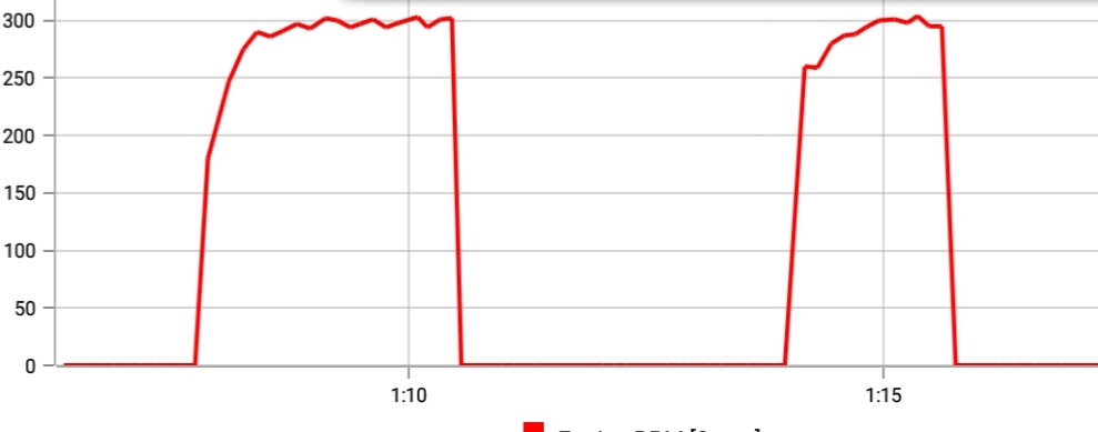

Here's mine, flat battery, cranking fine,
No rev counter until the alternator kicks in
1 more volt lower and the car would not start

If the volts fall below 6V its getting towards the area where the ECU can not maintain the 5V reference needed for the sensors
Here mine falling to just under 9V which is fine
If the volts are fine but the RPM stays at 0 then we are looking at the connection between the ECU and Crank sensor or the already changed sensor

I have checked again this morning.
RPM stays at 0
RPM stays at 0
That great no signal, no spark, injectors never going to start

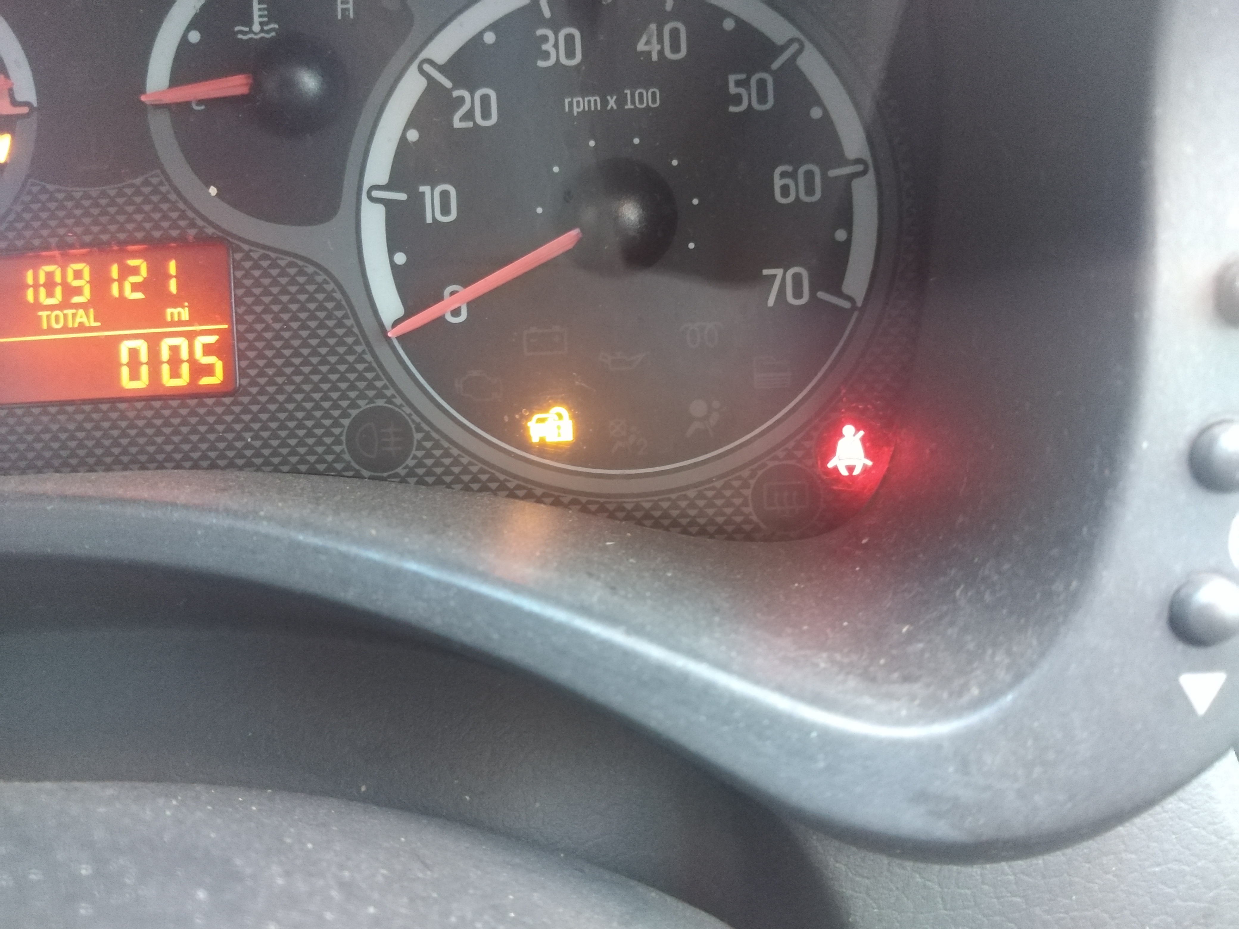

The dash shows only these lights
Is the ABS a new fault
this ABS light is showing since motor stopped working. Might this be the problem? This light stays on when ignition is on and cranking. does not go off
Happened at the same time, have to think about this, the ABS is self contained, it checks itself at start up and if everything is okay it switches the dash light off via a command sent via the canbus to the body computer (BSI)

They both use the BSI and dash. But the main connection between the ECU and ABS is the power and grounds?
