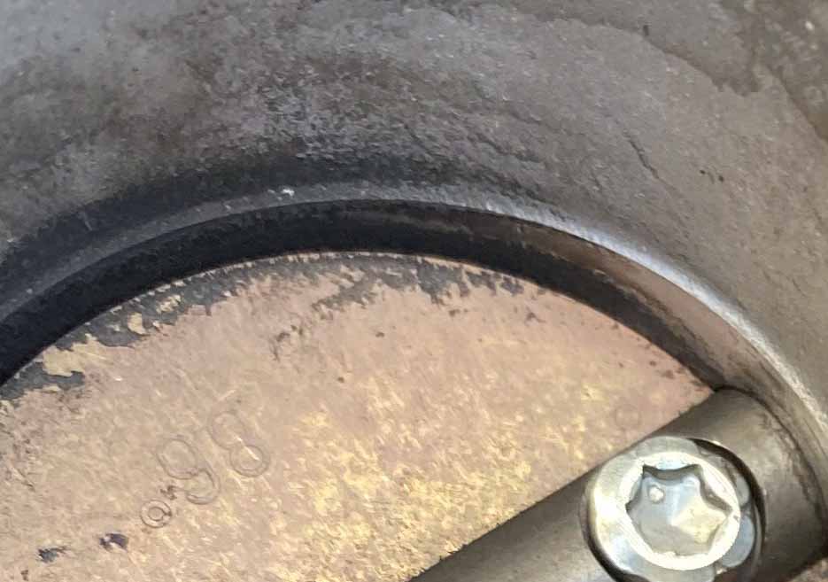

Can you post a pic of throttle body please
Found throttle body tge pioe is cracked both ends

Cleaned the throttle body wrapped pipe with tape . Charged battery up . We’ve disconnected throttle sensor and it ticks over. When we put sensor back on cuts out 😱
cheers for the photos. Look like its pretty clean
any pipe thats above the throttle body thats letting in air will not effect the running at all
in fact both the 1.1 and 1.2 run fine with the airbox removed.
if you listen to the exhaust pipe at the back can you hear any slight miss
The mechanic did suggest blocked exhaust . Can there be anything structurally wrong with the throttle body as it looks ok and flap working from t looks basic . If it ticks over fine with the throttle sensor taken off could it be the sensor . We will go back out and try the exhaust . It’s exhausting us lol

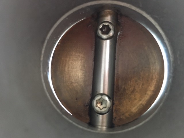

check, there should be an air gap here, photo two is mine held up to the light. Its not that obvious from the top
