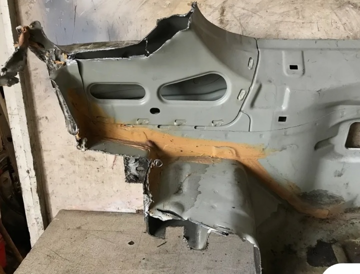

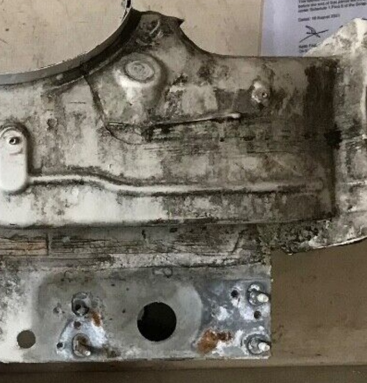

Can someone explain what happens when water enters between the crack (Circle in the photo). Water gets in here when its raining flowing from top to bottom behind the tail light. I intend to seal this part, but I'm uncertain of its effectiveness or what will happen. My car is leaking water from both sides at the bottom, leading me to believe the leak may originate from this area.
You have any clue? Where there others parts you’ve sealed with silicone?
Nope. It was only the seal I applied sealant to. Water leaks can be the very devil to sort out. I've known experienced coachworks spend hours on them - noone likes sorting this sort of stuff out. Good luck.
