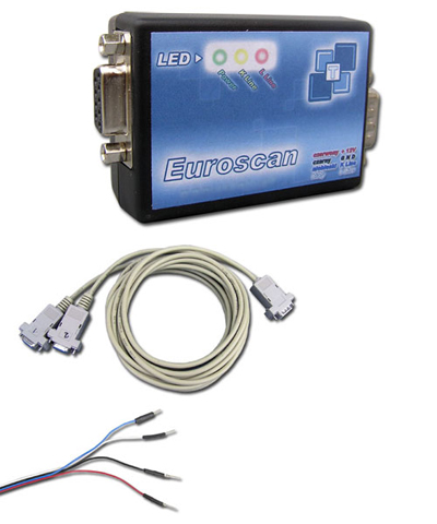

So you say that this interface is compatible with some programms and only needs to short together the K and L line. My brava 1999 80 16V uses only the K-line and i tried the Uniscan Visa 1.83 Interface and reads and erase faults also, but it works only in DOS and uses two com ports, so you must have an old PC to use it. I attach a picture for what interface i am talking about. If anyone wants any further info for that interface feel free to ask me.

Well yes, but there is dumb interfaces, which just do the level shifting and all the intelligence is in the PC, or there is intelligent interface such as elm etc, which have some preset routines in them and follow commands from the PC.

Docorangepeel yes it works only in DOS but i have a very old laptop for this only job which has two com ports and it works fine. Jug the Uniscan dont work under command prompt, needs a pure DOS version to work, what can i say!!!!:shrug:
