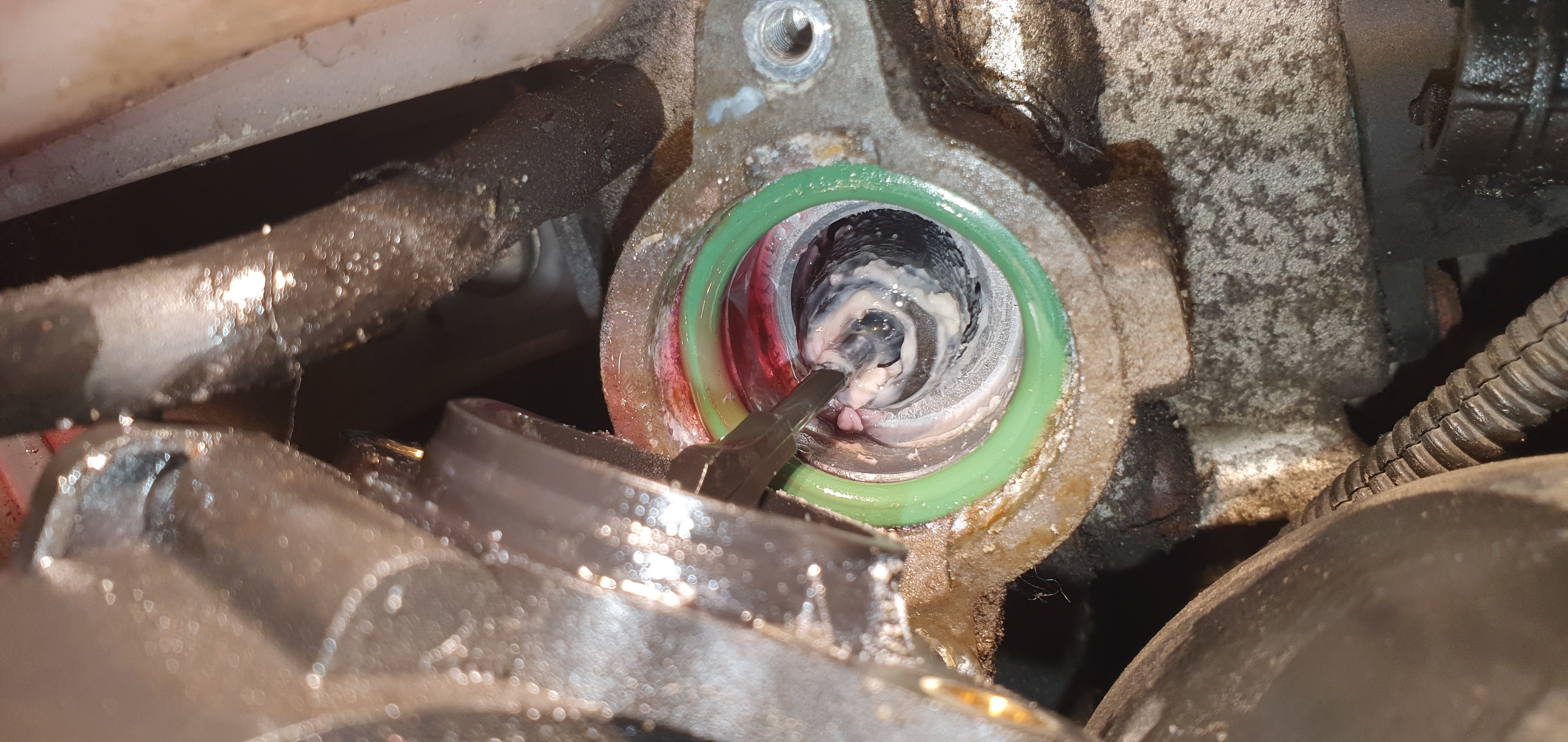

That leak doesn't look promising. It could be that a seal popped when the clutch plate let go.

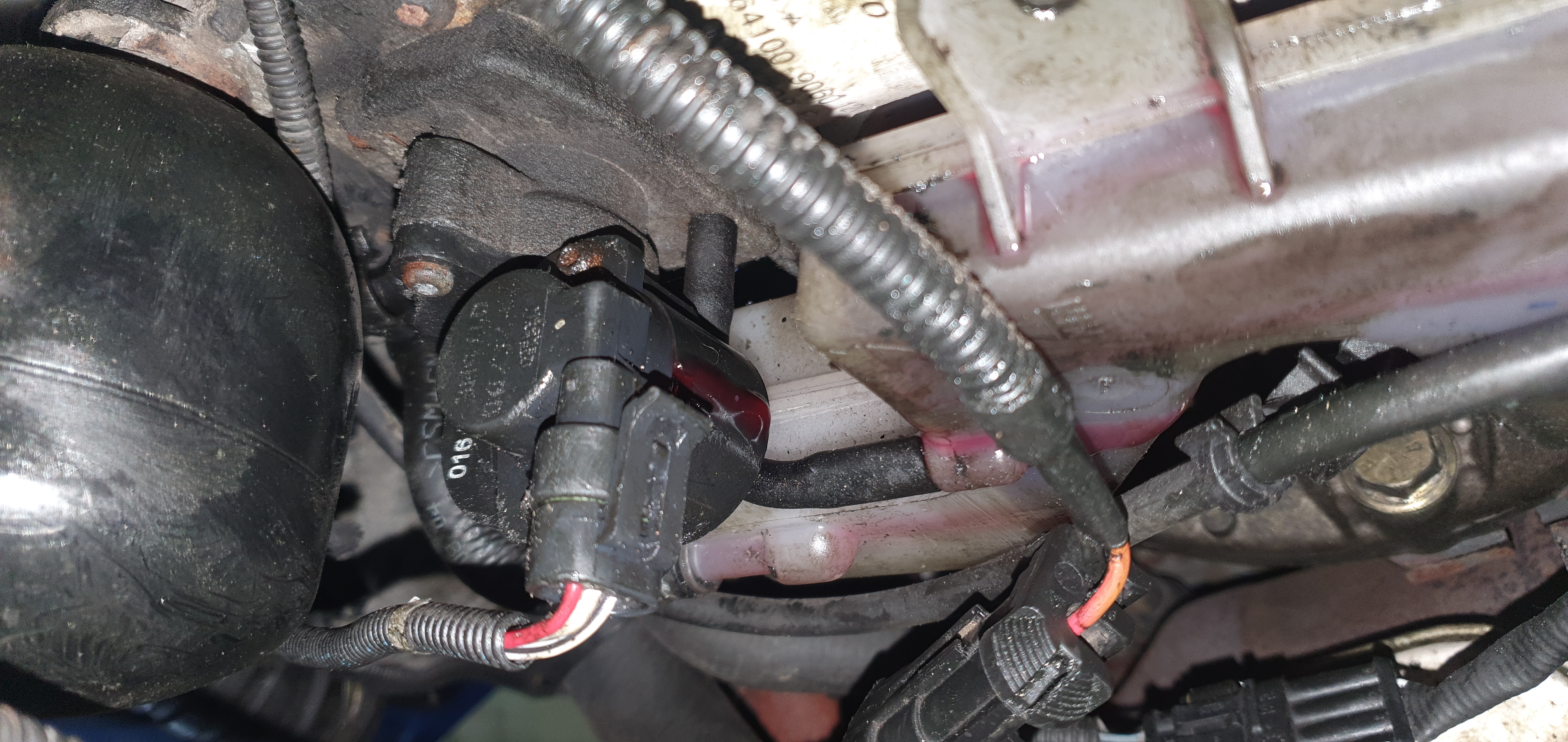

Ffs just noticed the thrust pin is not seated in the thrust arm cup.....
Both are stiff obviously gearbox side will be from pressure of pressure plate..any easy way of getting the pin back in the cup without taking it all apart again....
Was the leak definitely not present before the clutch change? (Even a damp spot?)

Now come to mention it. I did do a flush and replacement of the fluid. And had to top up again before I investigated the clutch route...
So yeah I'd say yes it was leaking prior.

Can't see a way of avoiding box out again though to fix the pin.
And there's still the leak...
