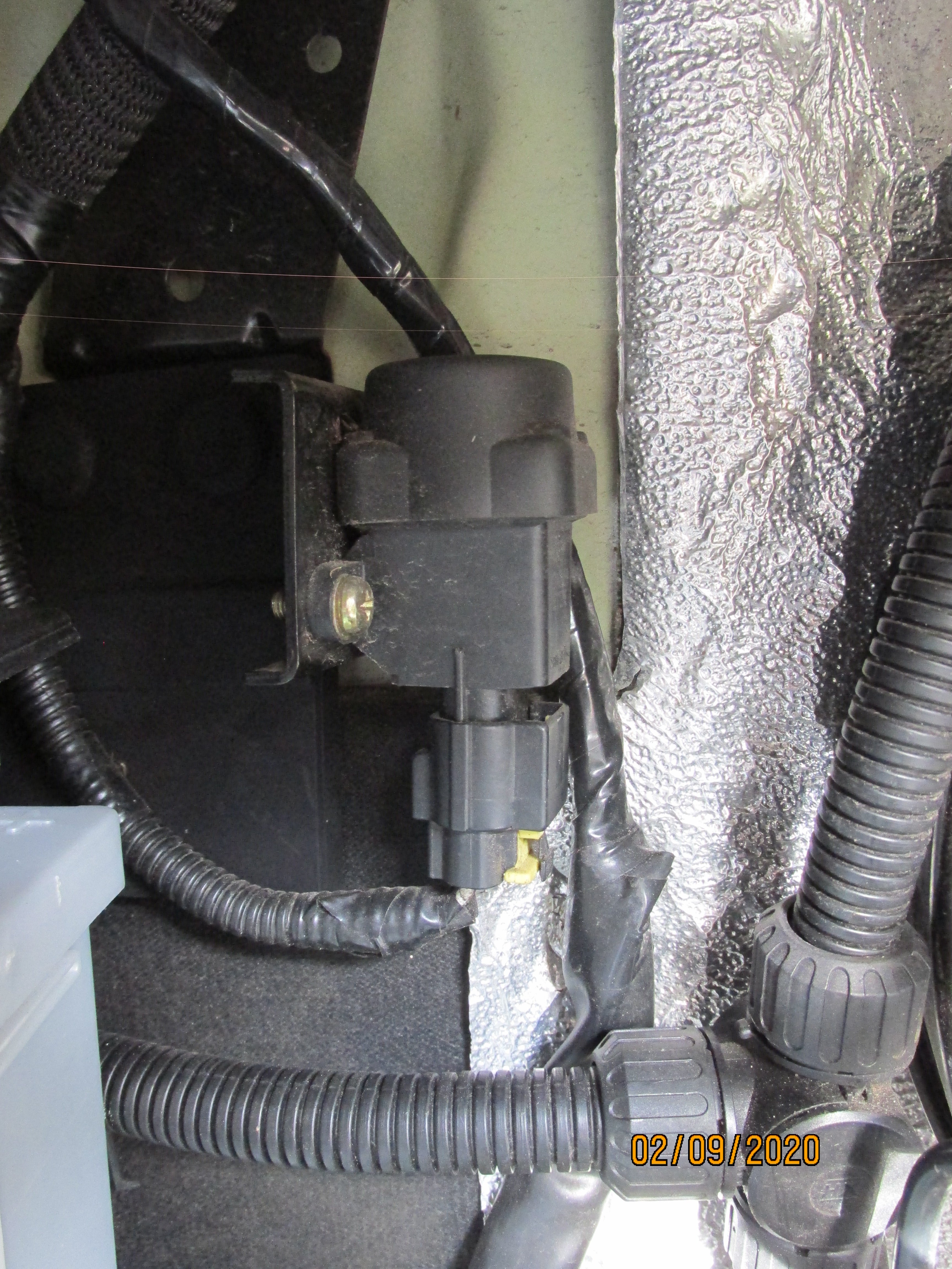

I too am pleased at the successful resolution, but like @jackwhoo I am curious as to the fuel cut off switch. My x244 2.8jtd in common with most later models has an inertia switch, which is intended to interupt the supply to the electric pump in the fuel tank. @Yorkysteve 's 2.8idTD does not have an electric lift pump. Is the fuel cut off "switch" included in the stop solenoid supply?
Attached is picture of fuel cut off inertia switch on my 2.8jtd, which is mounted at the rear of the engine bay.

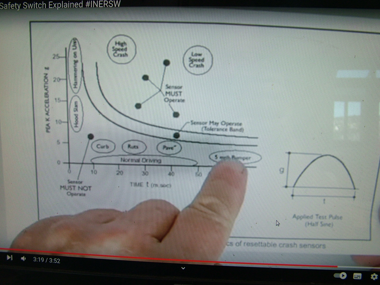

Glad it is running now, but it seems strange that vehicle drove in to be left for the Winter and then wouldn't restart because of an inertia device.
I found a uTube video which showed the conditions to activate an inertia/cut off switch under normal conditions, so unless you parked it at the bottom of a cliff, it shouldn't activate.;););)
